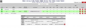

but when i try to connect to any channel from this 19,2 E - Sky DE • icam :: streamrelay :: get black screen.
I make mistake somewhere, but can you write me where, here or on PM.
It's simple when you go into openwebif and check your readers if the icam is off line your provider will not support the icam configuration
