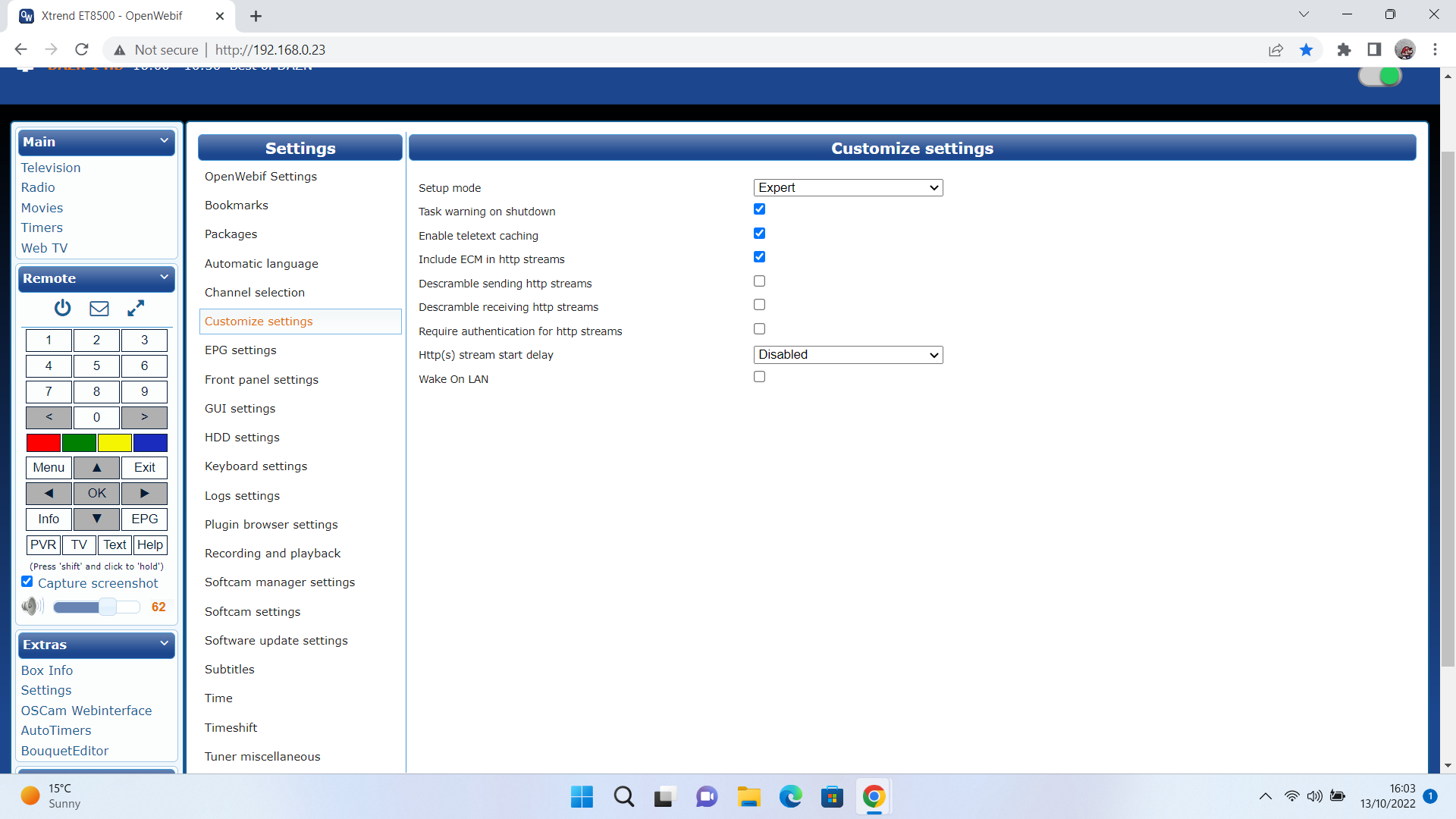

Configuring Emigma2 parameters
You need to properly configure Enigma2’s advanced options. This can be done using the remote control in the receiver settings or via the emigma2 web interface.
In different firmware, the menu item is called differently. For example, in OpenATV 7.0 you need to go to Menu -> Setup -> Usage & GUI -> Customize System Settings section.
In my case (OpenBH) it is MENU -> Setup -> System -> Customise
The following parameters must be set:
Include ECM in http streams –YES
Descramble sending http streams – NO
Descramble receiving http streams – NO
Require authentication for http streams – NO
Or by Web interface:
