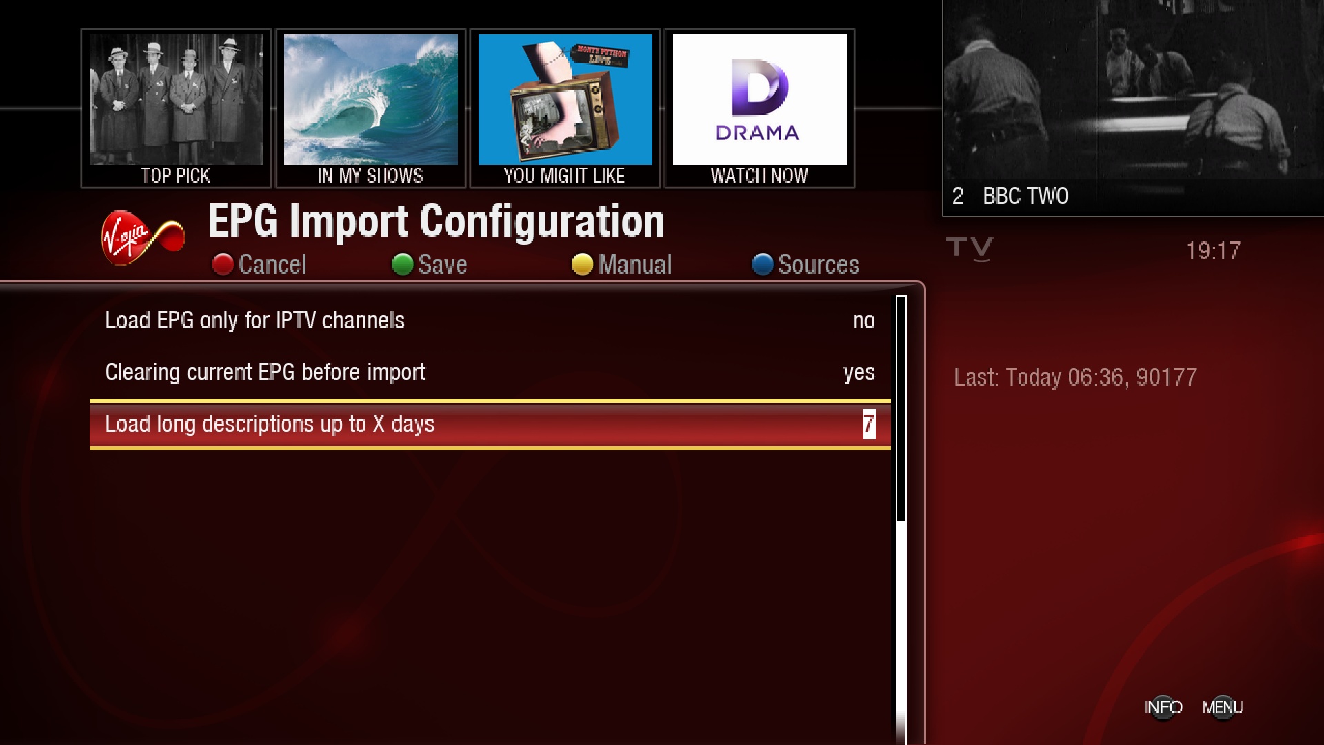

when you open epgimporter, how many days have you got it set to download? - bottom setting on the menu:
@pabloescaban
It is set at 7 days. Just changed to 8 and it is still the same. I also changed it to clear EPG before import and it's still the same. It only downloads up to Sunday.
