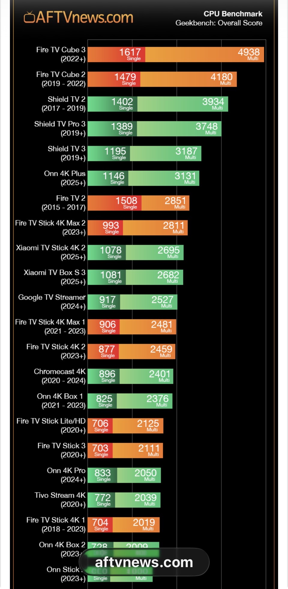

The plus has a faster cpu than the pro. I dont know if the extra ram on the pro will level them out tho.
Plus does have better benchmark scores.
Hello Aristotle - I remember buying my firecube 3rd gen 4K, mainly on the back of this chart, and also supported Now TV Sky Sports in 4K (my beloved Shield didn't which I still miss now)
