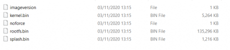

Edit: Just to add some more info, when i downloaded the open atv i unzipped it and all these following files (pic attached) i put on the usb stick
Have you tried to rename the file called "noforce" to "force"?
Have you tried to flash by command line? Issue an "init 4" command to stop it bootlooping. You must have a storage device connected for that to work.
Just to add, you are supposed to put the entire Zgemma folder on the USB, not the individual files pictured above.
If it doesn't flash you may need to format the USB first (FAT32) then put the zgemma folder on it
Thanks for that Pablo, yeah I had to put the whole file on the usb stick, worked perfect.
