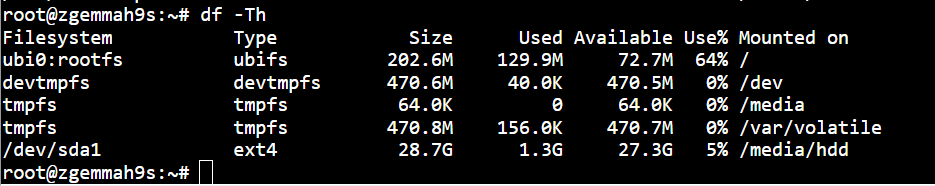

You can also check teh mount points by following command:
df -Th

I just tried flashing with putty, but still getting the same error. The drive is showing as media/hdd and is formatted to ext4. I have used a different usb drive this time. I am willing to try flashing the image by command line if you think that will work, but would I not just be aswell doing a clean install from a usb stick? Then installing it all maually (If somebody tells me what to install)

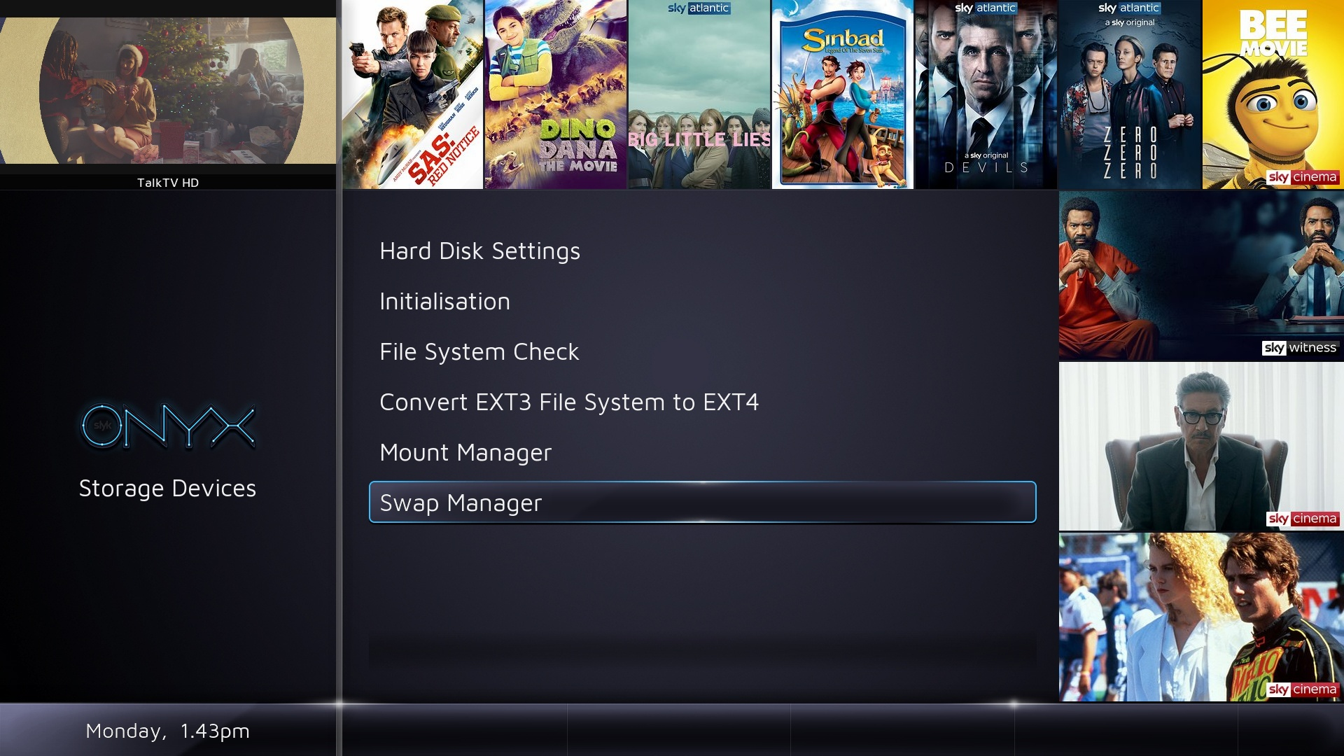

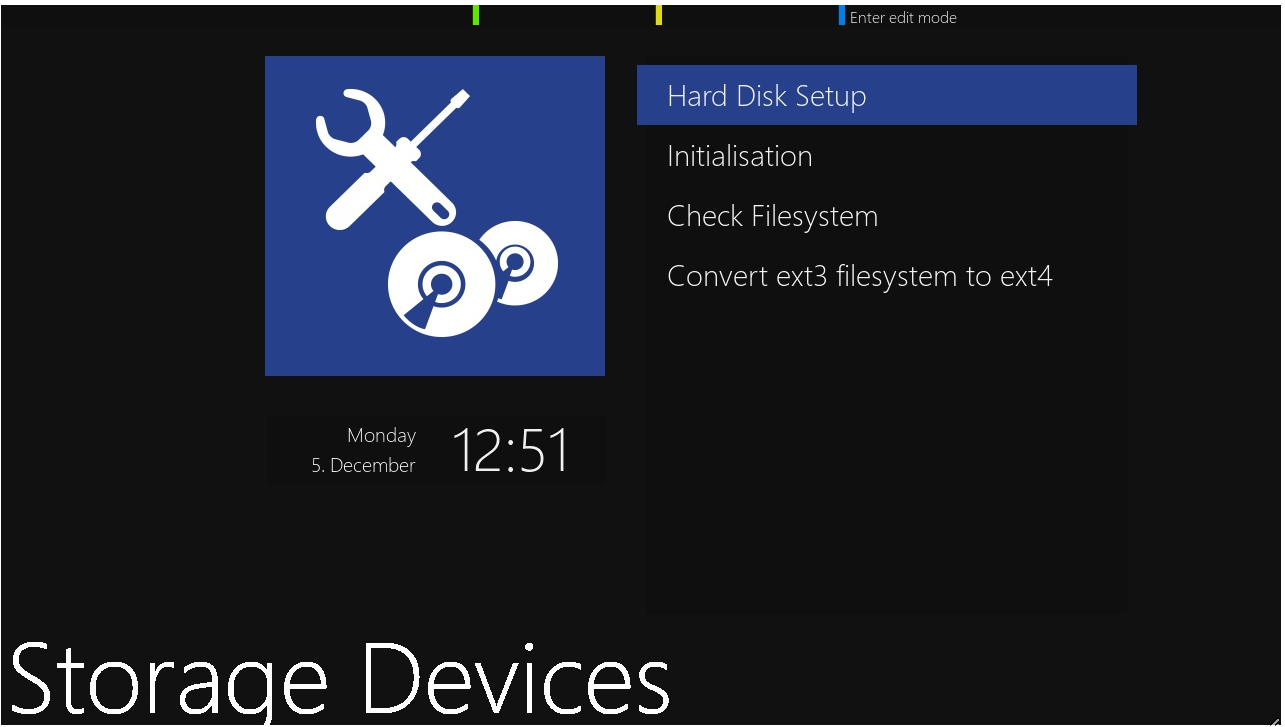

I don't have the mount manager on my menu. I have the screen below. I can see on my box info that it has
I showed you the path to Mount Manager but this is on ATV 7.2. Maybe it's different on 6.4?
MENU > SETUP > SYSTEM > STORAGE DEVICES > MOUNT MANAGER
BLUE > MOUNTS is network mounts.
I'm sure it used to be in Infopanel > Plugins on old versions of ATV but not got it installed on my modern box.
Im not in front of mine but im sure it blue-mounts-device manger.

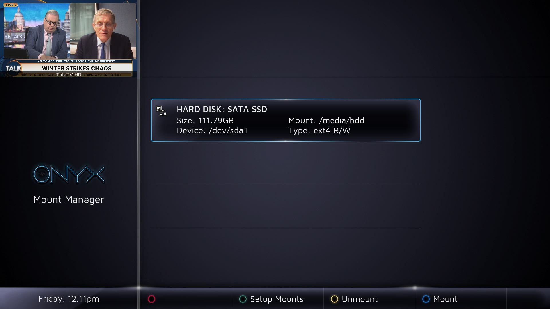

If you look at this pic its mounted correctly anyway

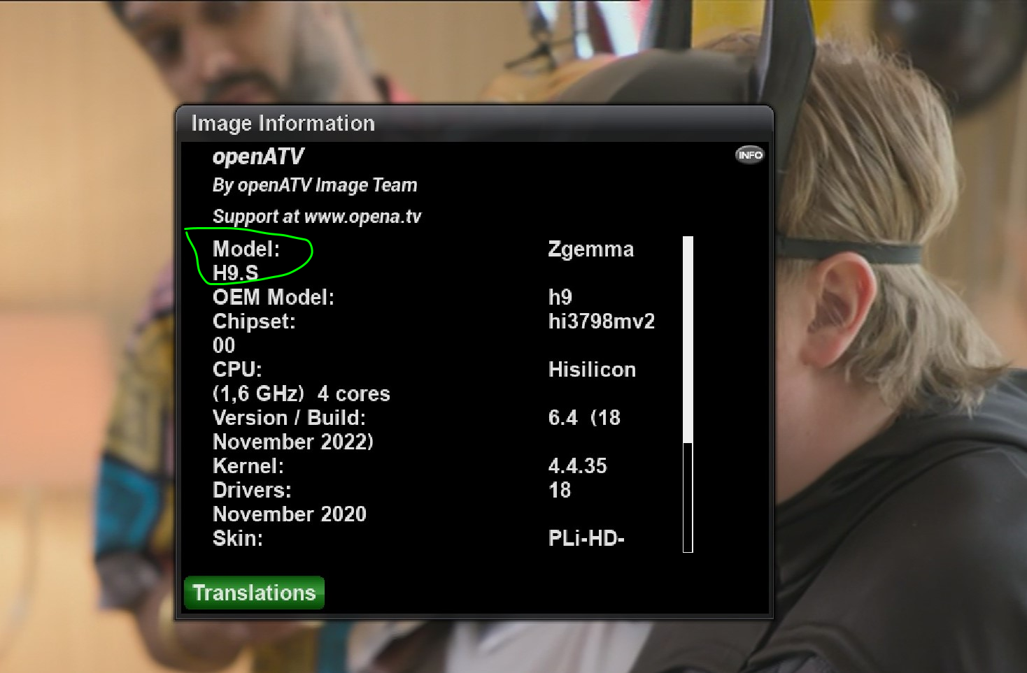

Are you sure you're flashing the right image? Your 'about' screenshot says H9S but you say it's a H9.2S.
I haven't got one so not sure which is the right image?
...... I've got a H9 Twin and that gives me the option to boot to the recovery menu in the standby/shutdown menu.
You could try flashing from there if Abu's method doesn't come off.
View attachment 85205 View attachment 85207

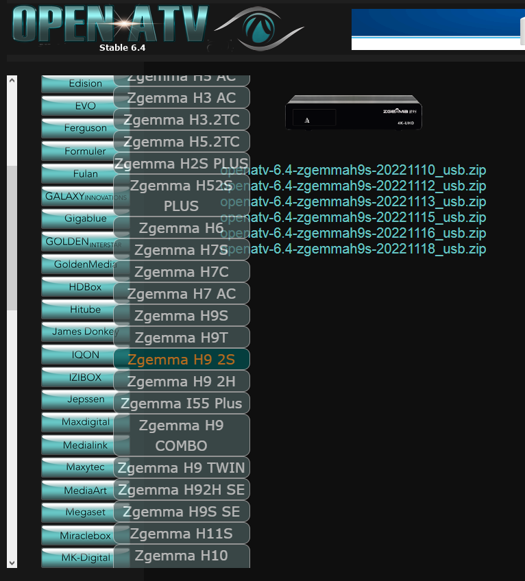

Thanks. I thought you had solved my problem when you spotted the different Model numbers. My box is the H9 2s. I must have flashed the wrong image from my USB drive first time round. I flashed it again with openatv-6.4-zgemmah92s-20221118_usb and I tried to install Grogbuild again. It still had the same error.
That's what I'm getting at. Does your box now 'think' it's a H9S because the wrong firmware has been flashed in the past?
I've no idea how cross-compatible the different H9 versions are.
I know that back in the day you could flash H2H firmware to the H2S and vice versa without any problem. The only difference was the box-branding.

Mount Manager is definitely in MENU > INFOPANEL > PLUGINS > MOUNT MANAGER

If you initilise any device hdd or USB drive on Openatv it automounts it to media/hdd and it will be formatted to ext4.
His screen shot on this post shows this.
