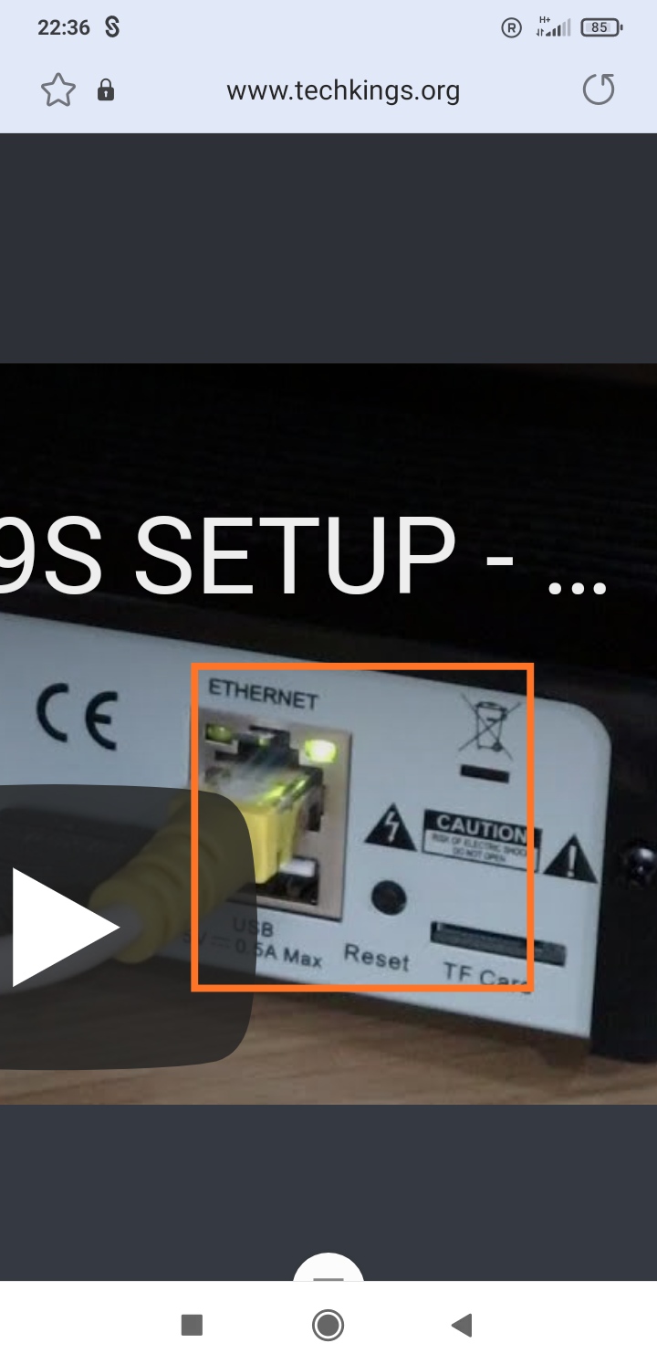

Thank you for reply, but my h9.2s box doesn't have reset button at the front only at the back which is black and white power button also at the back! When I just turn the box on without pressing reset button its showing ATV 7.0 and blue circle spinning but nothing else happens.
I would look again there should be a small reset button on the back as well a power button.
And I think that box is h9s not h9.2s maybe that's why it ain't working.

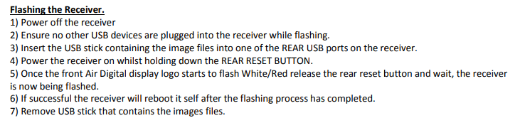

If you have a reset button and you've been doing it according to the tutorials it means the box isn't recognising the USB stick.
Either format it with the util posted above by @Willo3092 or try a new usb, SanDisk are about best and they're available everywhere for a few quid
It makes no difference.

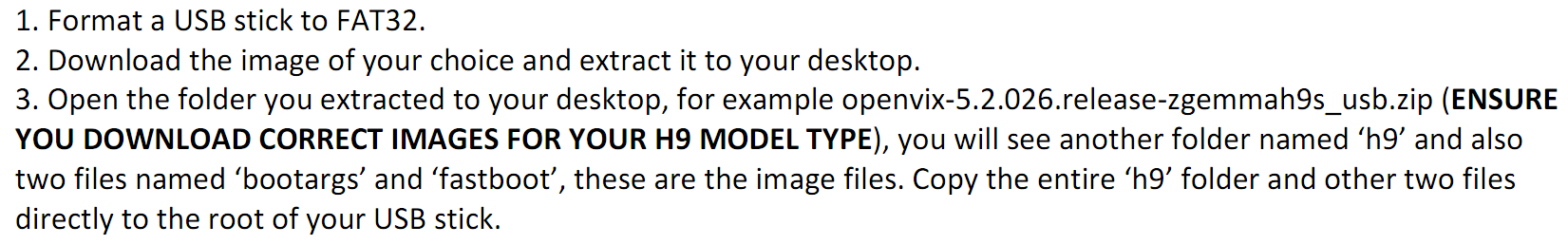

Have you tried using a usb that's 8GB or less,preferably a SanDisk and have you put all the files shown on the video on the usb?6.4.
-send the h9 folder and 2 files (bootargs.bin and fastboot.bin) to the clean USB memory stick.
Omgggggggg, its flashing after usb No 4. Just as @bigwig21 mention about smaller size usb. I tried 2GB didn't work then just put 16GB in and it works. Thank you so much everyone. Now I can abort the xcode that I'm installing on my MAC 😄
