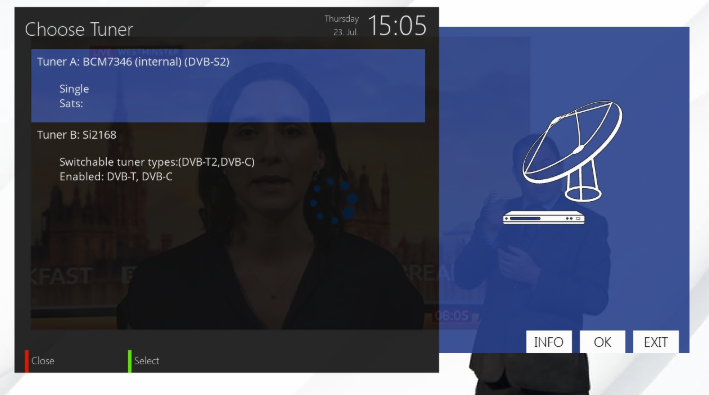

I can only select Hot Bird 13.0E

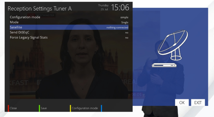

You need to update your satellites.xml file.
A quick google will take you to a site where you can generate one with the configurations you need.
Then download and FTP to your receiver under /etc/enigma2.
Then restart and try again.
All the info is on here so why google anything.

Still dont know what type of dish is being used, if it is just a standard sky dish, then it is most likely pointing to 28.2e, if so then do a scan and see if it brings in channels, then take it from there.

thank you; this was the correct answer; it solved my problem; I am indeed pointed at 28.2E and after updating satellites.xml I was able to do a scan and find some channels

However, setting it to automatic didn’t find anything; I had to guess it was pointed to 28.2e as someone suggested
If I remember correctly this was a satellite used by Sky in the past, am I right; I only see a bunch of asian channels now
