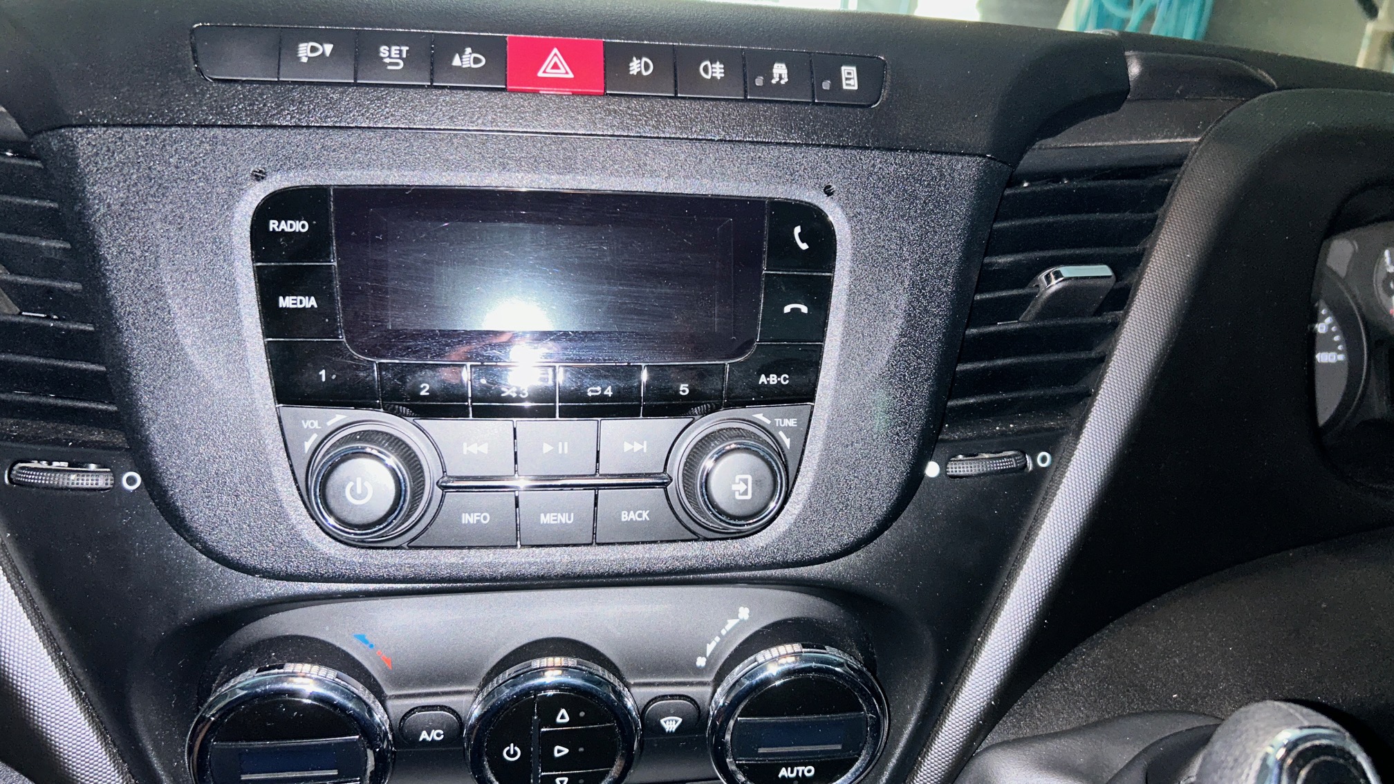

Hi, also a newbie with an IVECO Daily 2021.
Had to replace the battery and now of course the radio wants a code. Trouble is for the life of me, cant work out how to pull the radio out to get the serial number, not sure of the brand.
There are 2 small holes in the facia, I have tried pushing drill bits (backwards) into these holes and it feels like they do push on a realease mechanism but no amount of pulling or prying moved the unit.
Any help would be greatly appreciated.
Hi
I do not know the exact answer but if you check this similar looking unit on Ebay then it looks as though the removal will also involve the plastic outer surround.
see
Iveco Daily Radio Stereo Multi Media Unit 35S12 2.3 2019 - 5802385214 | eBay
This could mean careful use of a set of trim removal tools ( cheap on ebay )..
OR... I have had success sliding in several old credit cards to release the plastic clips holding the trim in place
