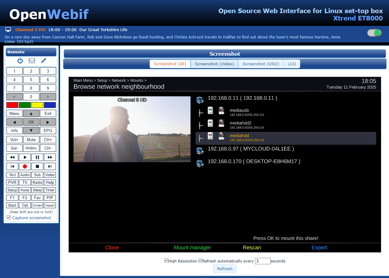

Okay my box has a hdd internal and externally powered usb drive as used to go between mounts to view older recordings , No longer seeing my usb mount to enter and any scan for network mounts used to bring them all up and now only one seen.
If i enter Webif on laptop or on H7S network scan not found. I go into EXPERT mode and enter 192.168.0.11 and scan but it does not find it which it did months ago.

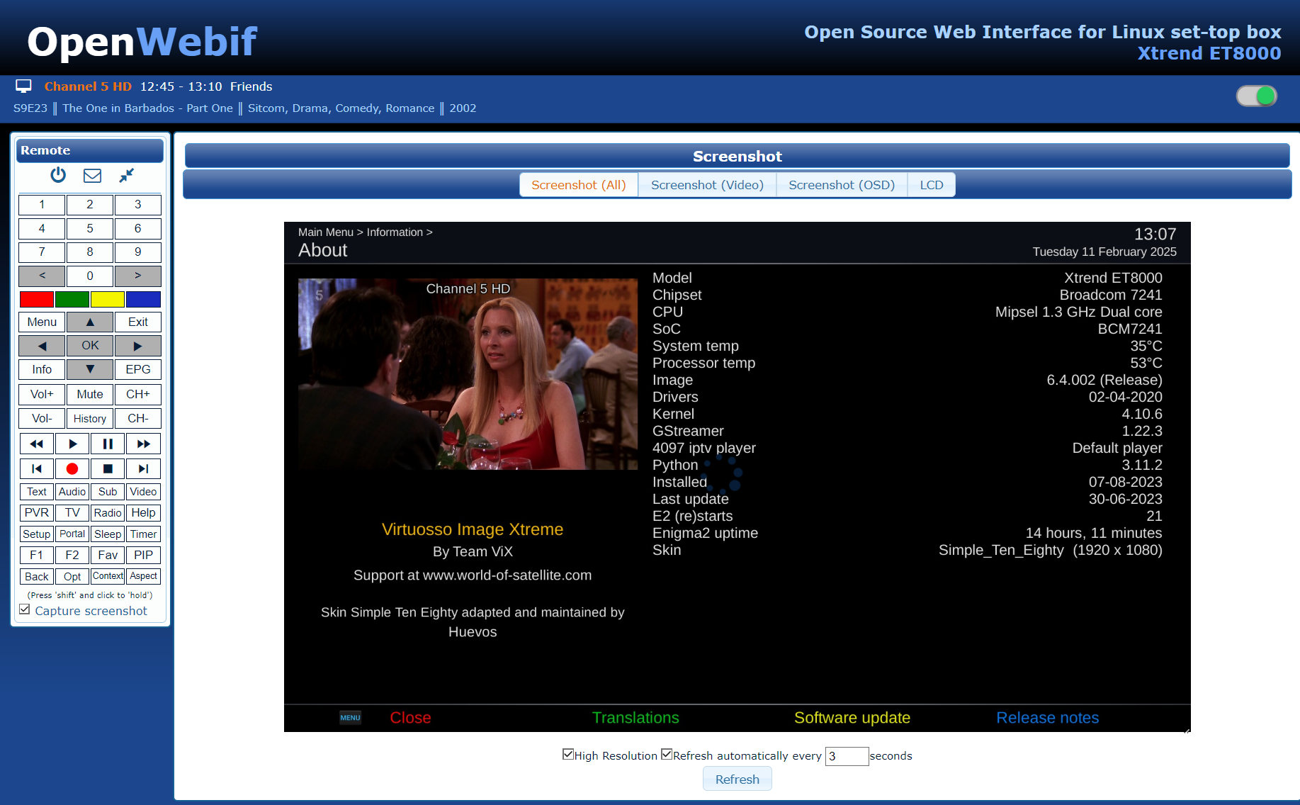

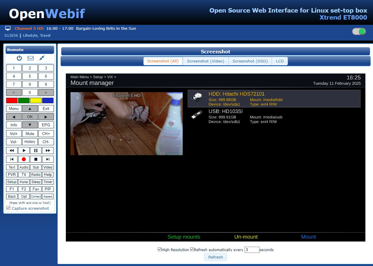

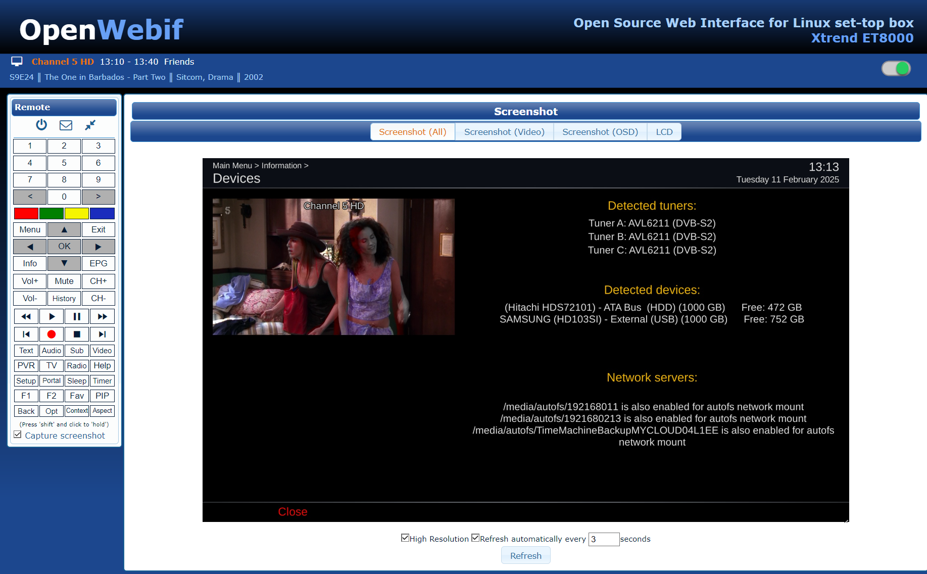

There is a USB storage device detected, but it is not mounted. Have you tried putting receiver into deep standby then restarting again after a minute?
Post a screenshot of Blue, Vix, Mount Manager or post result of issuing this command using Putty/Terminal.
df -Th
Incidentally, you are better off moving to ViX 6.7. The device mounting code that ATV brought into 5.51 branch is more robust especially for those who keep disconnecting USB devices. However, the mount points may need setting up to your preference if you have two devices.

Image after box was powered on again
Went to check Network Browser - Expert and entered IP but does not locate box.

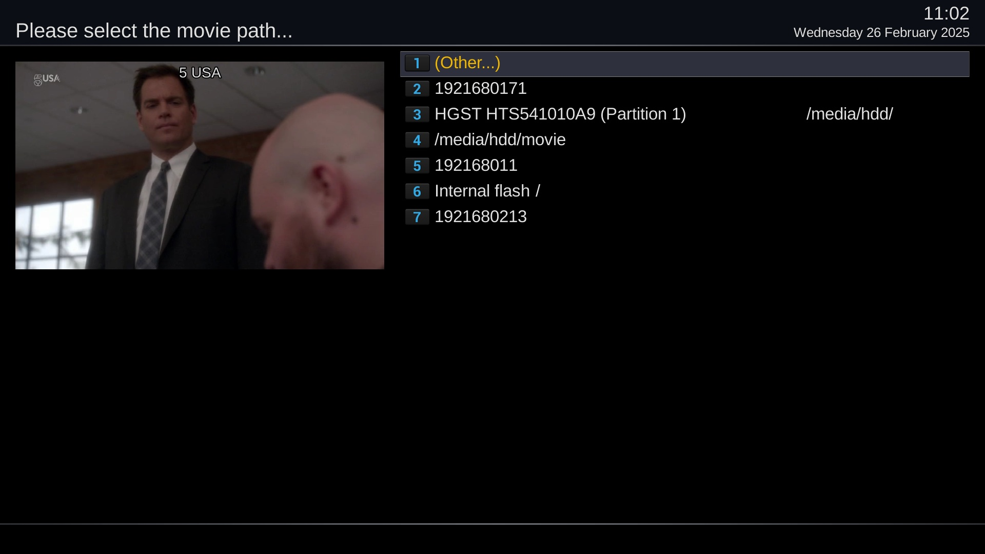

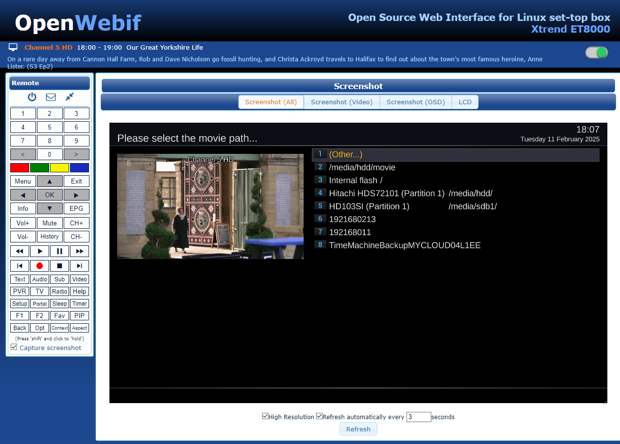

When i was in my recordings and using the yellow location button a could see the USB drive and the Media Hdd.
I see the new image says USB , does this mean to use via the old USB method as downloading to box at the moment.?
AHH all my images state USB

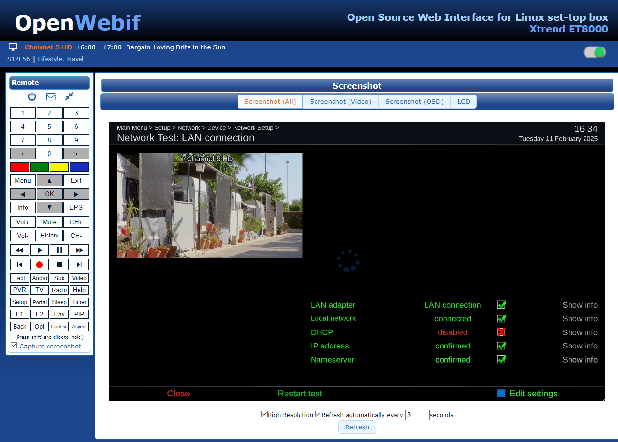

Reflashed to new image , restored settings and plugins and found what was lost. Not thinking straight again today.

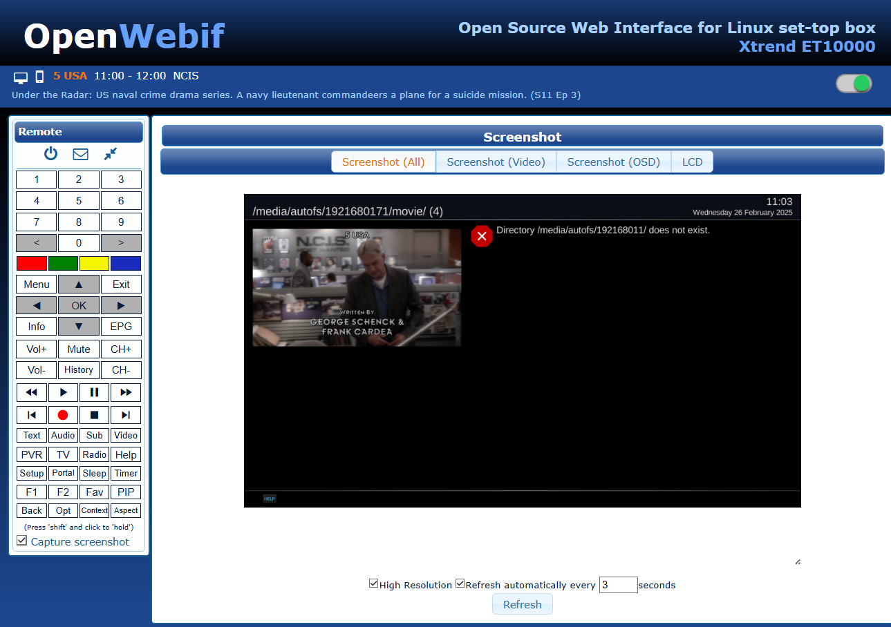

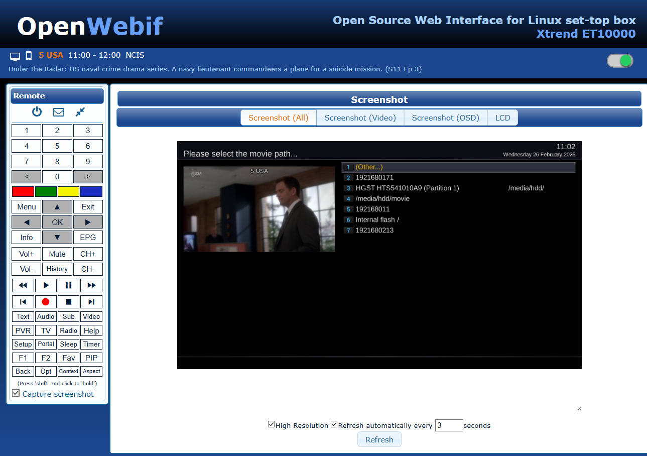

Silly mounts have failed to open recordings on my 8000 from my 10000.
Do boxes get dementia i wonder?

I find it much easier to setup network mounts by editing /etc/auto.network and /etc/enigma2/automounts.xml manually with notepad++
Examples attached that you can edit to suit your setup.
I also have defined IP addresses for all my boxes in my router DHCP settings, so they never change.
Out of curiosity is it possible my ET10000 cannot now open my H7S because of all the network switches in between so making it harder to detect.
I have ordered a Wifi dongle to see it that works better than through 4 switches.
While downstairs i powered on both boxes and on H7S rebooted network , deleted H7S mount and rescanned it back again and now showing on my ET10000 , hmm fresh power as no way would it work if using remove on the ET but used WEBIF.
