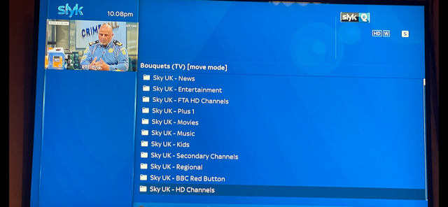

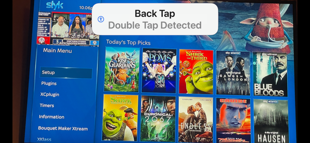

Well that's very useful. E2 boxes and very powerful as you are about to discover. You can make the image in the box look like sky, here is brief on my uno.
But you can also have more than one image loaded. called multiboot.
Willobuild on here does a lovely build and can help etc

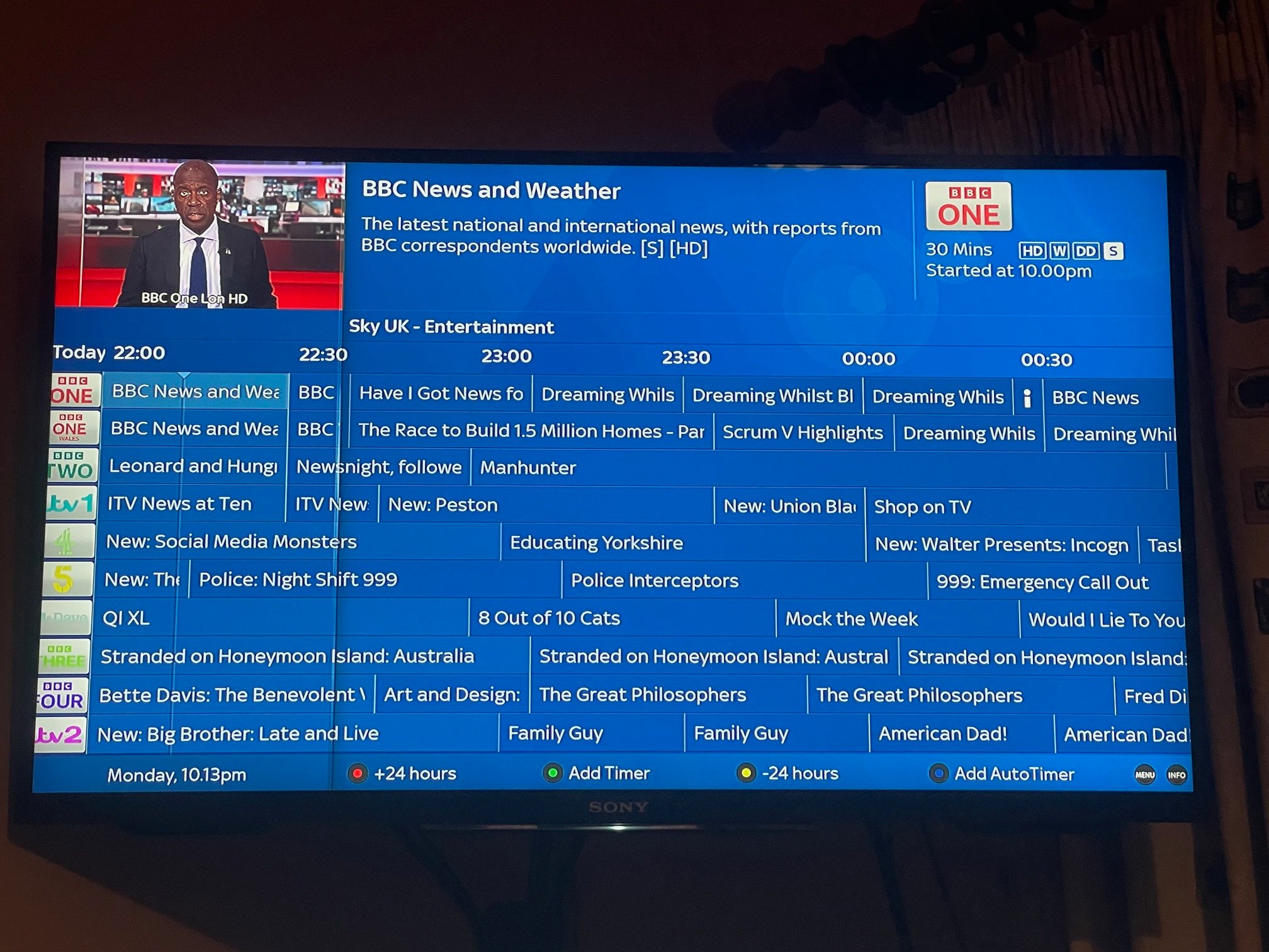

Here is the link. His pics are Onyx and mine are called Slyk Q both by Kiddac. have read of WIllo
https://www.techkings.org/threads/willobuild
With a unicable LNB that has 32 scr and legacy ports you can have multiple connections and just one cable from dish but box needs to be comaptible. With FBC tuners one can record 8 progs at once but a normal box may work as well, ie the sf8008. Just to add to get the most benefit from Unicable FBC tuners are best.
