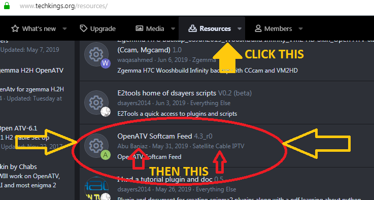

To @Onlywayne go to resources at the top of this page, download/install softcam feed 4.3
install whatever softcams you need from plugins menu after that and away you go

download and install the softcam feed from resources
instructions are there to install it
