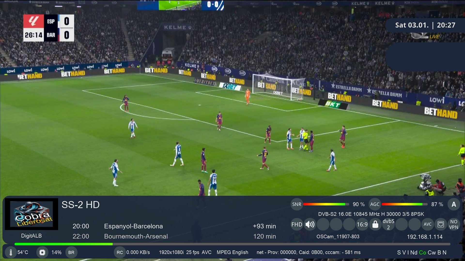

I think your doing fine on a 80cm i get 76 on my Viark on a Lenson 1m 82 on a 1.2 just checked on ss2. Leeds area.
On my 1m dish i am getting 78% and on my 1.3m i'm getting 90%
