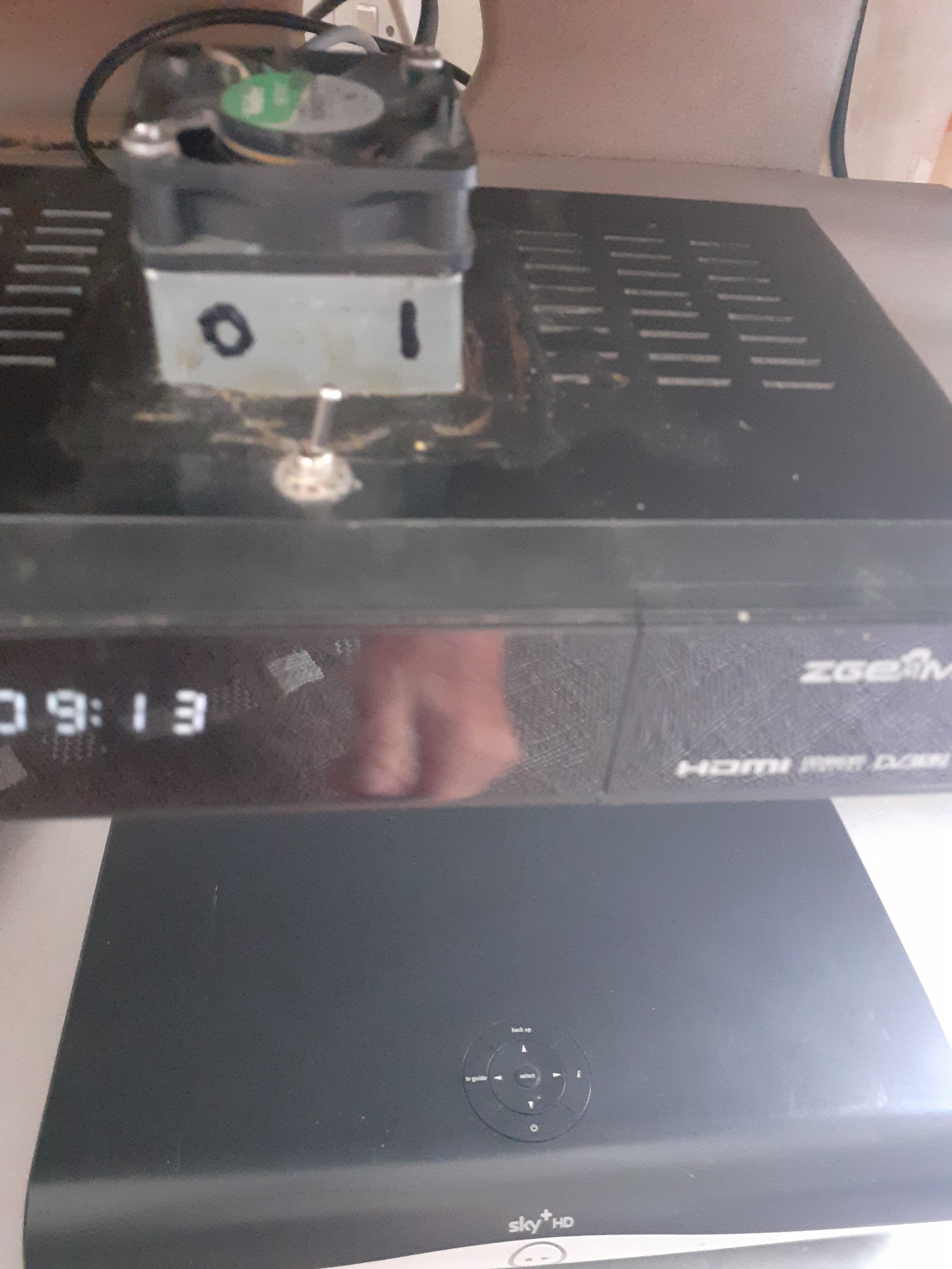

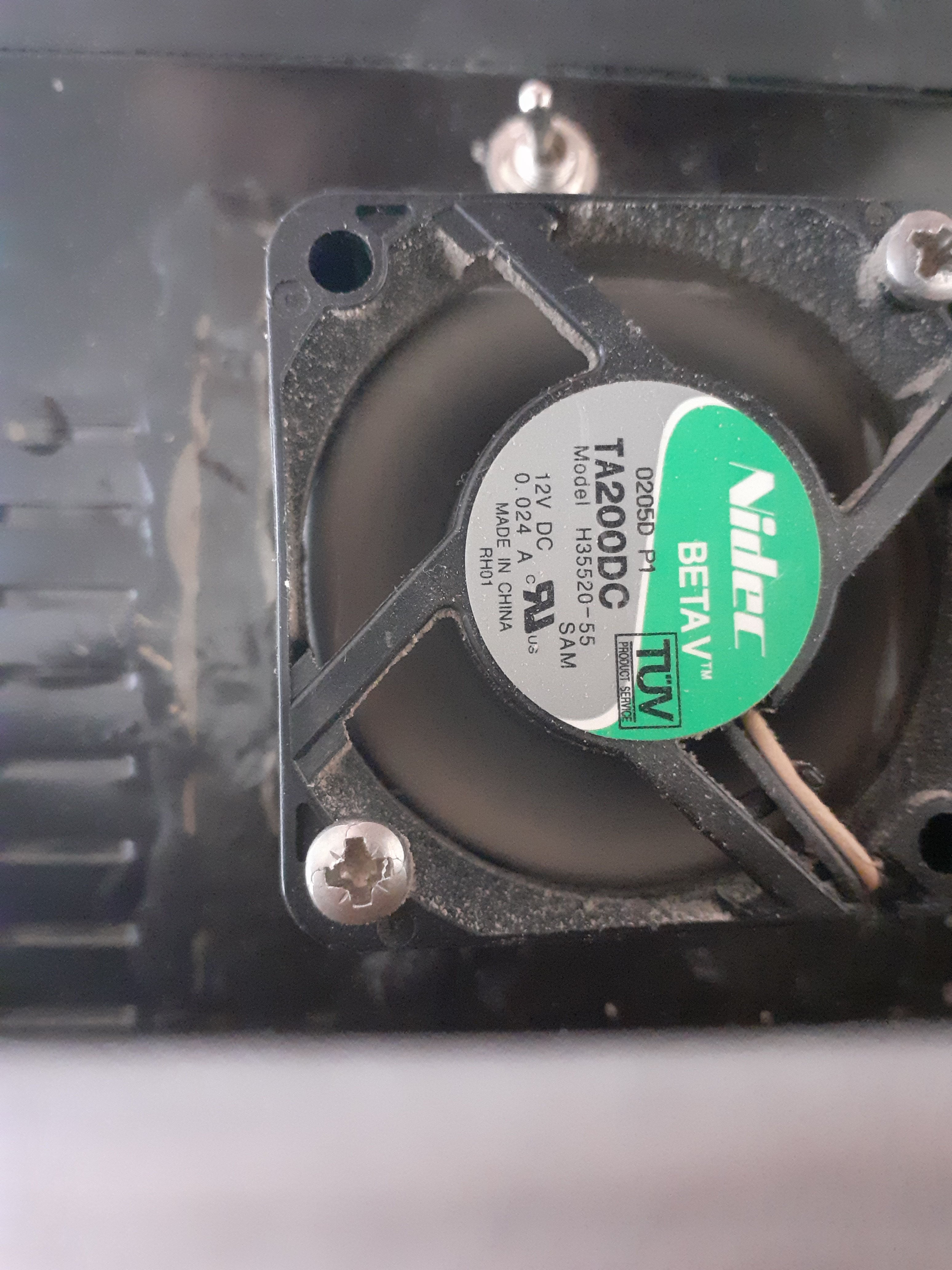

Still got this box and going well just updated to beta 8 42e to 30 w triax 1.1 pole mount, I did fit a small cooling fan from a old video recorder. I took supply from board 6v if I rember right perhaps it was 12v as is on fan. This runs silently 24/7 no freezes or lockups.
