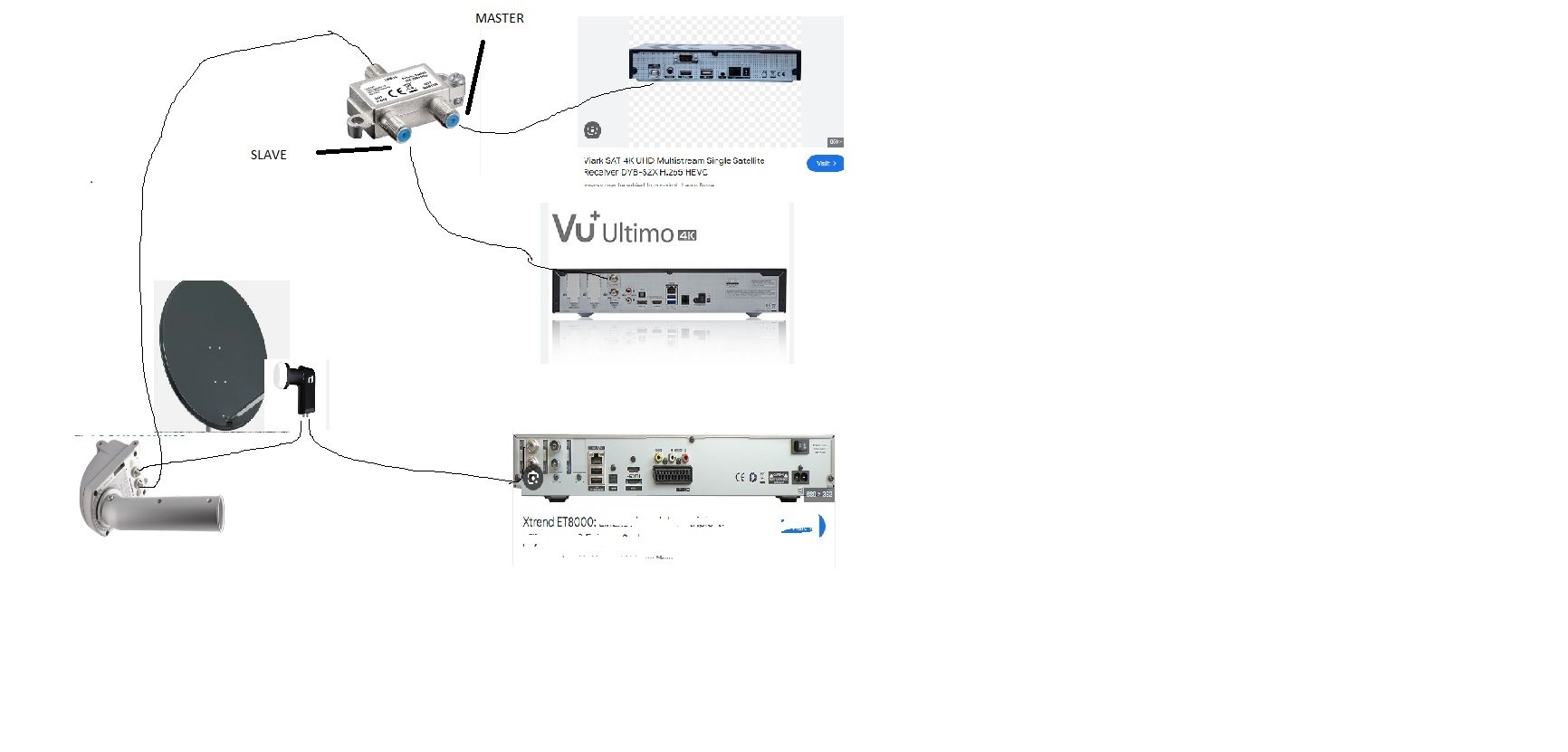

The diagram i posted is what i plan to set up in a few months time.
I wanted to ask a few questions in regards to pretty much getting everything running the way i want it.
The person is quite experienced in installing sat dishes so i dont have to worry there but i wanted to ask what is the best way to set up the VIARK 4k box after he has finished installing it. What freq or channels are the hardest to receive and so might need tweaking etc? (currently have the forever server package on there)
Is USALS the best way of configuring multiple satellites? How long does it take to configure the VIARK after successful installation? If i am only interested in the football satellites, can i speed things up by disregarding the rest of the satellites to which do NOT concern me at all?
I will only focus on maybe setting up the VIARK (while installer is there) . Can i assume that setting up on the enigma 2 should be ok in terms of channels clearing esp with signal levels etc?
Another query i had is that you only see single LNBS with motorised dish but can a TWIN LNB work where for example if the main receiver (viark) is currently watching on satellite 16.e for example. Can my xtrend receiver also watch something on 16.e fully aware that it WONT control the motor but can still get the signal and play channels that a facing 16.e?
Lastly, what satellites am i expected to lock onto with a 100cm satellite dish based in SOUTH WEST LONDON? Am i safe to say i can most of the satellites that cover football EPL champions league la liga bundesliga etc?

I will try to answer some of your questions and leave others for those more knowledgeable as I consider myself a novice in this field..
USALS great for multiple sats..I have a 1m on motor and Zone 2 static work fine with a diseqc switch.
How long does it take setting up a Viark 4k ..I don't have one but most of these boxes are similar ...should be up and running in 30-40mins ..prob spend hours on tweaking channels etc. Yes you will save time concentrating on the few sat that show EPL with eng comms...UCL sadly none do so may have to do with foreign lang for that or audio from elsewhere.
100cm dish which is same as mine I can pickup most sats ..you prob being south will get bettet signal and pick up more than me if u have good line of sight.
Consider ensuring you also setup 7e, 10e and 1w just for feeds eg PPV boxing and football that can pop up which you will be able to tune in..that's as far as my knowledge goes ..
Good luck and be sure to post up pics of your setup 👍
If the dish is physically aligned to use USALS, then that is best option. That means any receiver you connect to the dish just has to be configured for USALS instead of saving and storing every position.
Yes, you can use multiple output LNBs on a motorised dish. Can be more than twin. As you said, other receivers cannot control the motor
I thought you had setup the Viark and used it elsewhere to test it out. Once the installation of the dish is done , connect your viark via USALS. have you added a motor euro channel list to the viark.
As long as the Dish is setup correctly your then good to go

HI
Appreciate you taking time out for your input.
So does USLAS basically work by the dish starting from 1W and then it scans all the channels from the satellites and the dish moves itself until its completed everything?
When "just for feeds" does that i mean i shall try and find a channel from each of these satellites and check if picture is ok and the SNR levels are OK?
Yh i will post a pic once it gets installed.

On all receivers, when you select a channel, the receiver will tell the dish to go to the satellite that the channel is on.
If a particular frequency is not on your channel list, you can also tell the receiver which satellite and frequency to scan. It will then move dish to that satellite.
