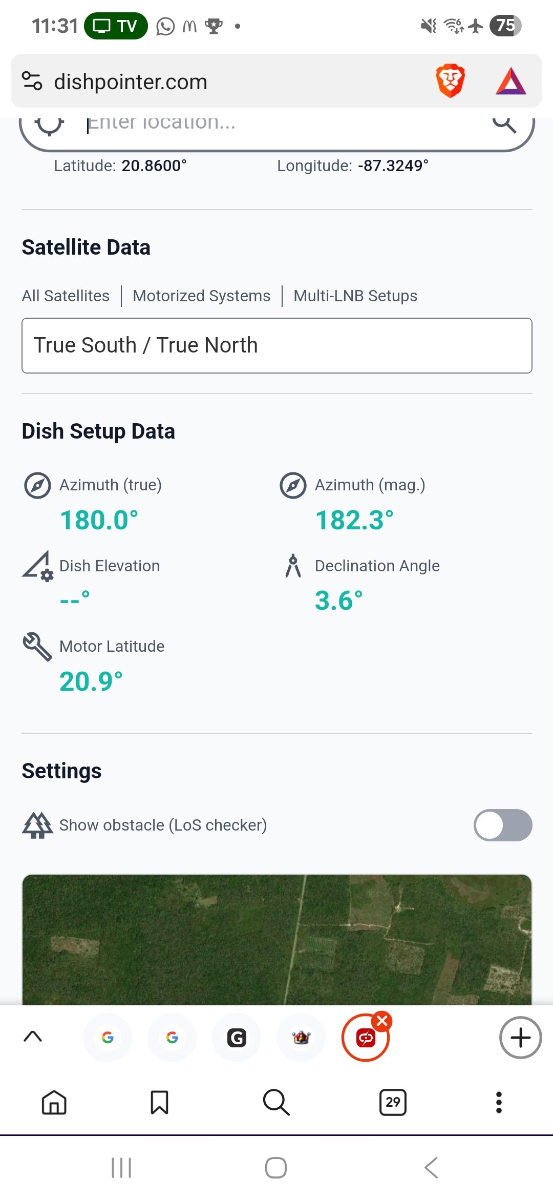

I was looking at my longitude and latitude direction settings. I put my postcode in
It doesn't let me put all those numbers into my viark.
Also what should the rotating speed be set as?
