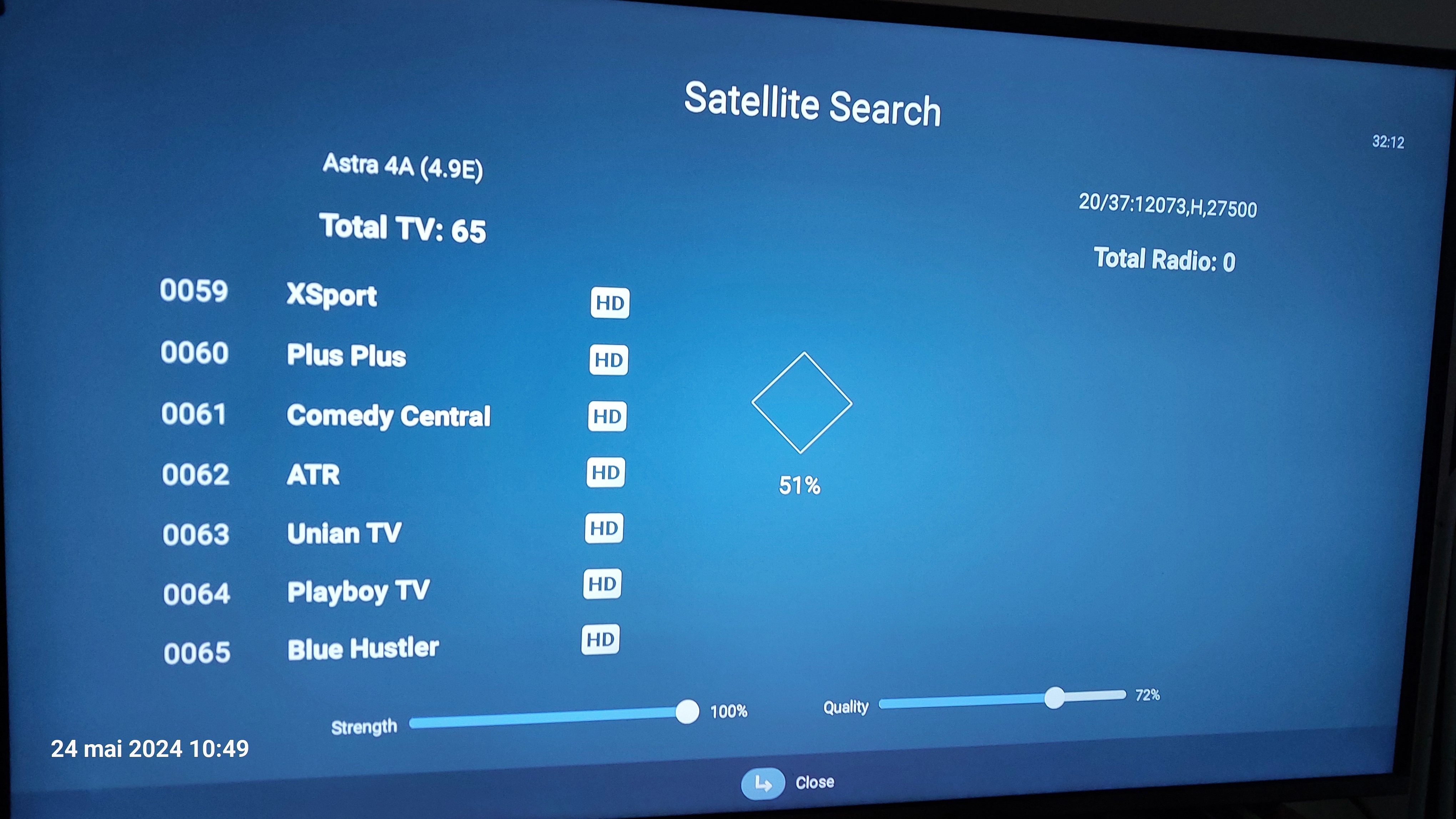

We installed H-H engine.The dual Qviart receiver does not rotate the antenna on Android or Linux.
We rotated the antenna with Octagon sf8008 4K, Octagon sf4008 4K, AB PULSe 4K UHD,Qviart Lunix3 4K.
Is there any solution to rotate the antenna with this receiver?
I don't know what a h-h engine is other than a motor but i have no problem using my dual with either a tm2300 or tm2600 motor under both android or E2 using Usals.

That's how I'm waiting for a satellite scan, scan that's not done.

Since you are motorised use this channel list.
Qviart - Full Motor-Qviart Dual-4k-UHD-BY-FENEKI Latest
After installing all you need to do is setup your usuals coordinates.
