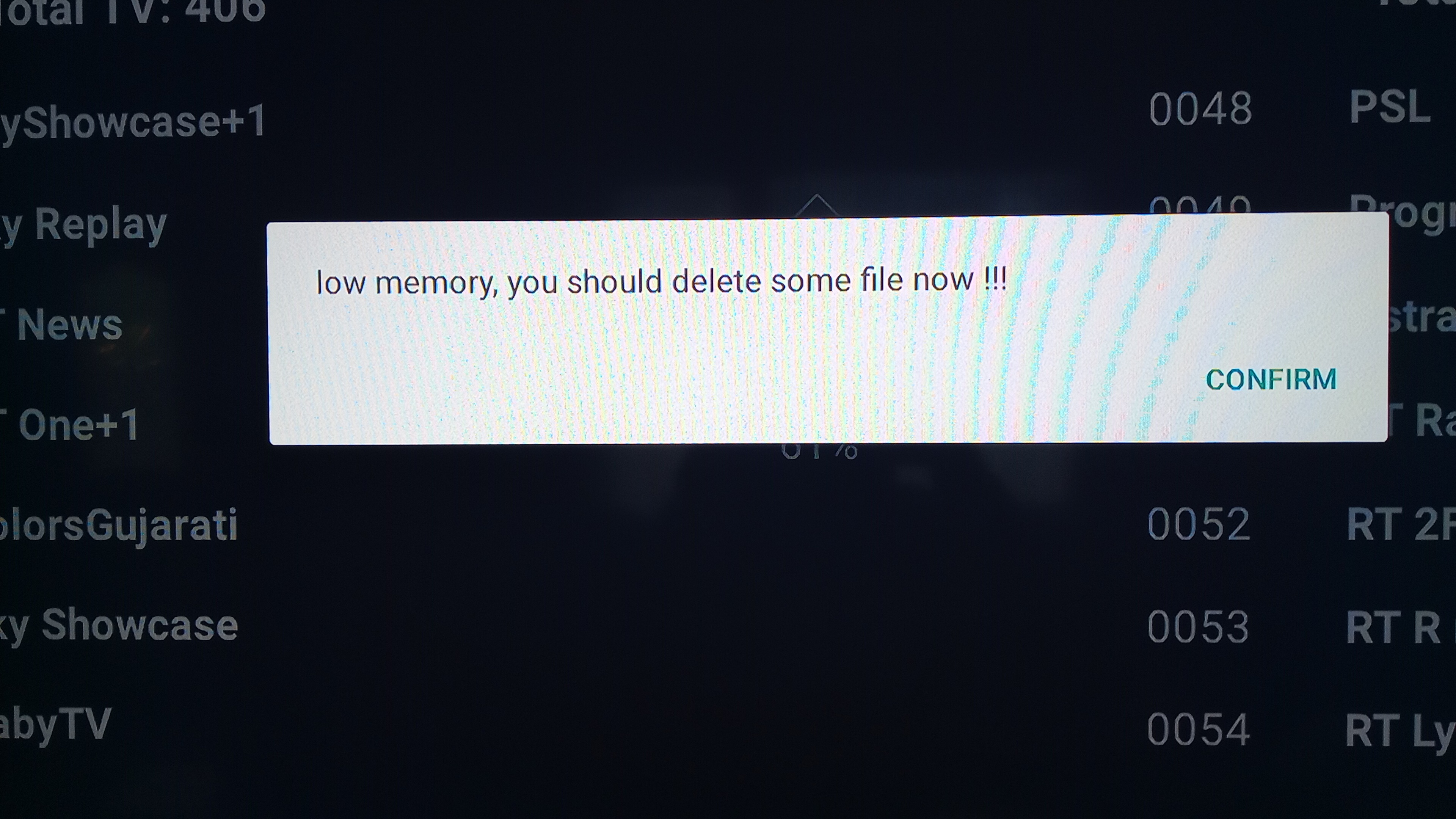

What's this all about.?
I wonder if Tivimate is downloading the epg somewhere. I very rarely use mine on the Android side. There is a chance it could be an issue with 1.0.9 software maybe.
Ah never even thought about that mate.
Just checked Tivimate and low and behold at 09.13PM it done the EPG update.
Looking at the settings for the EPG it's set past days to keep 7 lol..
That will be the issue I'm sure.
Thanks
I ran all sorts of apps including Tivimate and Implayer never got close to filling the duals internal memory.
Strange it seems to suggest that with just Tivimate alone.
Not sure so mate.
Never seen it before, it just popped up when running a blind scan on 28
Not sure so mate.
Ah that maybe a different matter and a channel limit has kicked in, ive no idea how many channels it can store.
How many channels do you have under ALL ?
I'll check when I get a chance to turn it on mate.. At the moment can't as my daughter has a few friends sleeping over...
But have 45e to 30w on it .
