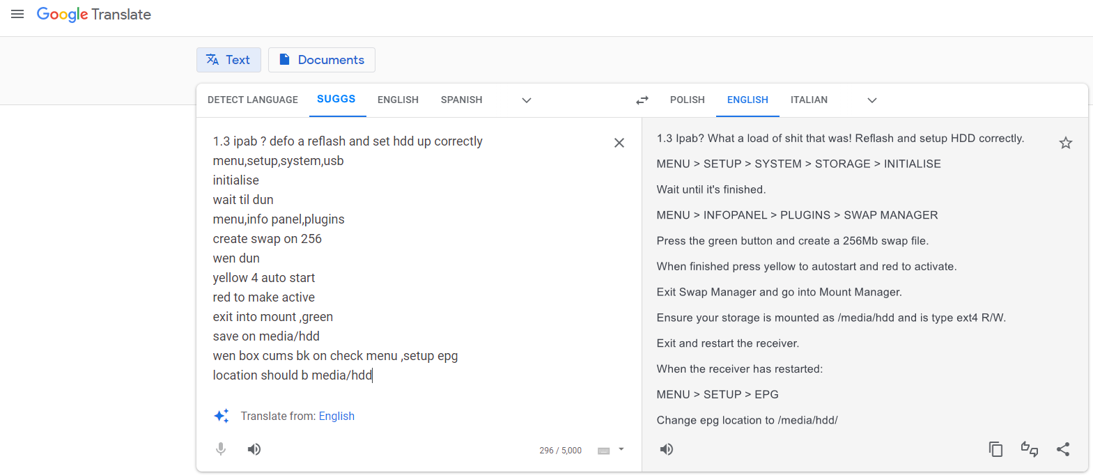

1.3 ipab ? defo a reflash and set hdd up correctly
menu,setup,system,usb
initialise
wait til dun
menu,info panel,plugins
create swap on 256
wen dun
yellow 4 auto start
red to make active
exit into mount ,green
save on media/hdd
wen box cums bk on check menu ,setup epg
location should b media/hdd
