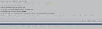

I think this is the thread on the other forum:
So what happens on ATV if you have Tuner A connected to 28.2 and Tuner B connected to 19.2?
With your setup every tuner apart from A would be connected to 19.2?
