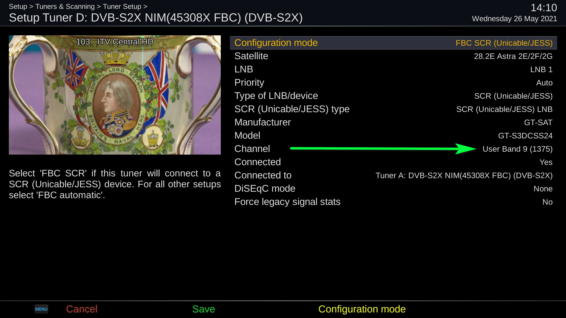

I got to ten recording at once on my new gigablue uhd quad 4k just trying fbc tuners and only one sat cable connected to tuner A now using unicable lnb.
Would really like to get SAT>IP working if possible tried zgemma h9 combo as client but can't seem to get it going read elseware problem with arm boxes and SAT>IP. Just learning here guys do I need a dedicated SAT>ip box for client ?

On OpenATV with unicable the tuners are set up differently to VIX I have only once tuner A connected at the moment.
Also I don't know if changing settings in Menu> Setup> Usage & User Interface>Cusromise
