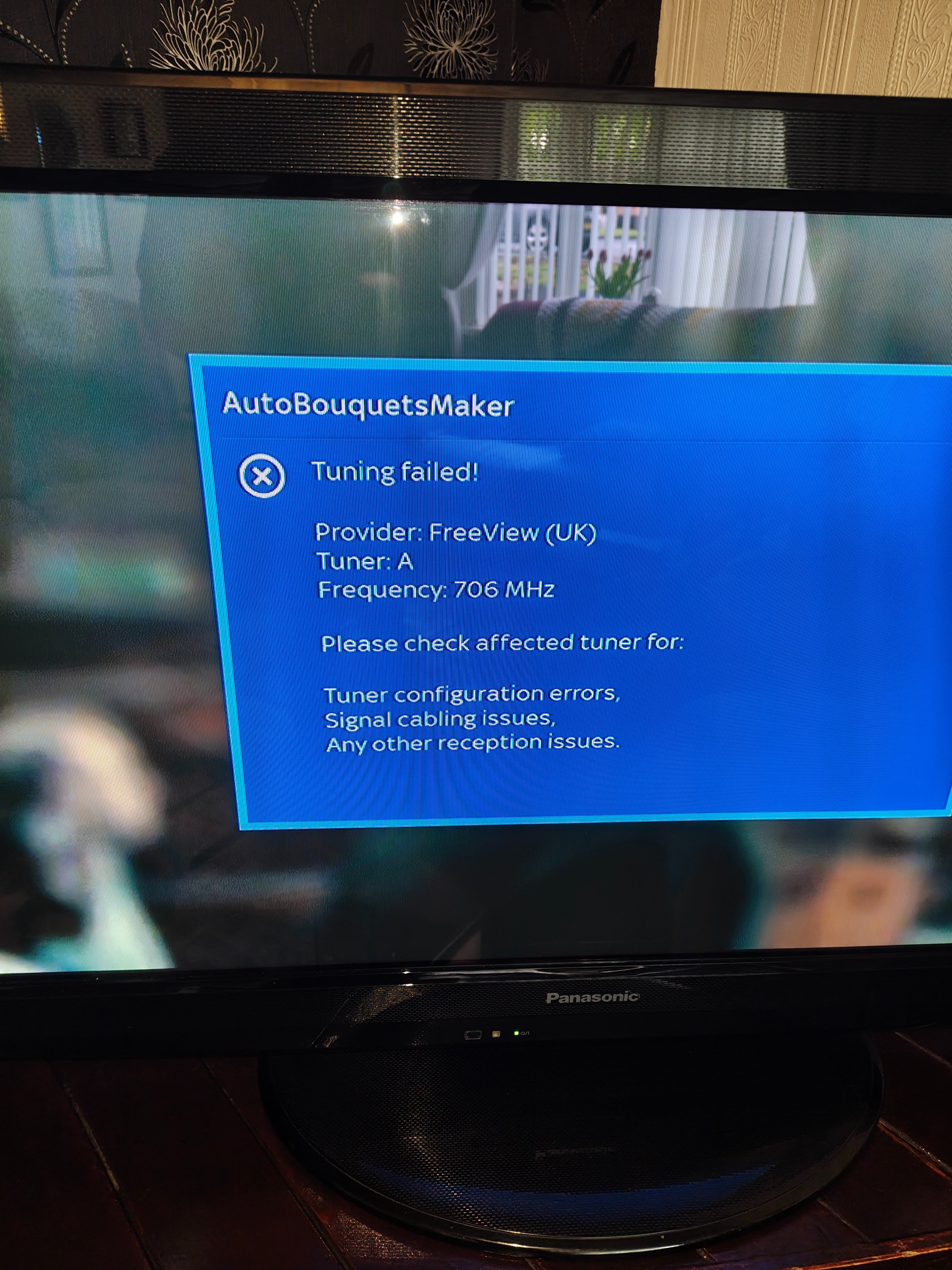

So I have done the above with a freeview aerial and I am getting this when I try to scan in with ABM. Brand new indoor Freeview aerial that is working in upstairs TV.
Any ideas?

Could be the indoor aerial signal is too weak where the box is try moving it near a window or higher up and do a manual scan instead of ABM first
What box is he using and what region have you got selected in ABM?
H9.2h should be fine maybe ABM is picking the wrong transmitter try doing a manual terrestrial scan first and see if it finds channels before running ABM again
Only 2 input options. Tuner b for sat dish and tuner a for Freeview aerial and it's in tuner a. Will try a stronger aerial to see.
When doing a manual scan. What channel MHz do I pick it's bring up loads
Yeah sounds like the aerial probably just not strong enough mate especially with an indoor one
For manual scan he needs the correct transmitter frequencies for his area in Northern Ireland otherwise it’ll just scan random stuff
