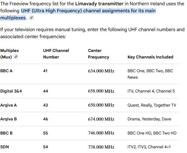

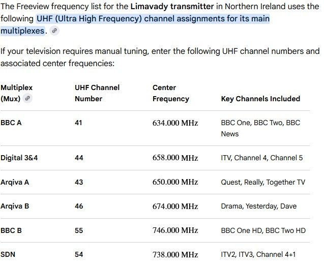

These are the Limavady frequencies for a manual search, I use the Brougher transmitter so I don't know if these are correct or not.
ABM tries to tune to 706 MHz for Limavady, which is not on your list, so it needs to be updated to 634 if correct. There is also no HD frequency listed, so ABM will not find HD Terrestrial services. If somebody in the area can run Frequency finder in ABM and upload the output it ,we can change it and ABM will work for everyone in the area.

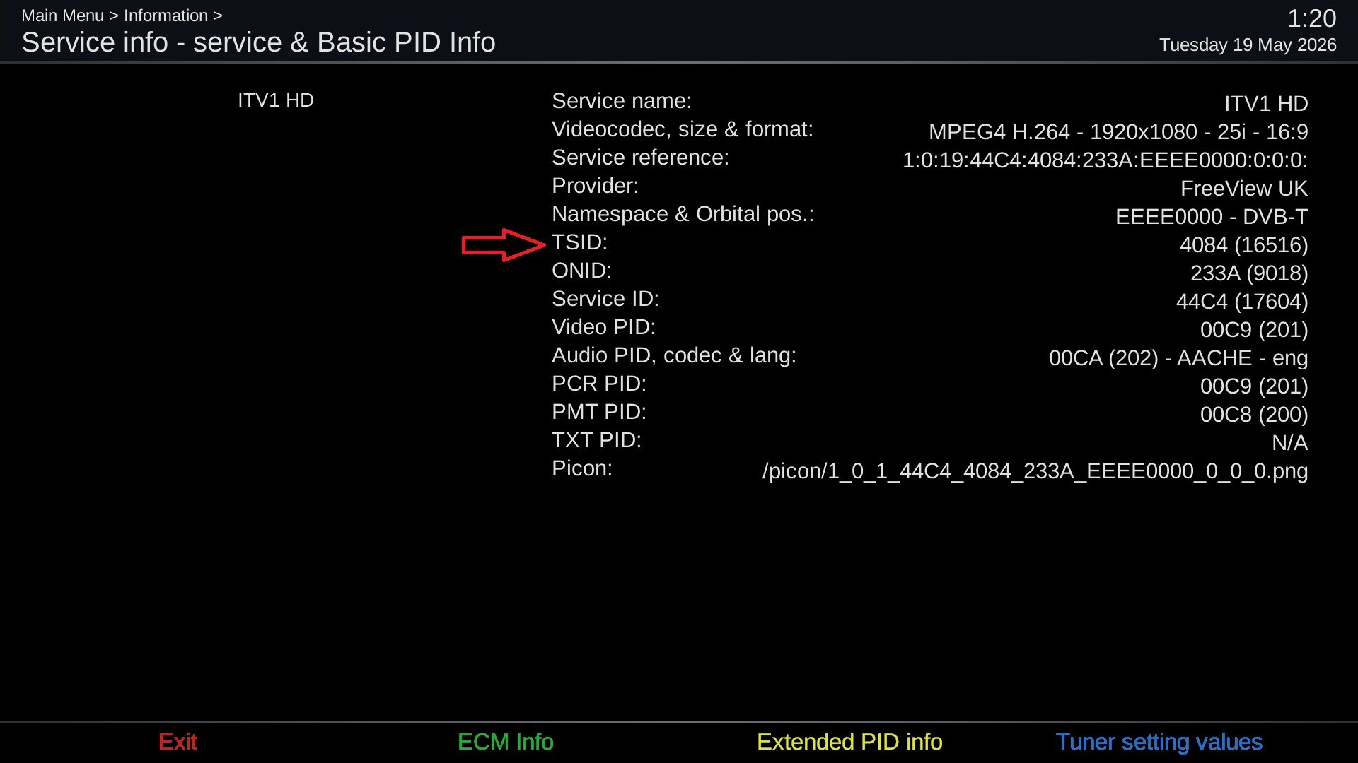

If the information I have found is correct, your HD services are on 682 Mhz. If someone in the region can select a HD Terrestrial (aerial) channel and then select Menu > Information > Service
Upload a screenshot or clear picture. as below. We can then add the HD multiple for the area.
