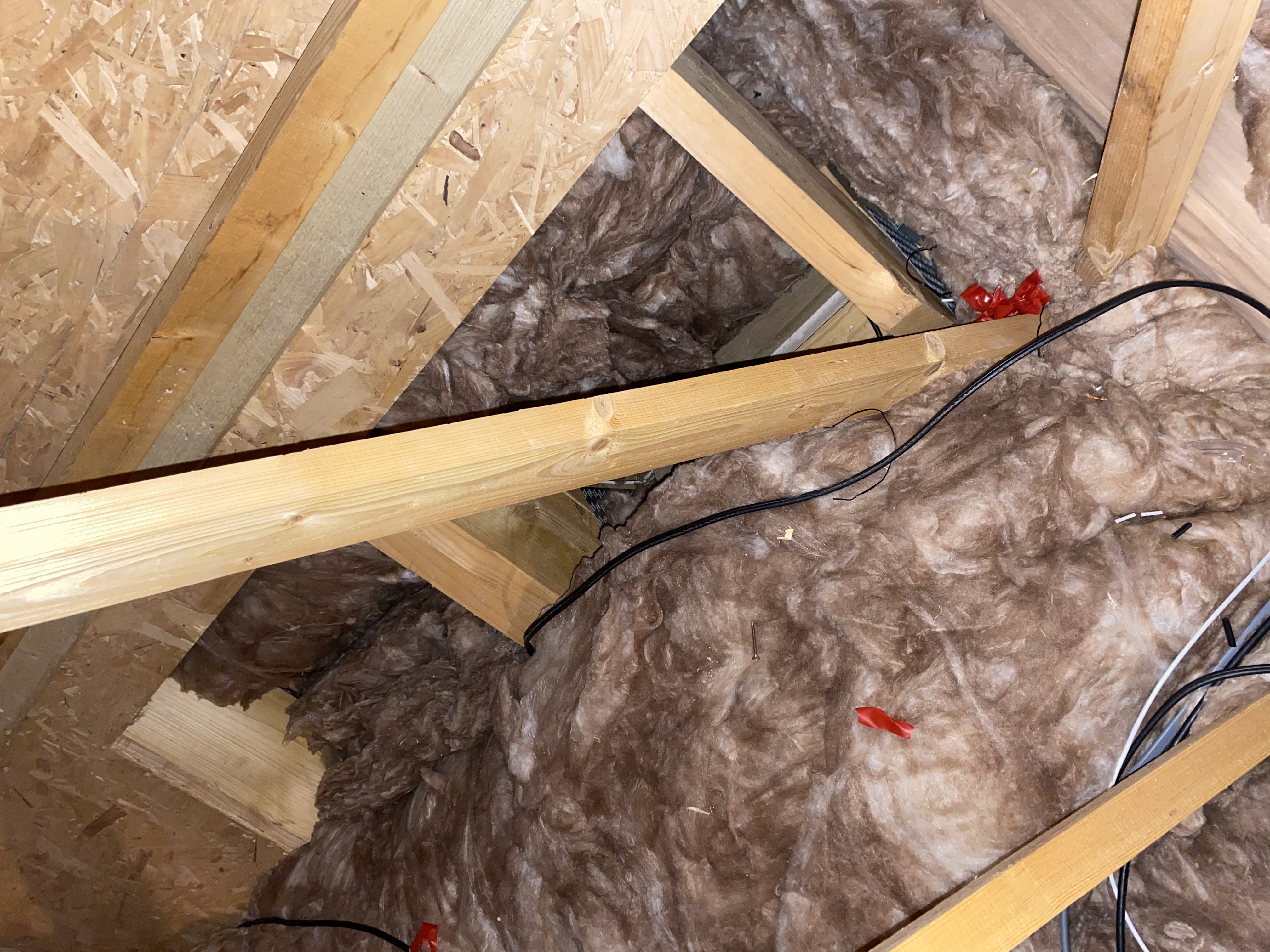

Do you have an attic in your house where other things lurk as we wonder where 2 cables are going.

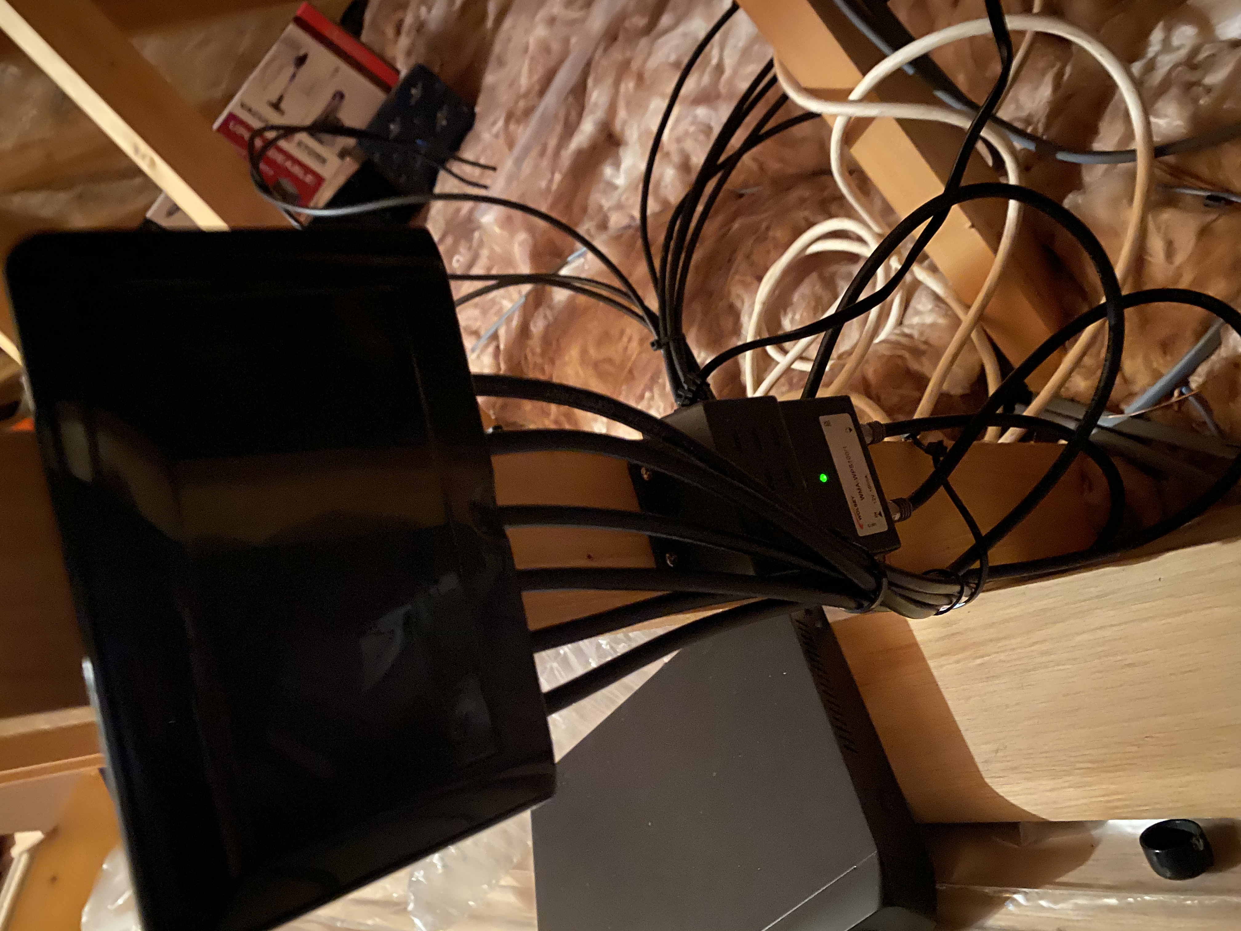

Ahh missed that post,photo of boxes in attic might help?
Post 15 shows 2 white cables dangling for what?
You did say non connected are now working on downstairs room when refiited back on quad
They’re just spare cables
The bottom box is a 12volt masthead amplifer for your Areil The top box could be a distribution amplifer powering the masthead
Amplifier With various cables to T.v points

You need to start tracing and labelling your cables and drawing a diagram so you can make sense of it. In your loft, you have a distribution system. I presume the power supply for the amplifier/distibution unit was in sitting room. Just to repeat,
PSU in sitting room.
Amplifier/distribution in loft.
When the Sky Q was disconnected, you also disconnected the power supply for aerial distribution by accident. Im guessing, I could be wrong.
One of your pictures in the loft also shows a shotgun cable, which I presume is used for satellite. Follow the shotgun cable in the loft, where does it end up? Be careful not to step on something you don't want to.
