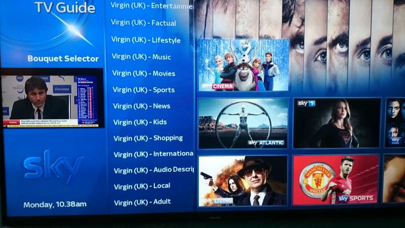

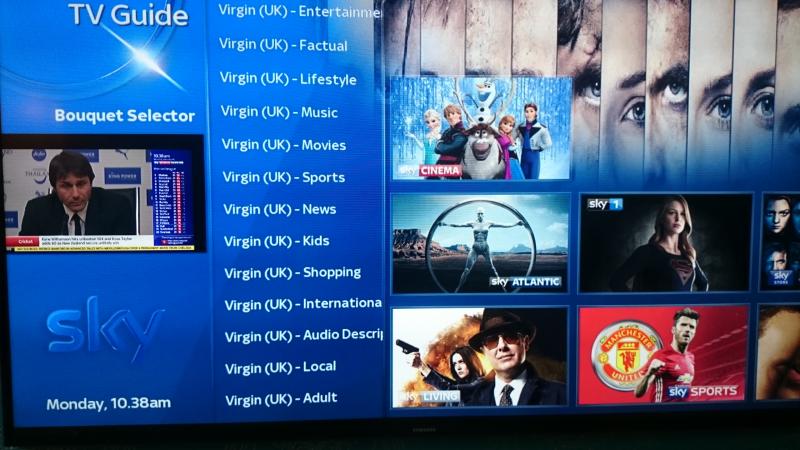

So got the Toppicks and scrape working at long last, but having trouble with not all the images changing. The main background one with the faces/eyes still remains there from day one. Any ideas why this one isn't changing?
Hi Jwigley
Sent you a PM but not sure if it is menat to be like this but the top picks change fine BUT I noticed the 3 of them remain static The Blacklist, Supergirl, and Westworld remain the same...does your change??
What about anyone else??
Hi Theguru , How and what settings have you done ? I thought I set mine correct but two days now and Toppicks and Scrape are still the same any idea.

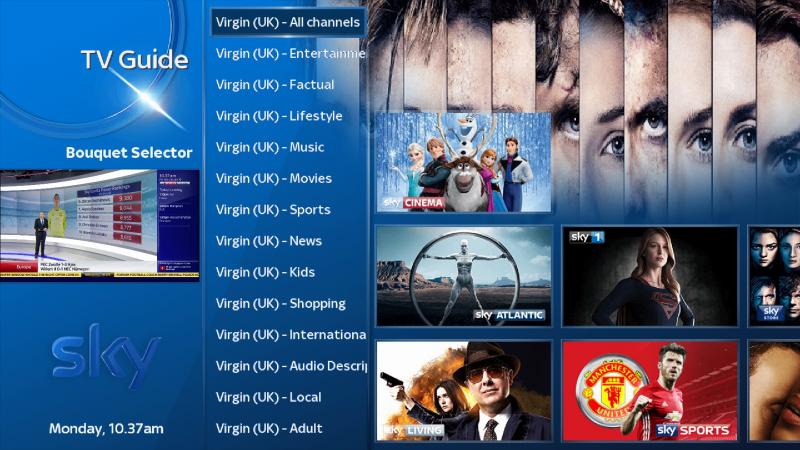

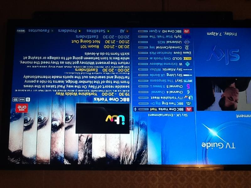

Hi there, just wondering if any one would be able to help me to get the channel selection screen looking like the first image (Chabs version) below please? Have tried numerous different settings but to no avail? I can't get rid of a picture in the top right corner and the programme info beside the channel name is not all fitting on as in my image, the second one which seems to have uploaded upside down, sorry! Any help much appreciated...

Ok guys I have tried to get my toppicks to change but still the same ,I have tried changing permissions to 775 still no joy ,tried in cron timers still no and even tried menu through to Cron manager and it is still a no , Plz lmk what I am doing wrong
Thanks in advance
Thanks in advance
I have exactly the same issue would be great to get a fix
Thanks in advance
If your running openvix image the images scrape to folder named scripts and not script as openAtv image, so you have to edit the the toppicks files to amend the dir to usr/scripts so the box can locate your toppicks images in the right folder

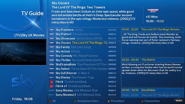

Hi there, how do I get the large picture like yours, I just get the same large picture no matter which channel I choose? Many thanks...
http://www.techkings.org/attachments/openvix-openatv-skins/19395d1473272014-skyq-skin-1_0_1_1658_7e5_2_11a0000_0_0_0.jpg
