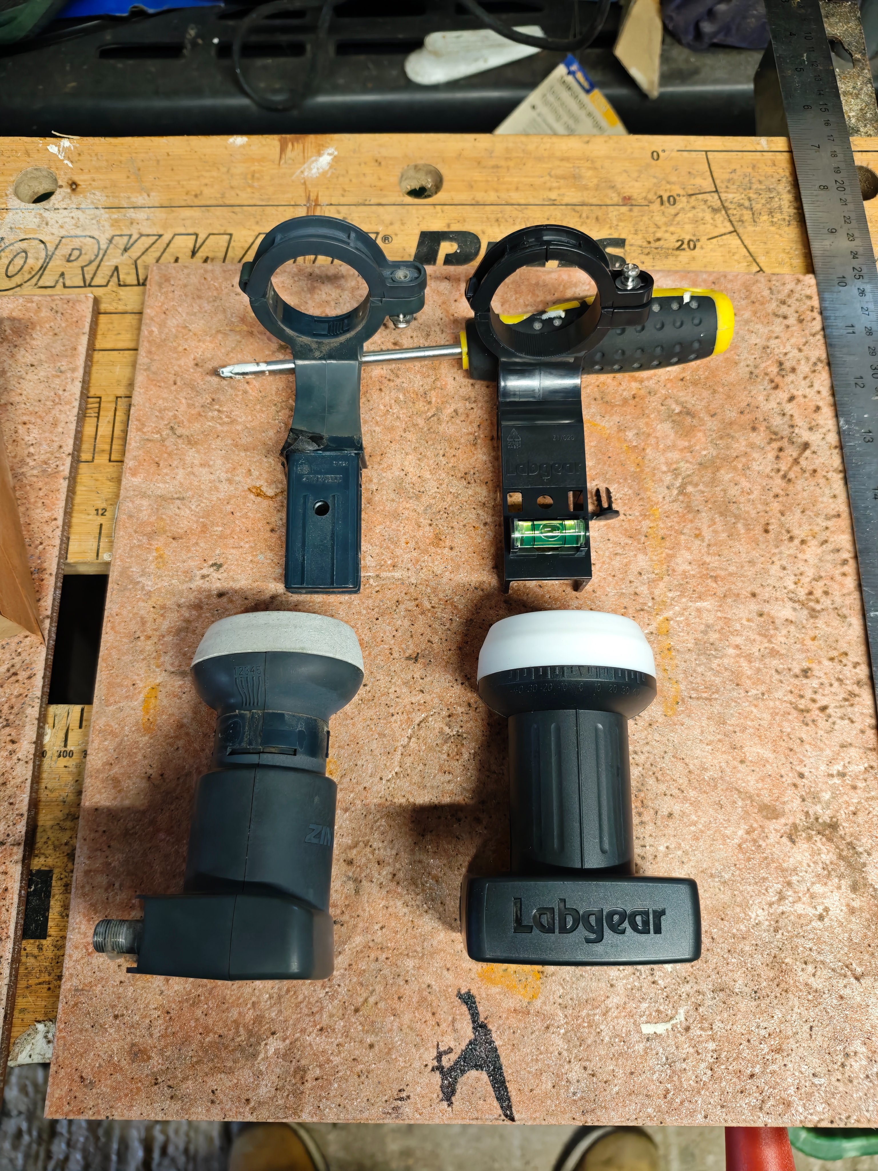

I've decided to change our my sky lnb out this morning to a labgear quad. I get up to the dish and remove the old lnb to find out they are incompatible. I need to find a mark 2 lnb and holder that fits inside the dish not external. The lnb collar side is also 35mm not 40mm like the new one or I would have just swapped the brackets. I guess a sky engineer changed it years ago as the lnb was just taped in place. It must of been up there 15 years. See pictures to what I need.

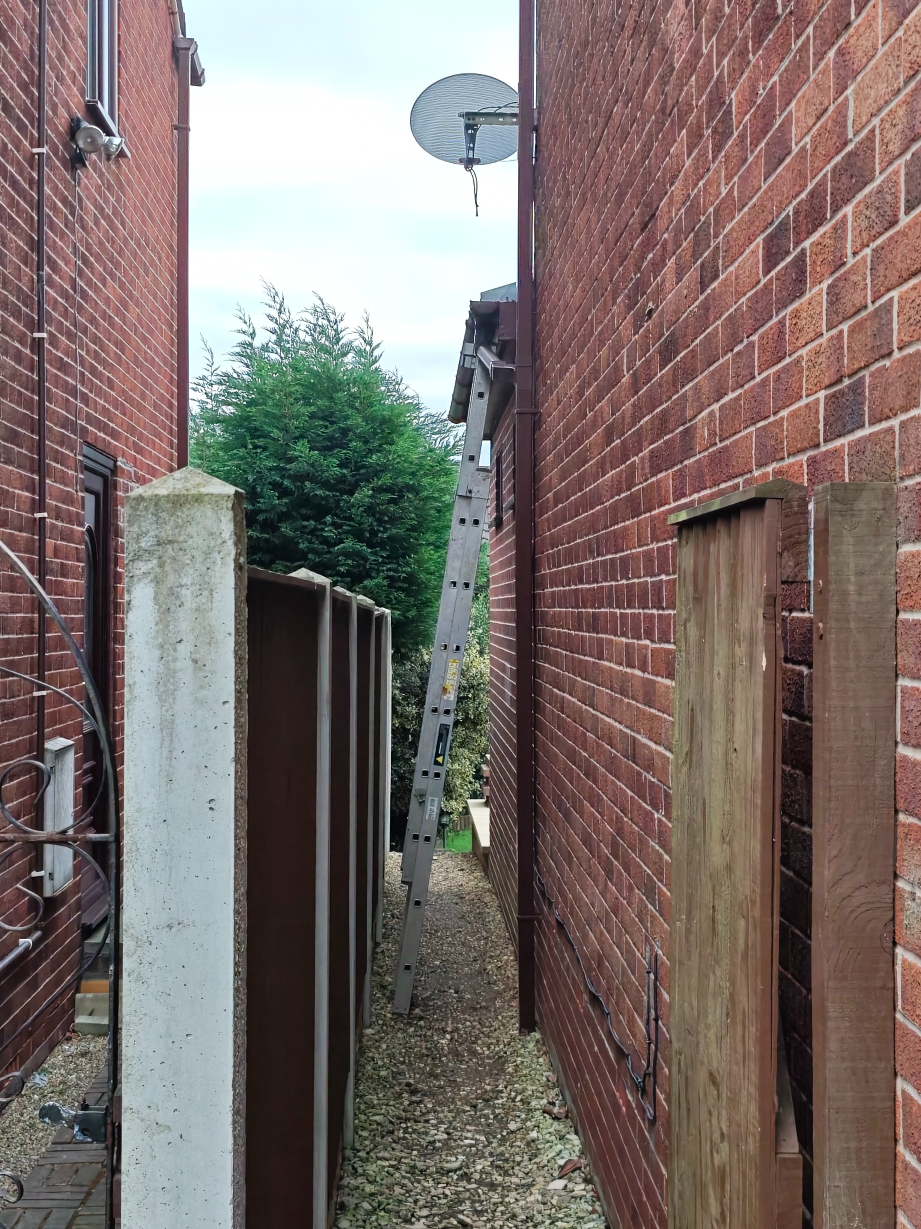

Unfortunately when i moved into the house years ago i made the sky tech put the dish is what i thought was a smart place. Its a pig to get to just to change the lnb removing the dish might be even harder. If i decide to go down that route i can place it just above head height on the south wall. I've got a mate who owns a sat shop having a look around to see if he has anything lying around.

I think your measuring is slightly out. The current Sky LNBs should fit. They are 38mm. You might be measuring inside the clips that go inside the notches to force correct skew. Please double check with a designated LNB for Sky dishes.
Industry standard LNBs are wider than Sky LNBs, apart from the bullet type.
You've purchased a standard LNB with a holder to fit MK4 SKY dish.
A Mk4 Sky LNB should fit in your bracket.
