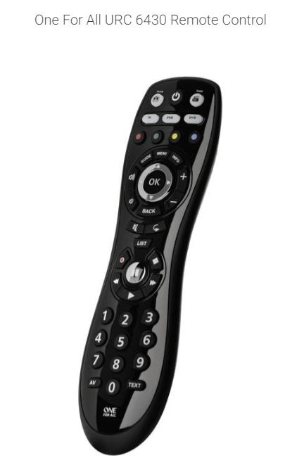

Can I ask also if it is possible to program a sly remote to work with the H2S ( for elderly user )
They don't seem to sell the ones I use anymore.
The new ones don't have a list button as far as I can see.
Mine is a 6430:
