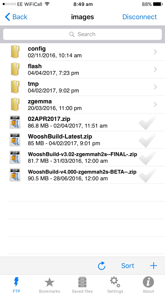

U could put the basebuild zip file into a folder on ur usb stick that u use for recording. Then u can flash that through the menu system.
So to so this ftp the zip file to the folder media/hdd/images and then press on ur remote the blue button and ull see software management on left side pane and then go across from that and select flash online/local in right side pane.
Follow instructions/coloured buttons to flash locally and select the zipped file u ftpd over earlier.
Ur box will now flash with the basebuild and then it will walk u through the process of upgrading to the latest full wooshbuild v5.
