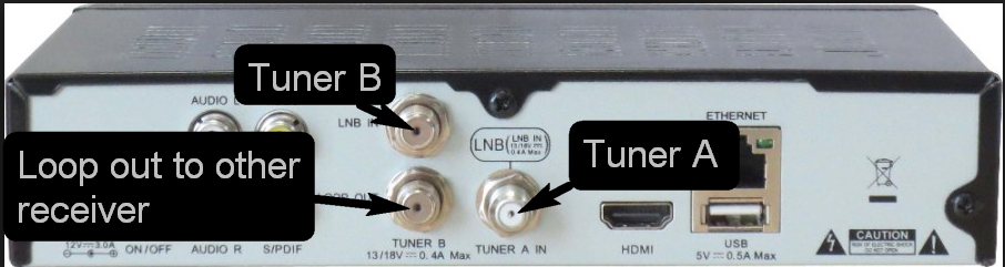

Seems you're not following my question and the setup. I don't have any issue receiving and watching from the four seats, 13,19,23.5 and 28.2 based on my current settings. My dies he has a four LNB holder which is hooked up into a single cable into my house. And inside the house I use the Triax splitter to connect my sat box and my freeeview on the TV, which works ok. But since I have the Zgemma with two tuners wanted to know how I can make use of Tuner B to record by adding another coax from my splitter to the Tuner B or LNB socket

PS- what is the LNB inpunt on Zgemma used for since only the Tuner A gives signal ?

Cheers - so LNB is actually the Tuner B. So I can run a new cable from 28.2 LNB to this. Thanks for clarifying. PS - is there a better option Thant the Triax splitter am using for my TV inbuilt tuner and the STB, without running a new cable. Most times a use mainly the TV for FTA channels and the box for other things

How about disconnecting feed to telly at splitter and connecting it to loop through on zgemma then adding a new lead from splitter to Tuner 'B', then configure Tuner'B' to your requirements.
Thanks - will that not require the box to be on for the tv tuner to work? Currently I can use the tv turn without turning the box on?
