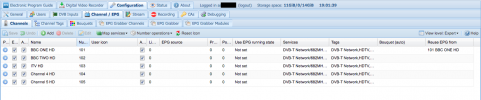

I had a RPI3 (1GB) lying about - Added a £7 pi tvhat (avoid the RPI4 at the moment). Plugged in ETH & COAX (Freeview UK). IIRC, Synology stopped supporting USB TV Tuners.
Installed OSMC (which is a sort of kodi distro) on RPI3 and updated to tvheadend v4.3

Installed Docker & alturismo/xteve v2.1.2 (on Synology DSM6.2 with Plex 1.21). Configured xteve as FFMPEG with 2MB buffer
XMLTV = http://192.168.1.105:9981/xmltv/channels
M3U = http://192.168.1.105:9981/playlist/channels
Added "LIVETV & DVR" to Plex and the Plex TV Guide is quite impressive now. 7 day ahead with Series/Episode & Posters. I do have Plex Pass.
I'm only tuned to the DVB-T HD Channels (682MHz for me in UK) and can receive 3 at once as they are all on the same MUX. The RPI3 CPU is 5% & BW is 5Mbs per channel on a 100Mbs IF. I guess you can tune all 5 at once! Goes without saying the Sony CXD2880 is a single tuner, can only attach to 1 MUX at a time for recording or watching.
