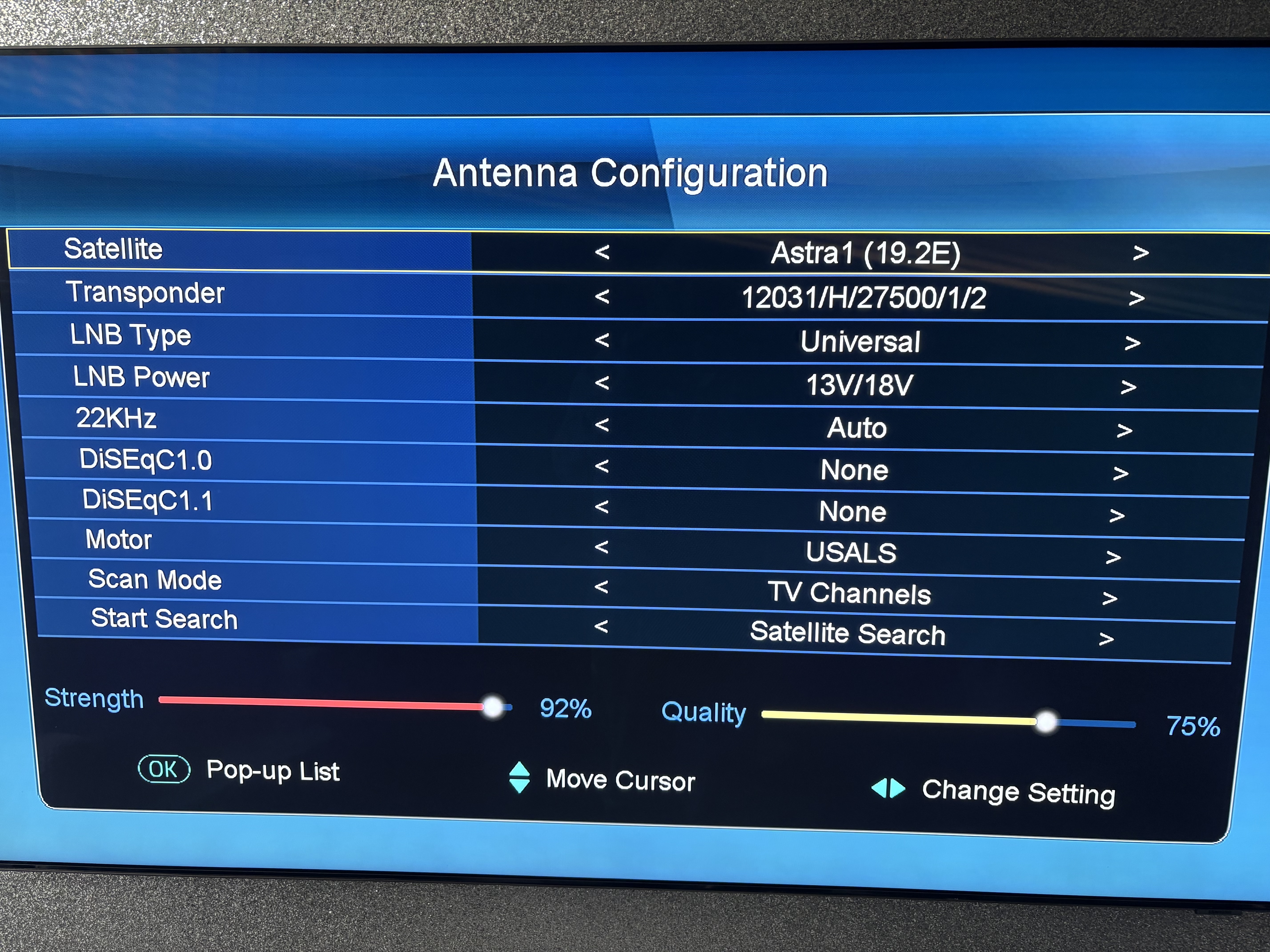

Having a rather weird issue where when I try to scan 19.2 for Pl DE it just doesn’t seem to pick it up. I have good signal on the TP and it seems to scan but just doesn’t scan that channel or any of the sky de channels, it seems to scan 16e channels. Anyone seen this before?
These are my settings on Viark sat 4k box. Picks up Sky sports PL on 19.2e. West Ham v Spurs game currently showing.

Even if you are on the wrong sat it will still blindscan the tp's it finds on the sat you are actually on.
Yeah this just isn’t working for me at the moment.
Whenever I scan 19.2 it picks up 854 Tps and bunch of Them are like duplicates with weird freq and stuff. How can I scan a sat if I get no signal and don’t actually know where 19.2 is? Should I just go to 16e and the move it a little east then scan?

Youll always get duplicates with a blind scan on a Viark well i say duplicates normally the symbol rate is 1 less.
Youll need to align the dish on 19 before scanning if you limited to the box only to try find a sat stick a channel list for 19 east on the box and use those channels to adjust alingment at the dish, youll need to see the tv.

Thanks mate will try doing this somehow
