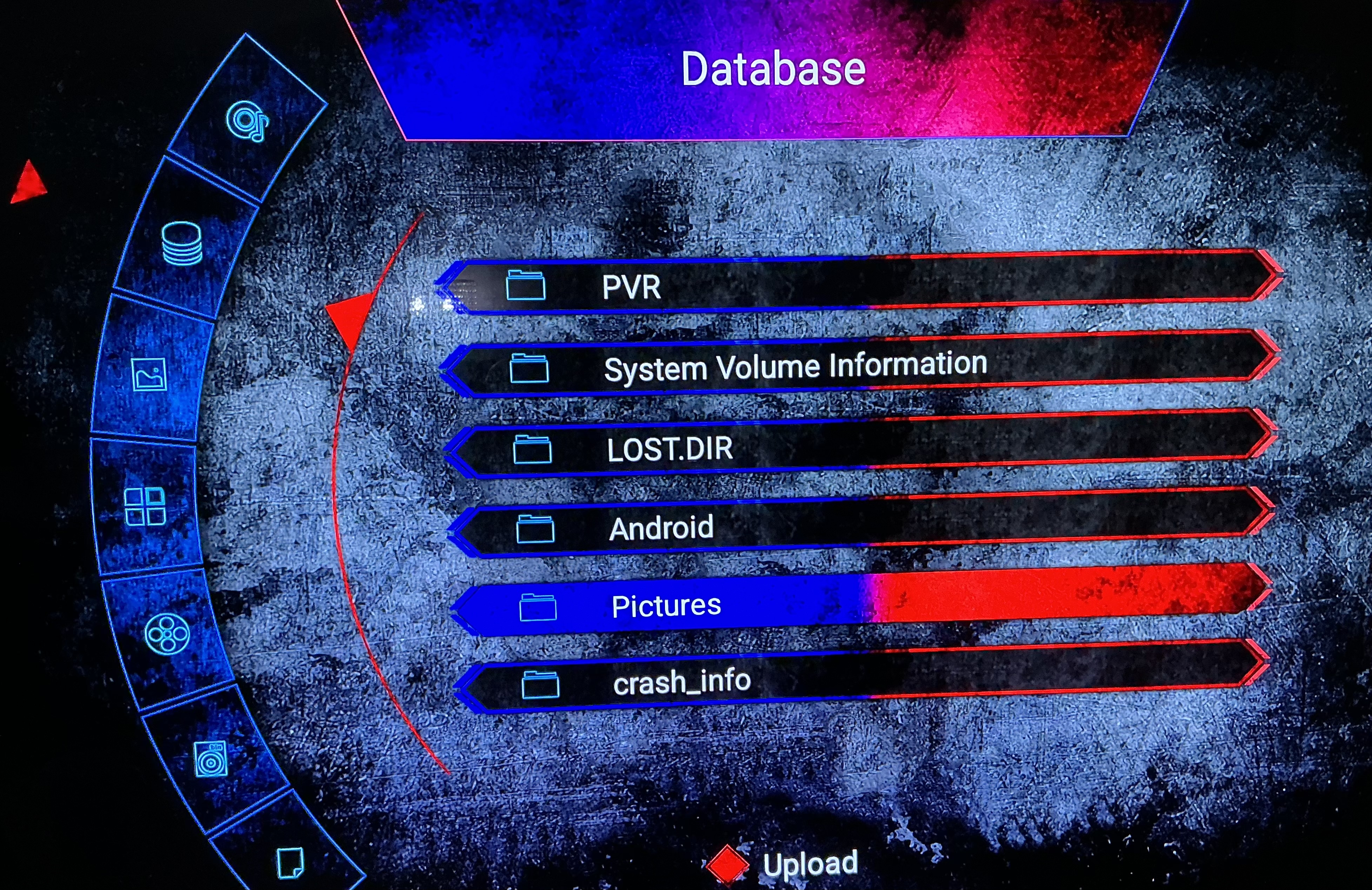

When I go into database I get
System volume information
LOST.DIR
Android
crash_log
Sounds like a corrupt USB device try another USB formatted to FAT32
Just read your message again if you’re at this screen press red button on remote to upload

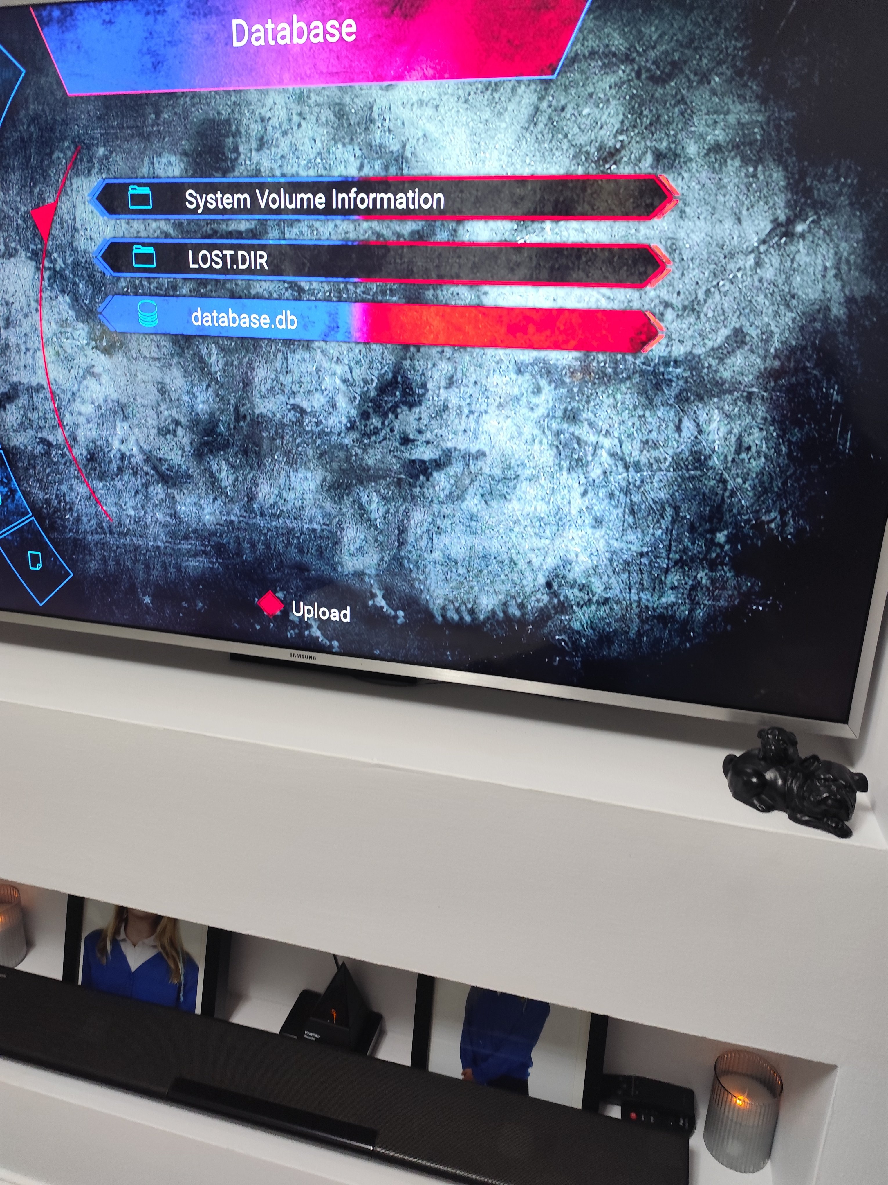

First time ever I'm backing up my channels.
Stuck a usb into the viark 4k.
Went to net & games > USB.
Pressed Yellow to upload and selected channels.
Nothing else is needed right?
