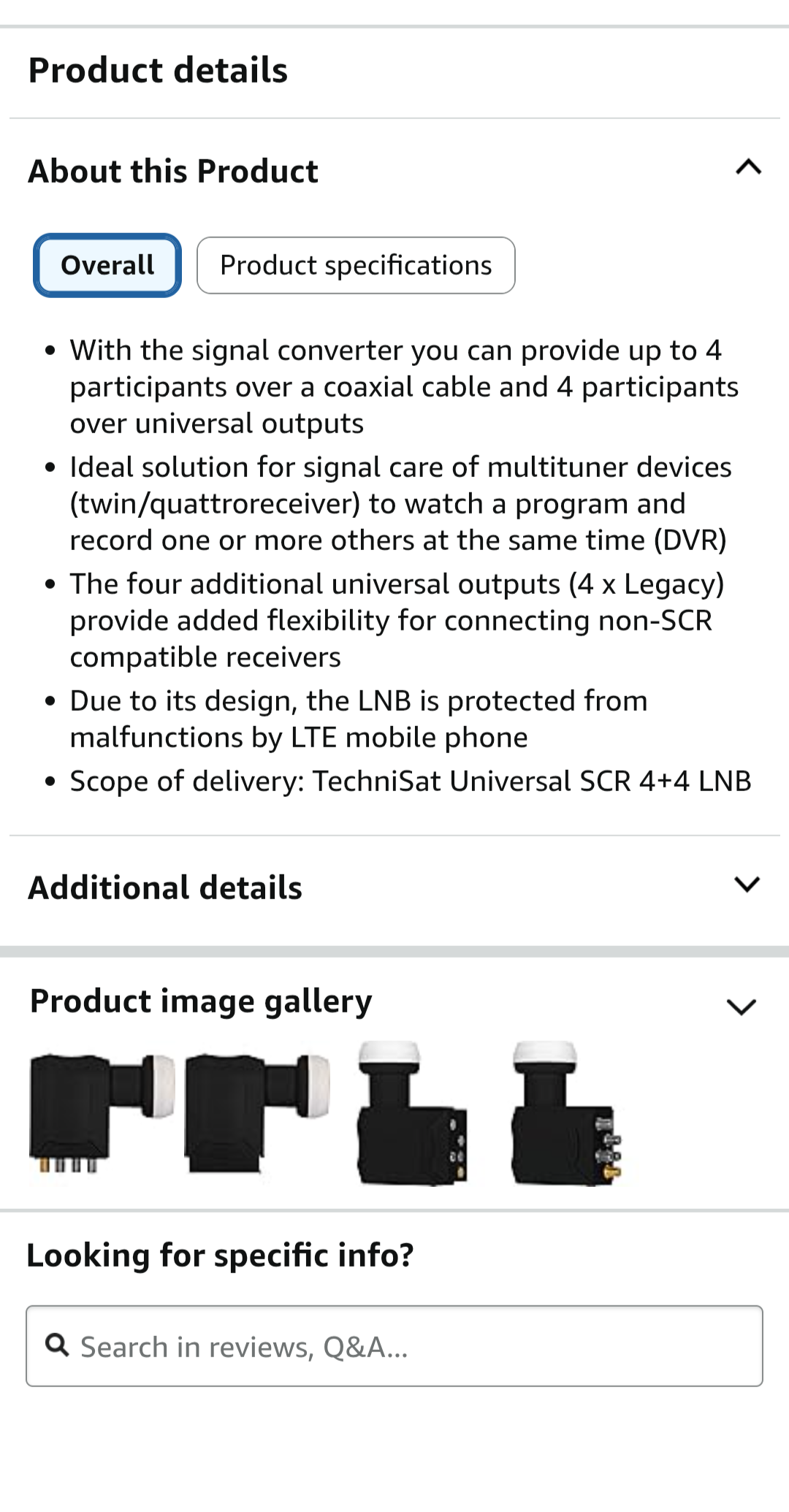

A unicable lnb like this will do ?
I dont quite know yet what 4x4 means.
And what legacy means
It's very poorly worded, it has 4 SCR channels, so only 4 tuners can be independent. It's not good for you. You want 24 SCR or more.
