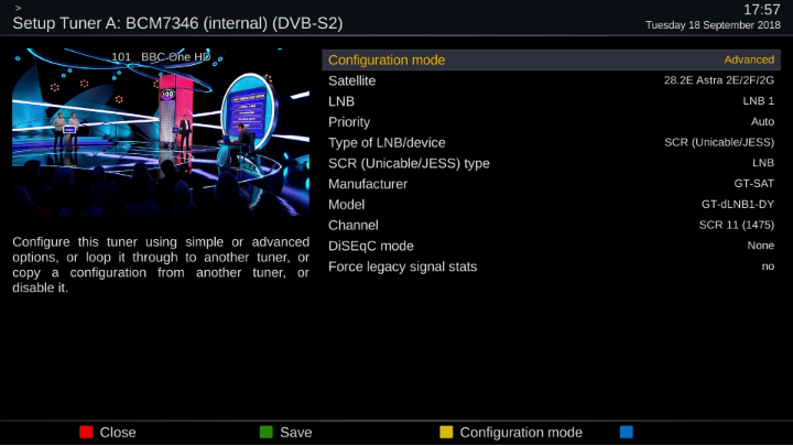

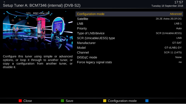

All my standard tuners work fine on unicable. They just need to be setup differently in tuner setup:
This is on a Formuler F1 with standard sat tuners
just had a look on my F1
yep, its there :)
will have a look at the edision OSmini in a bit
EDIT : just checked, it is available on the Edision OSmini as well :)
I wonder if this can be made to work via a diseqc as well,,,,,,,, o_O
