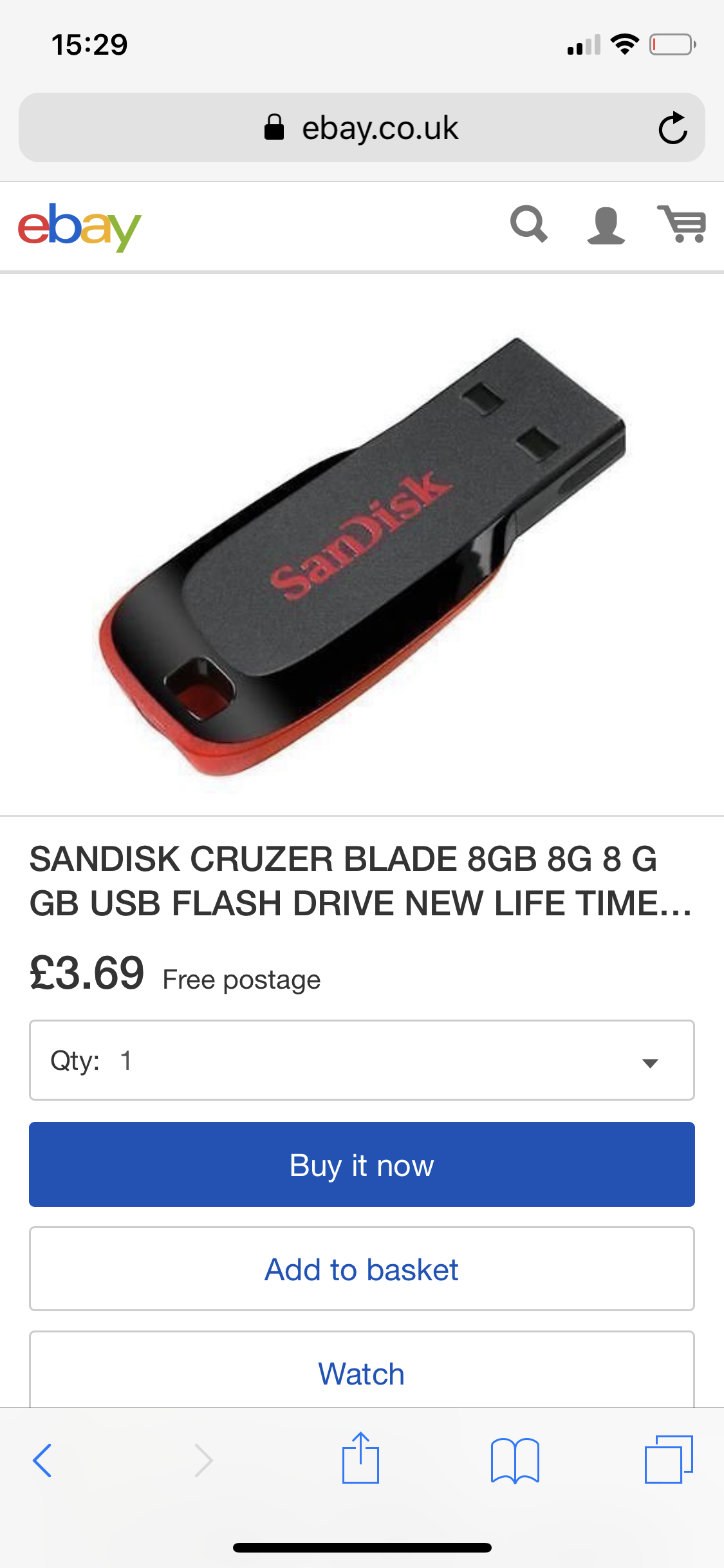

Just tried again using bootice etc, and, once again, red light and boot appears on box. It then proceeds to boot up OpenPLi. Surely it has to be a USB problem, as I seem to have tried everything else. Having said that, it is the same usb I used to load that effing OpenPLi that I am now trying to remove. I reckon I'll go and get a new flash drive. Am I correct that anything up to 8GB is ok?
Thanks again to everyone for their help
Hi, bought a new Sandisk 16GB flashdrive, went through the whole process yet again, and smae result again- it won't flash
