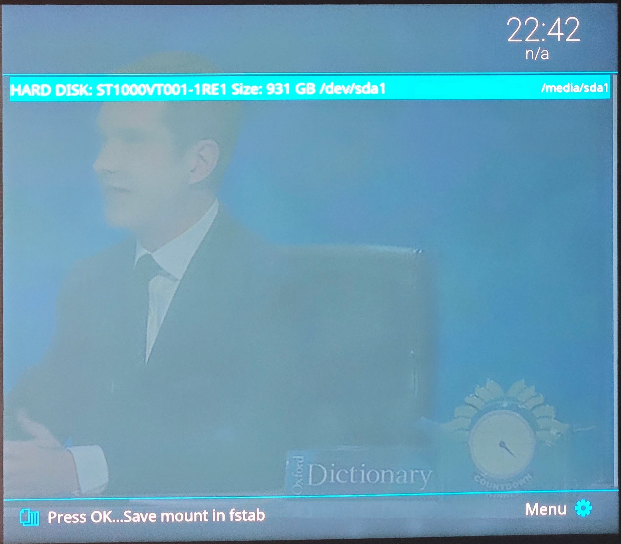

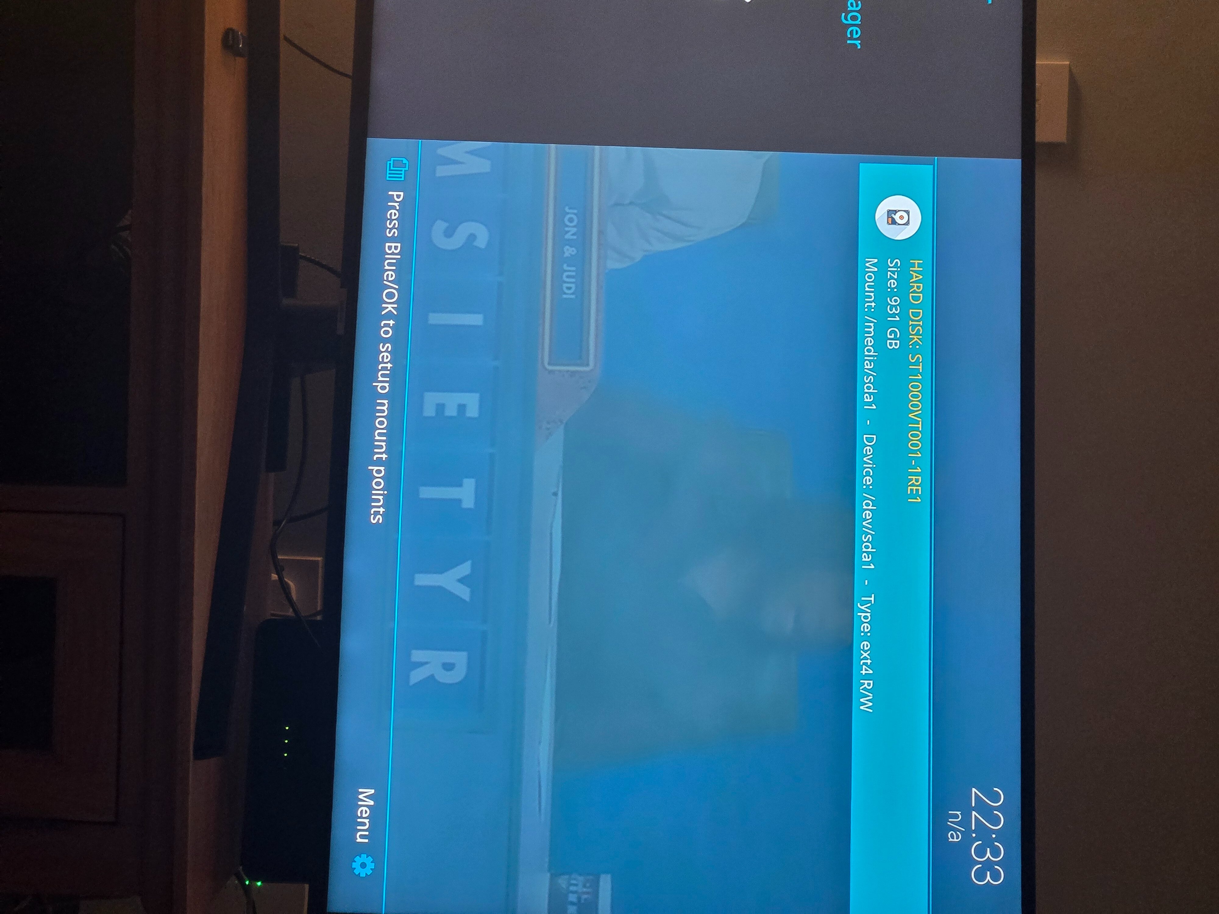

It is just going to show us your storage devices, what they are mounted as and how much space they have.
OK, you have 500GB free on your HDD, so plenty of space. However, it is mounted as "sda1", maybe this is the issue. Can you see if you can change the mountpoint to "hdd". There should be something like "mount manager" in the image.

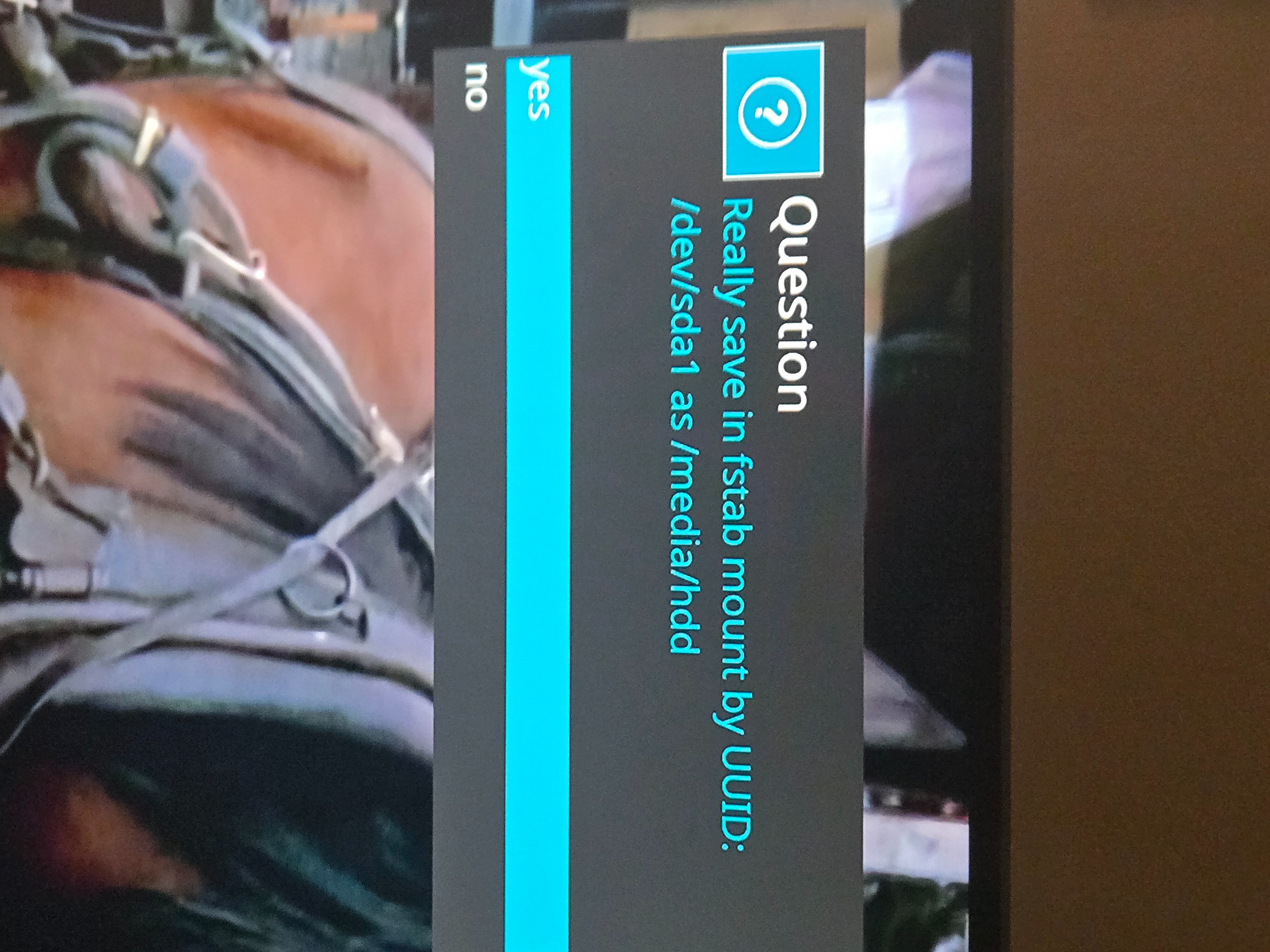

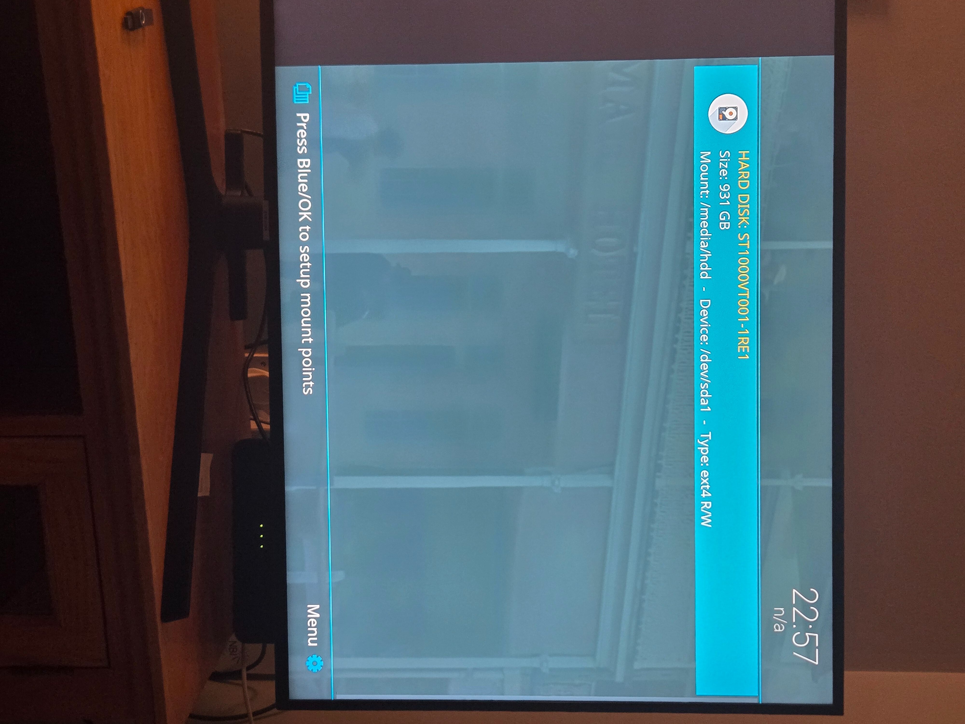

No sure how the change the path to HDD.
Yes, please press the blue/ok button to access the menu for mount points. Then post a screenshot/picture of what you see.

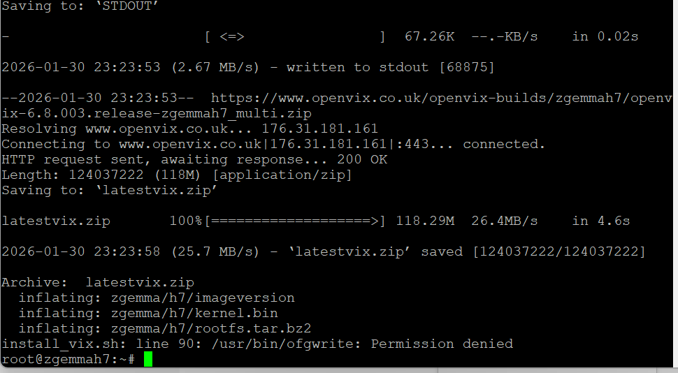

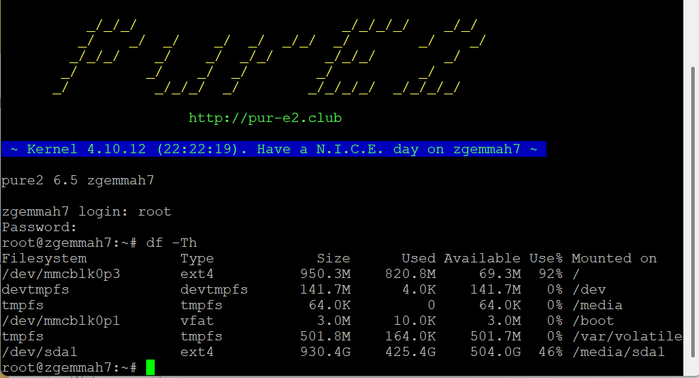

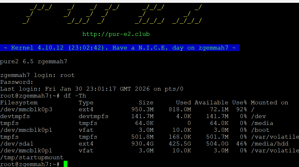

Run the "df - Th" command again to double check, it shoudl be fine. If it definitely shows it as "hdd", run the grog flash script again.
Paste this command to flash. (You did it before already, so you can do it again :) )
Code:
wget --no-check-certificate -O install_vix.sh http://www.willobuild.net/files/scripts/install_vix.sh && bash install_vix.sh
Code:
Went a bit further this time. Permission denied.
