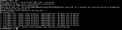

I thought that reinstalling Whooshbuild Infinity might solve my problem but even that won’t load (see screenshot)

the issue in the ops image suggests the internal memory is full which is why f all is working.
Your best bet would be to download and flash the latest nightly build of ATV using a usb stick. Once flashed, remount/initialise your hdd and then either do the wooshbuild or grogbuild freerange setup and you should be good to go.
