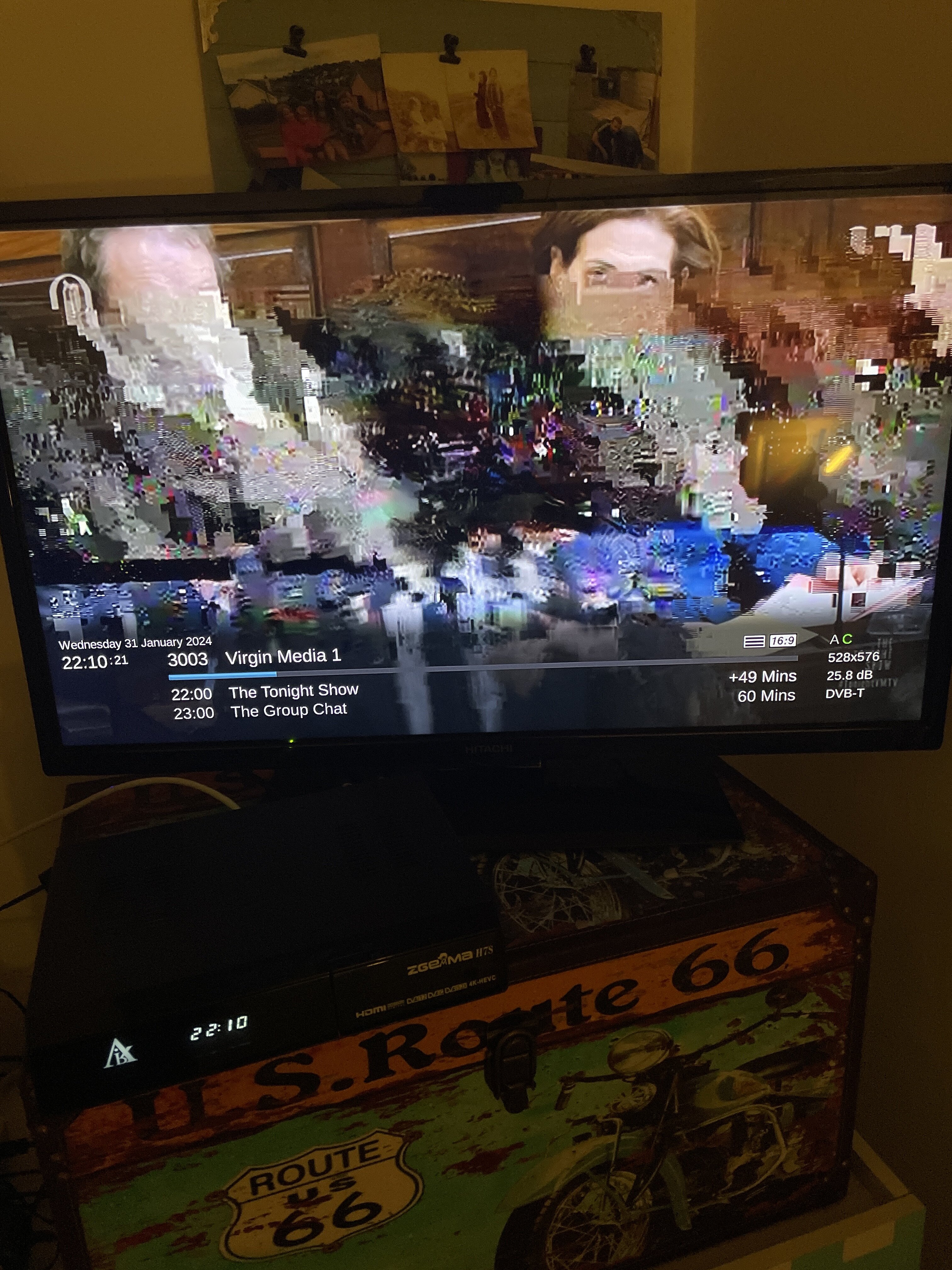

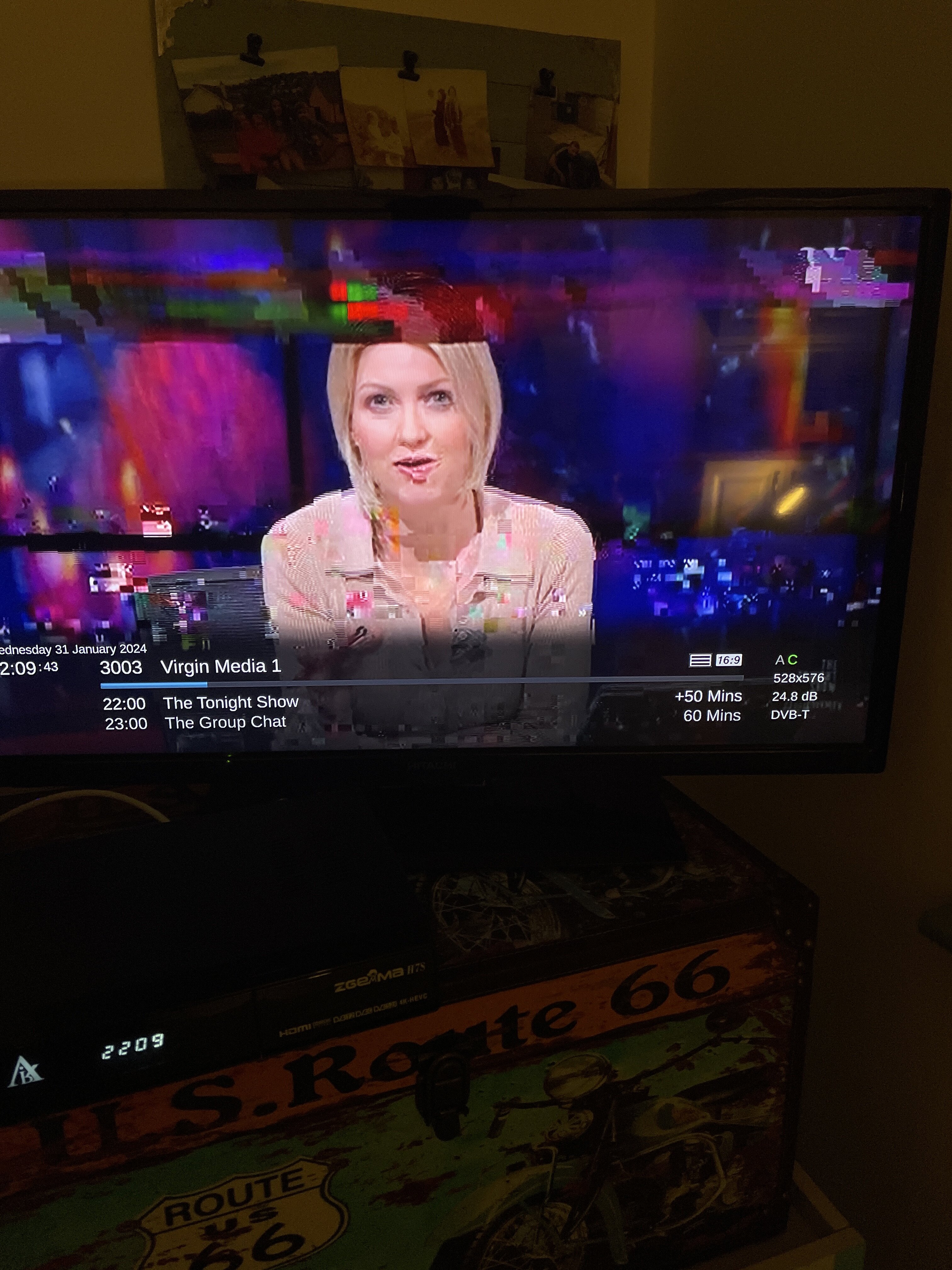

Thanks. I’ve a black skin now. Found it hard to find the Soarview but found them and signal was bad. I’ve changed the configure position for saorview 1st and then FTA and ran a new scan. Hoping that fix’s the issue.
My Soarview channels are very bad now for some reason. FTA seem to be better but a few funny fta ones as well. I’ve disabled tuner B
Are you sure you have selected the correct mast that your aerial is pointing to?

Yes as mast on my amiko box is spur hill cork as well and working prefect in the other room. On image 5.4 it was good on that to with spur hill.
How can I check picture mode.
The saorview epg looks good. Just the bad signal now.
only thing I see on saorview is the db in the bottom corner of pic 3 is jumping all over the place.
