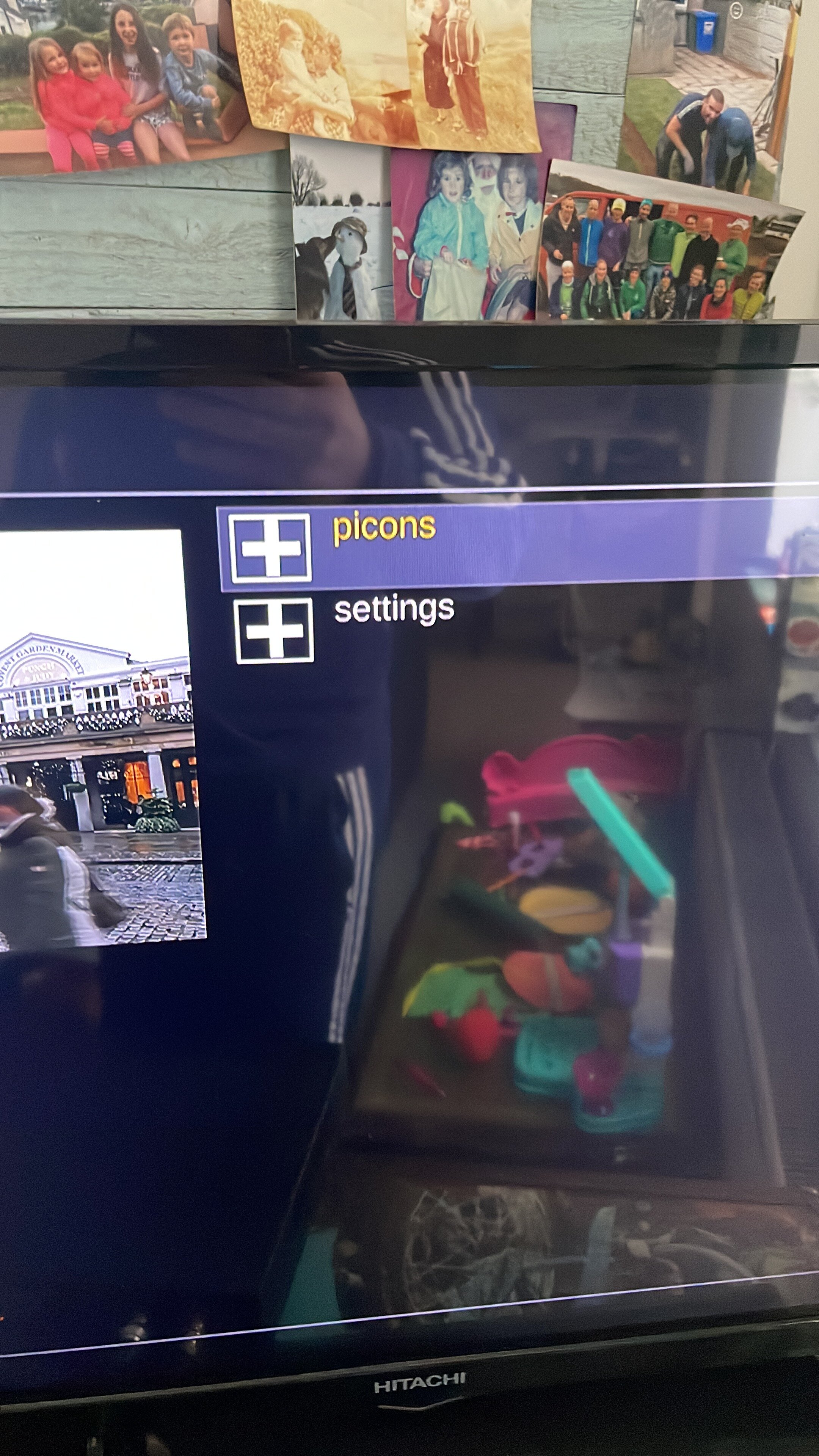

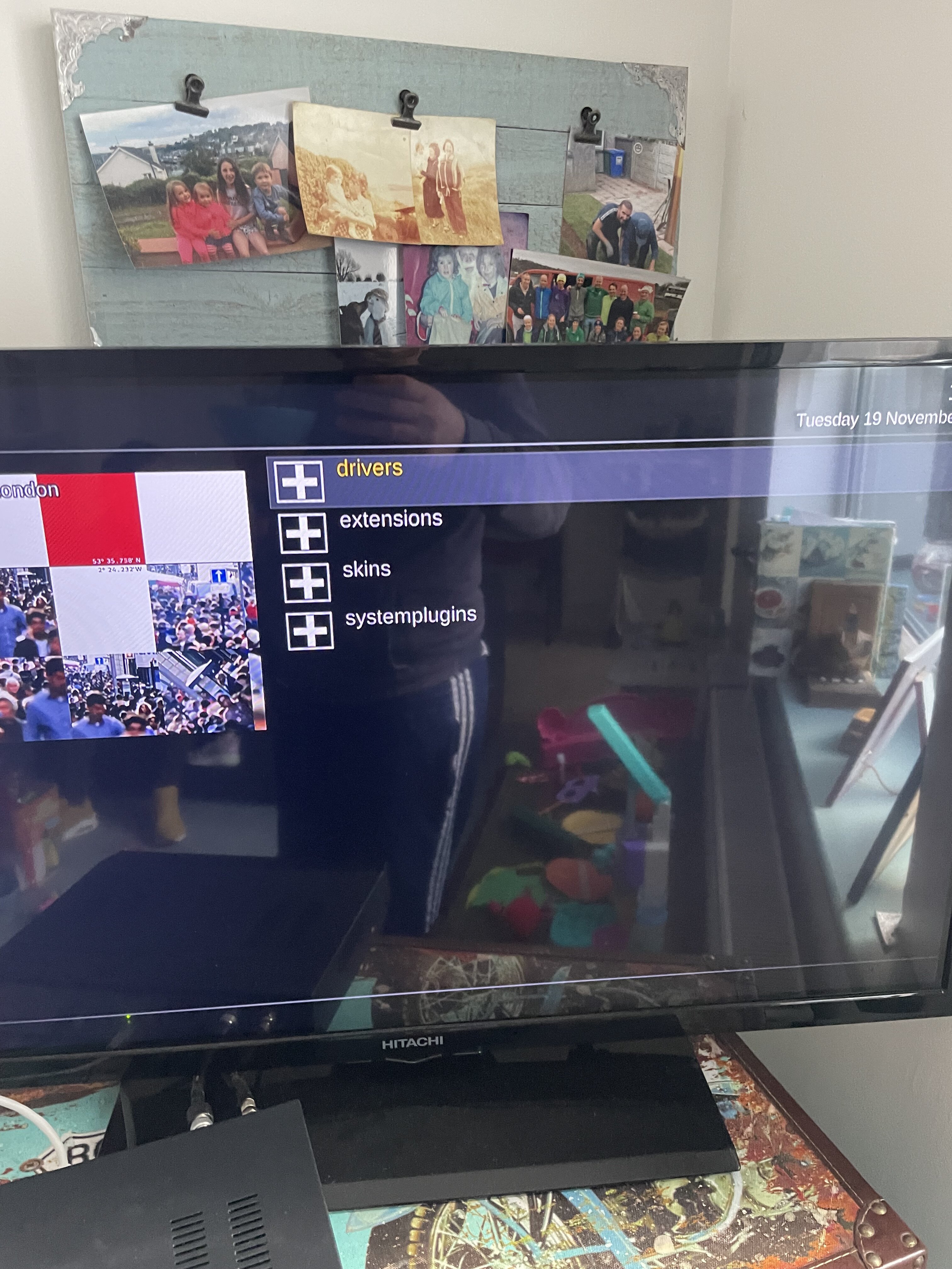

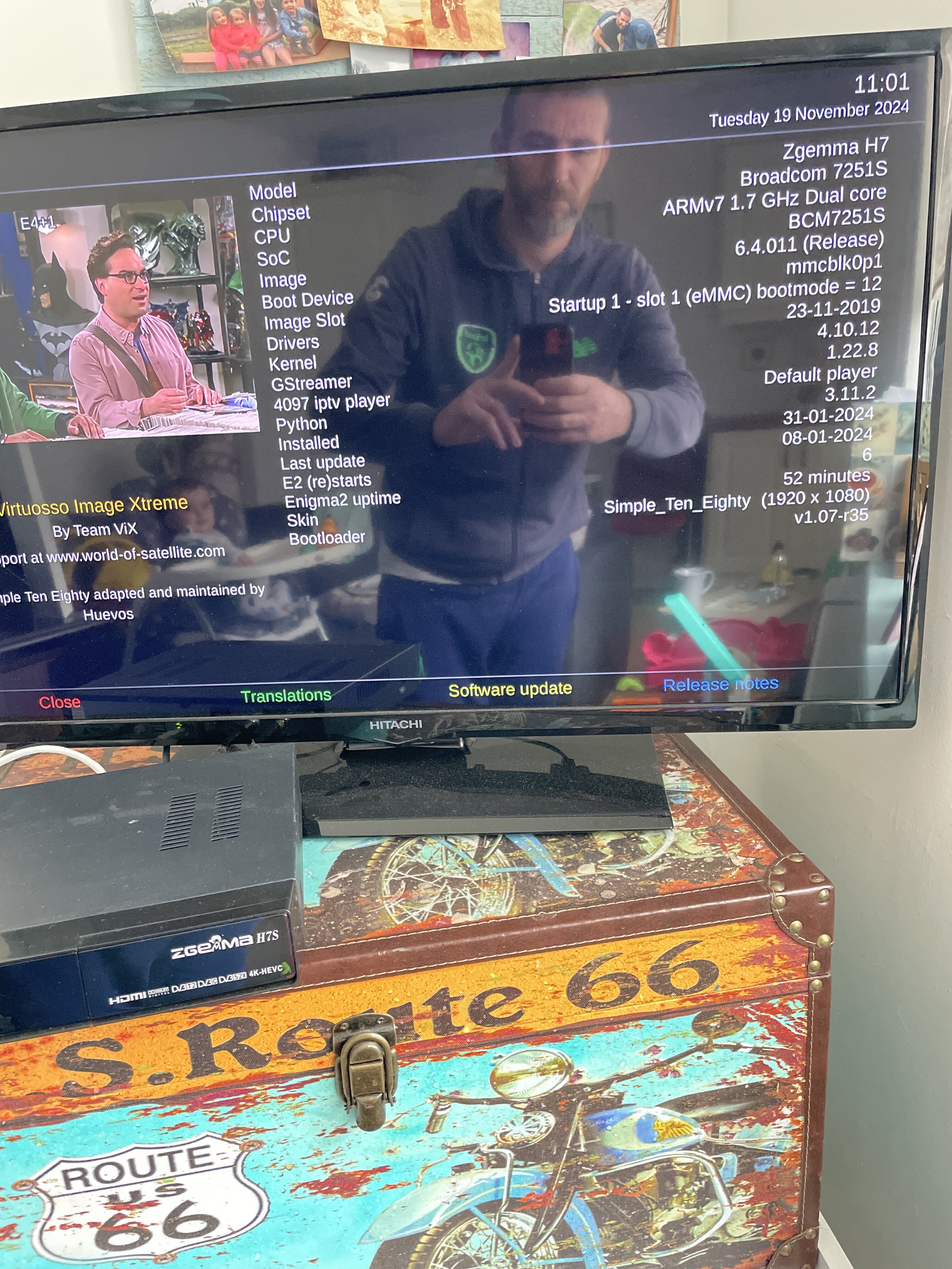

Thanks I thought I was inserting now as thumbnails and they should be better. Sending from my phone. I do understand bad pics are annoying šŸ¤¦ā€ā™‚ļø hope there coming up better if not Iā€™ll read again and do a check.
yes last images were certanly better , but we are talking actuall screenshots from enigma2 you can also get openwebif on your phone by just typing reciever ip address into search :smiley:

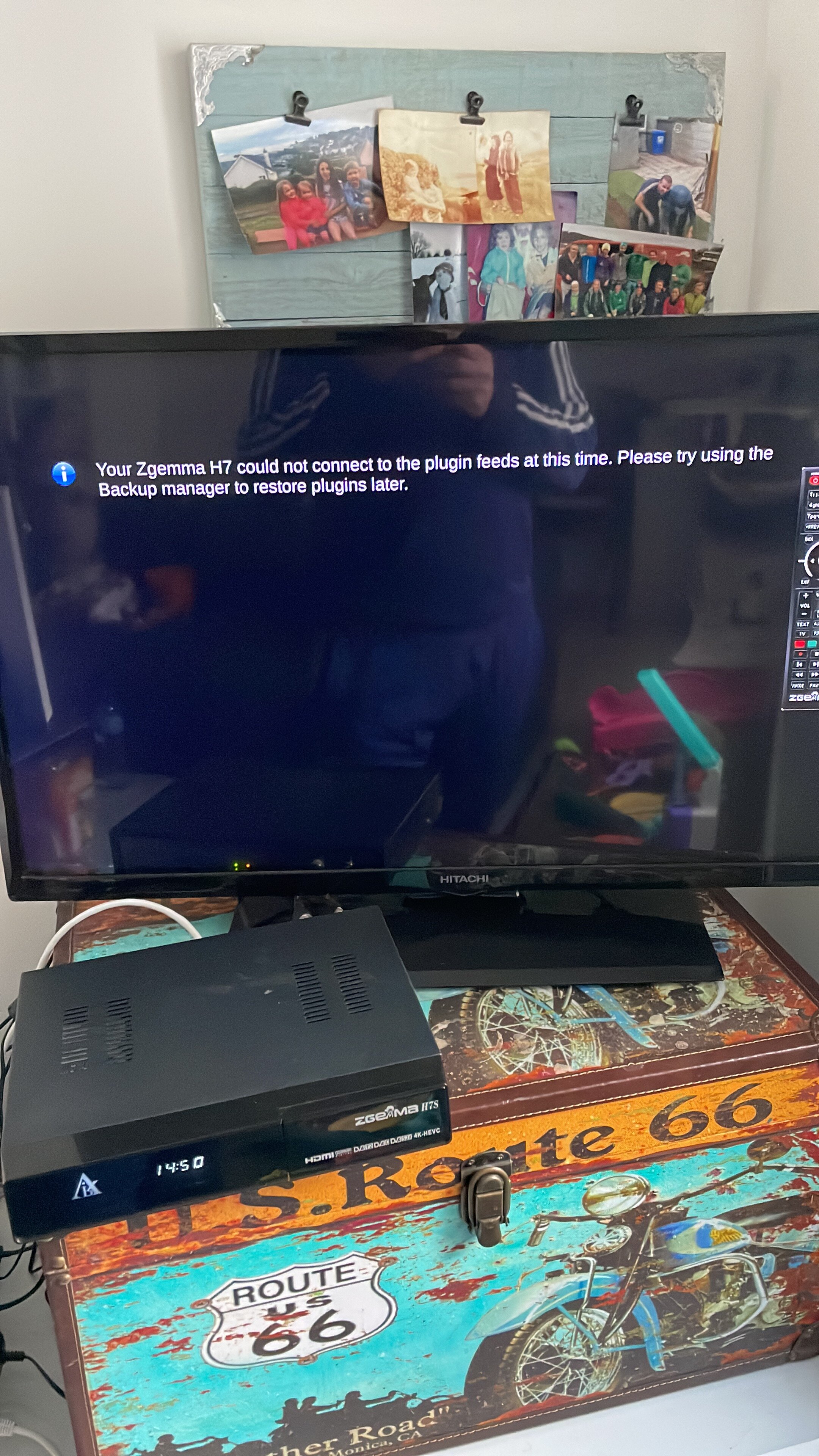

Signal finder just checks signal, it is the scan that you did that solved your signal issue. If you are still using Cork in ABM, next time ABM runs, your problem will return. So please change your Saorview area region in ABM to Kerry MULLAGHANISH.
Disable the following options too: FTA and FTA HD. Reason being- Saorview and Freesat are FTA only. The HD bouquet will be fine. Please also enable the channel swap option.
Before you remove the internet connection, please install Terrestrial Scanner plugin. Don't do anything with it for now.

Iā€™ve changed the the location in all spots including ABM thanks. I think I have disabled FTA as well but will double check I will enable channel swap (what do this do , allow swapping between saorview and free view ? ). Iā€™ll add the plugin to.
The epg seems to be good and the standard skin actually is ok on the eye.
