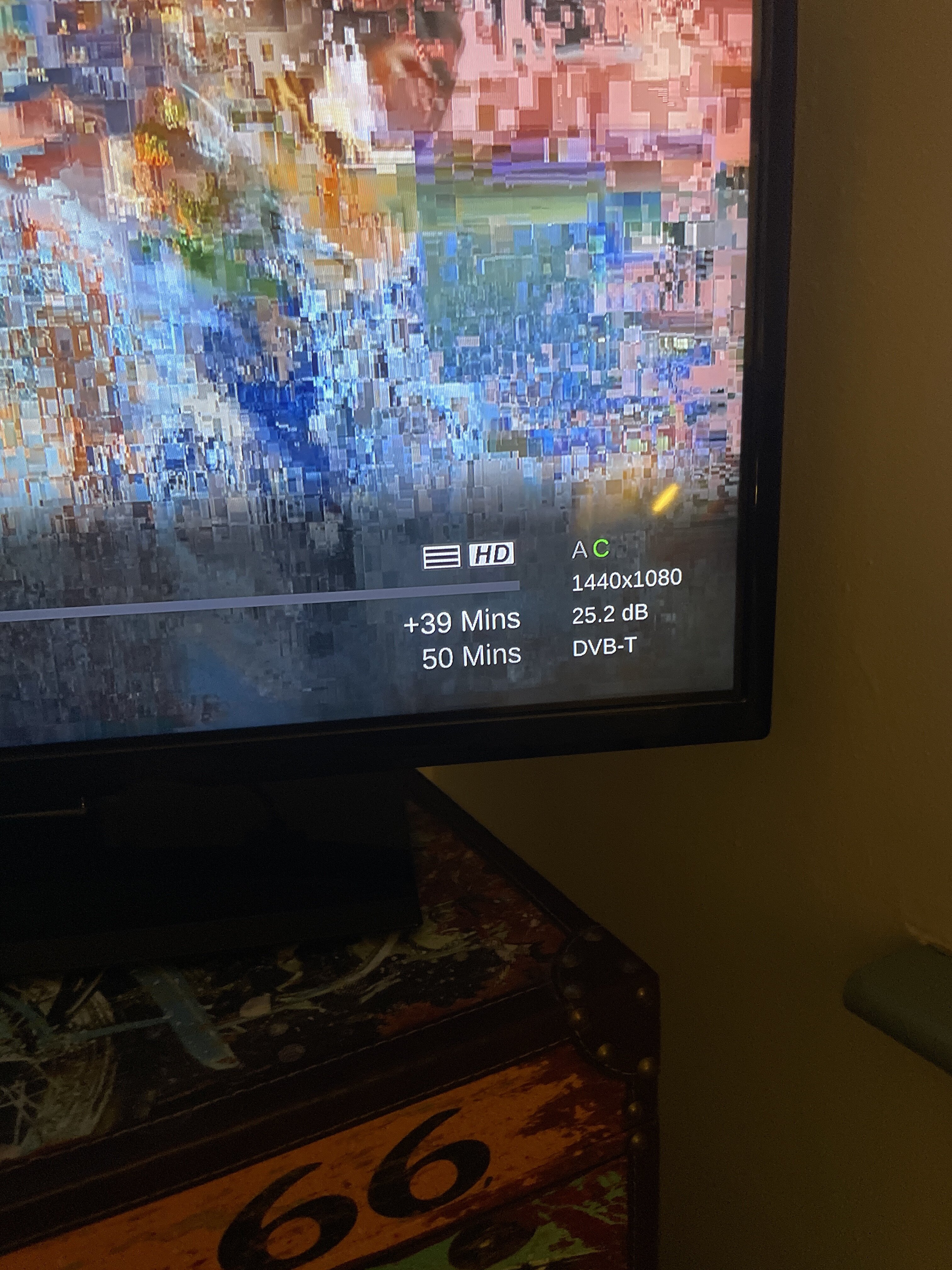

Pixelation is a signal issue.
Either your aerial is out of alignment or cable damaged, failing that you have chosen the wrong area/region.
Did your tv have signal issues like the above before you got the H7?

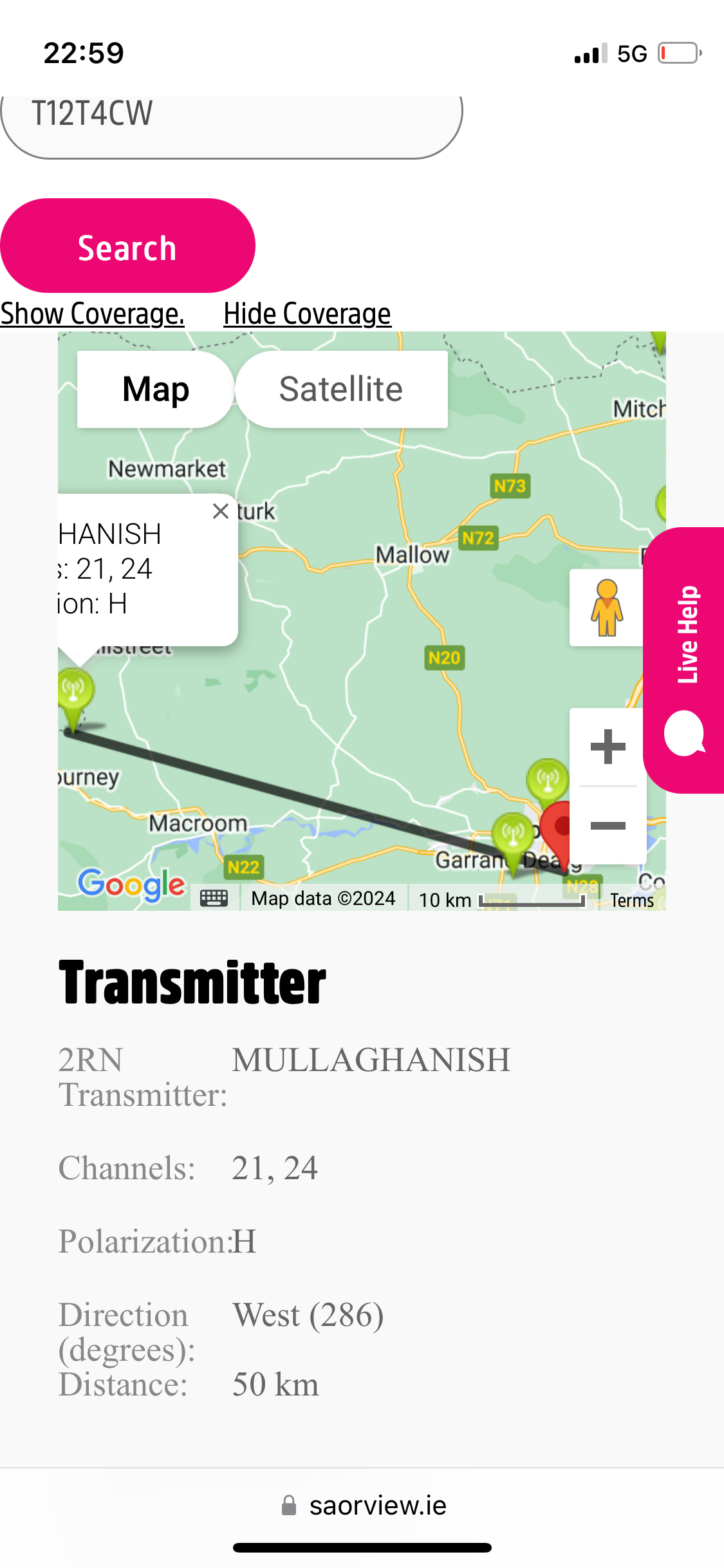

Don’t think my aerial is out of alignment but on the check @bmitie said the area is coming up pass spur hill nearly going through it to Mull but that option isn’t in the area /region IMG_7607.png
Go to your saorview tuner but go setup settings tuners then signal finder then
toggle , use arrow key on right to select tuner c, arrow down to c21 and change it to 24 and wait if u get a signal press green to scan, do same for other channel .

The only thing I notice is the db down bottom corner keeps moving all the time. I even tried on the Kerry MULLAGHANISH like the coverage checker says IMG_7610.jpegIMG_7609.jpegIMG_7608.jpeg
I have got other FTA that cork now but not all on spur hill. Others still don’t work. I’ll have to come back to it tomorrow. Only something small I hope but annoying none the least. Thanks all

Everything seems to be working now. Once I changed the channel no. To 24 and went with Kerry MULLAGHANISH in signal finder it seemed to work 🤞

Right, well forget the Cork transmitter, it seems you need the Kerry one, see if you can find out the signal strength from there in the menu. You still need to find out what condition the connectors are in from splitter to H7, this is more important than anything else at this point and can you get freesat?

only thing I see on saorview is the db in the bottom corner of pic 3 is jumping all over the place.
View attachment 99004View attachment 99005
Your showing around 22-25db signal, that is a strong signal. It possible it is intermittent, caused by a poor corrector.
Snip the cable off, re do it with a new end plug if possible.

Yes can get freesat. Just rechecked this morning everything is going good still. Connections are good. I believe it was a signal issue only with saorview as I had wrong transmitter and channel setting in signal finder. 1st 2 pics my amiko box and working prefect. 3rd and 4th pic my zgemma and all good this morning 5th pic shows db better settling image.jpgimage.jpgimage.jpgimage.jpgimage.jpg
I think the changing channel in signal finder fixed this as it had been dropping to 0 and 12&15 prior. At least I’m hoping it has but was all good this morning before I went to work.
