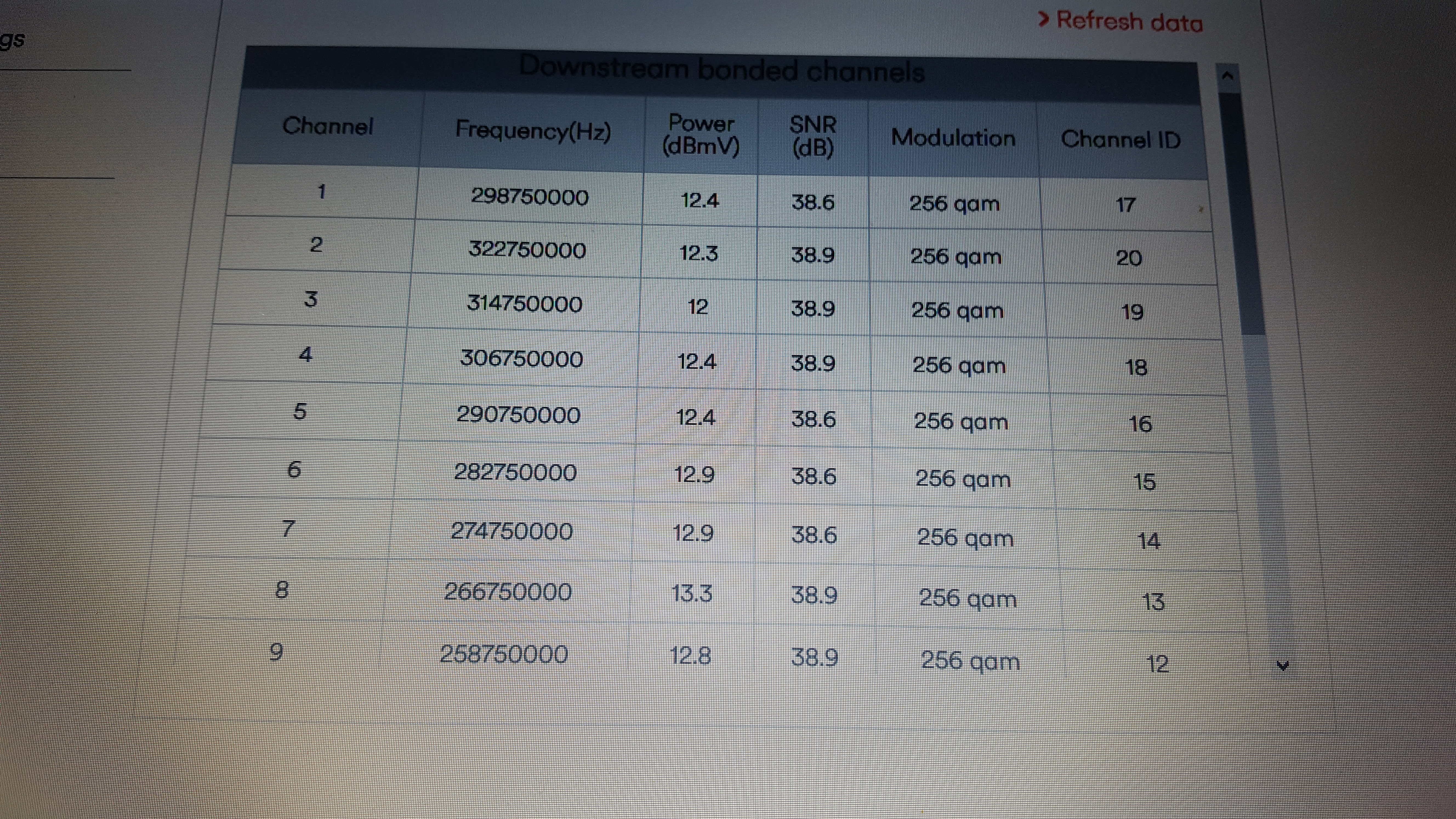

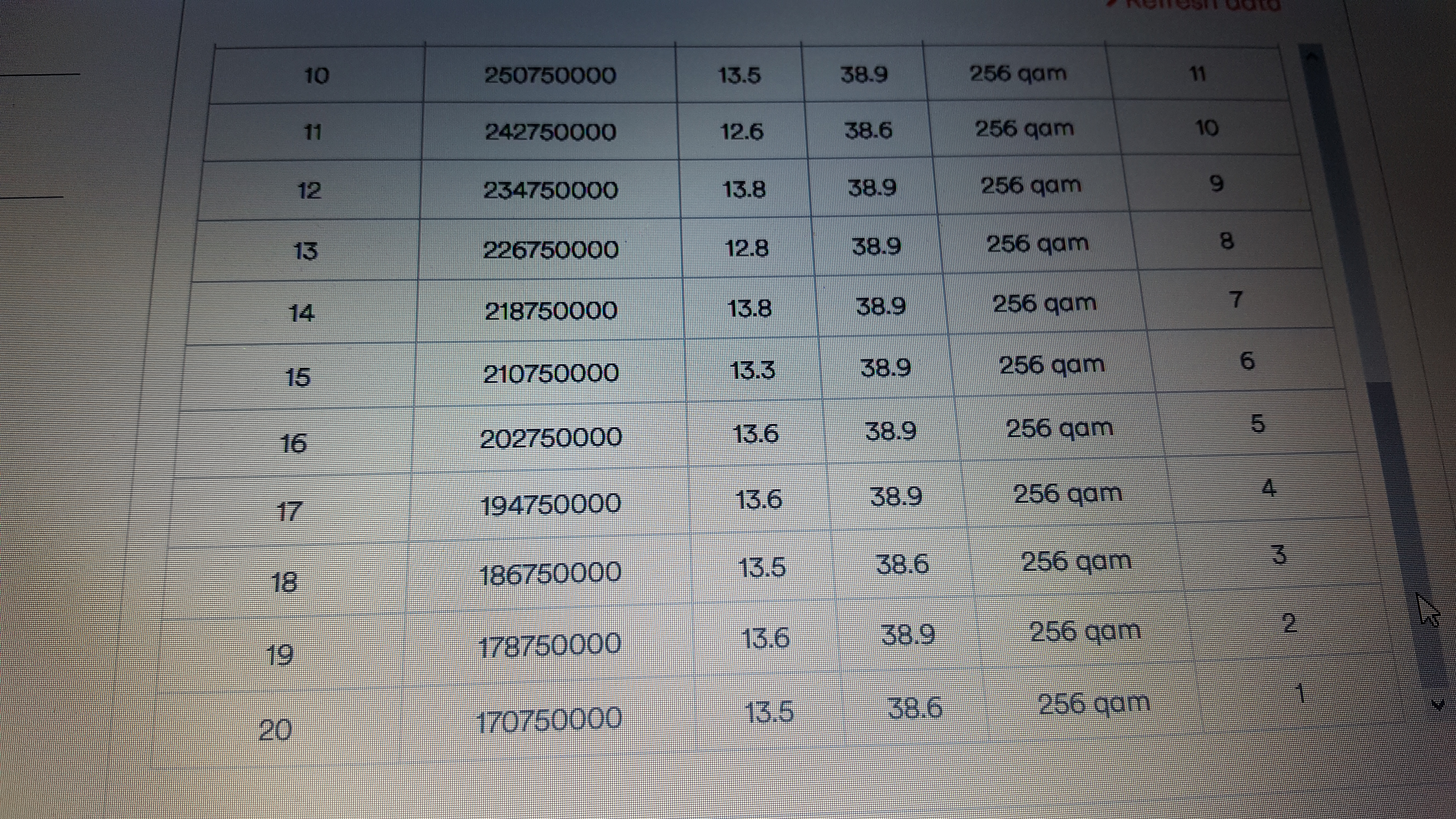

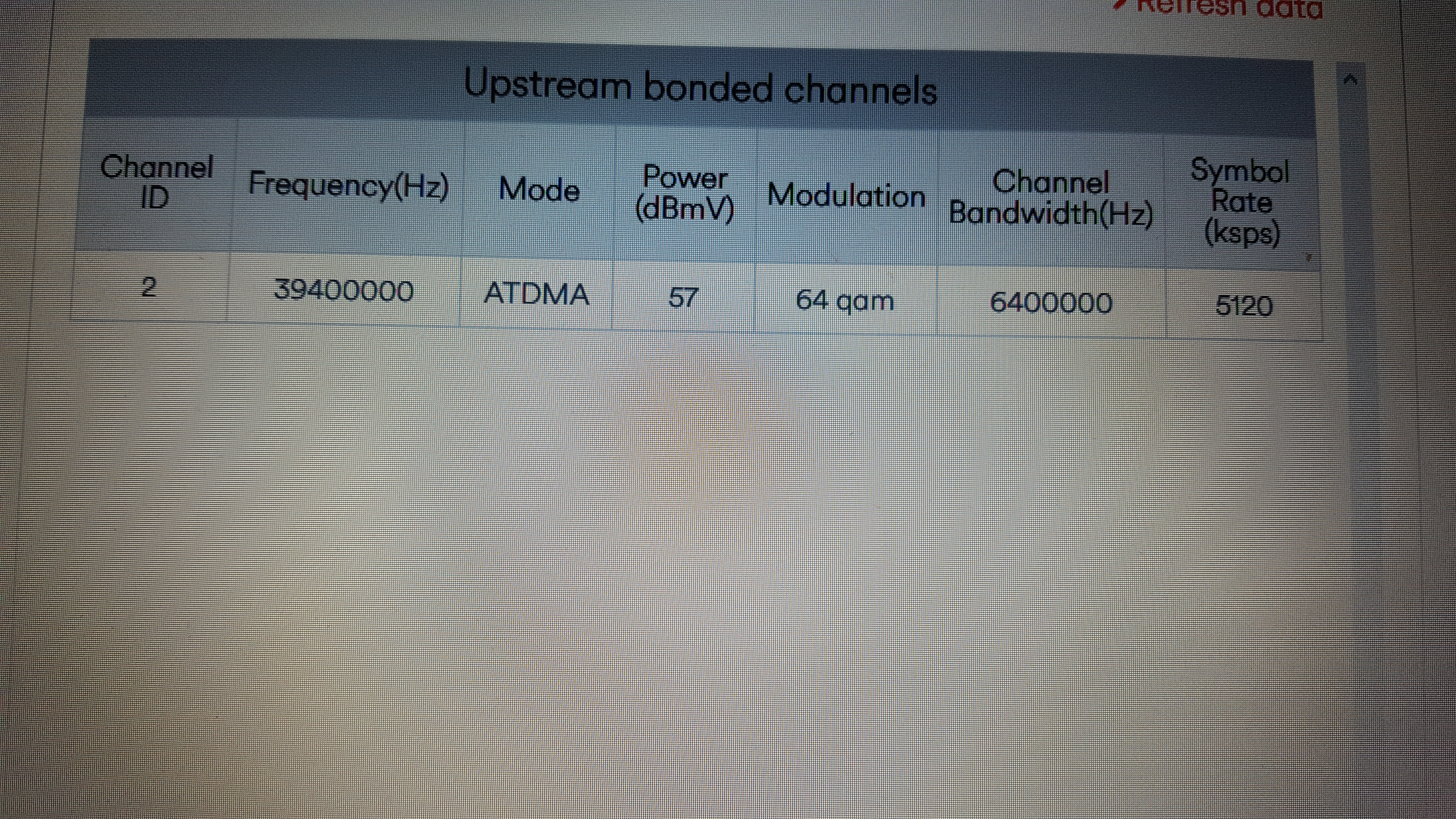

Hello everyone i have a few channels where the signal fluctuates, i've read a few posts that it could be the downstream levels causing the signal issues. Could anyone have a look to see if there ok thanks.
Hello everyone i have a few channels where the signal fluctuates, i've read a few posts that it could be the downstream levels causing the signal issues. Could anyone have a look to see if there ok thanks.View attachment 27431 View attachment 27433 View attachment 27434

Alright bud do u know what the downstream levels range should be.
+10 and -6 Downstream should be in the range so signal level is a bit high and requires it to be moved down in the catv cabinet. Always looking for it to be close to 0 as possible. SNR should be greater than 34.
Is it best to contact vm, get them to sort it.
An attenuator would bring your levels down.
I've connected a 3db forward path attenuator to the back of the router, it seems to have lowered the levels down abit, do u think I should try a higher attenuator cheers.

As long as it's within range of between -6 and +10 it should be fine.
What db attenuator would u go for though bud if I was to lower the downstream levels in the pictures.
