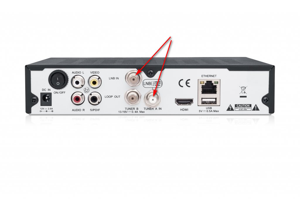

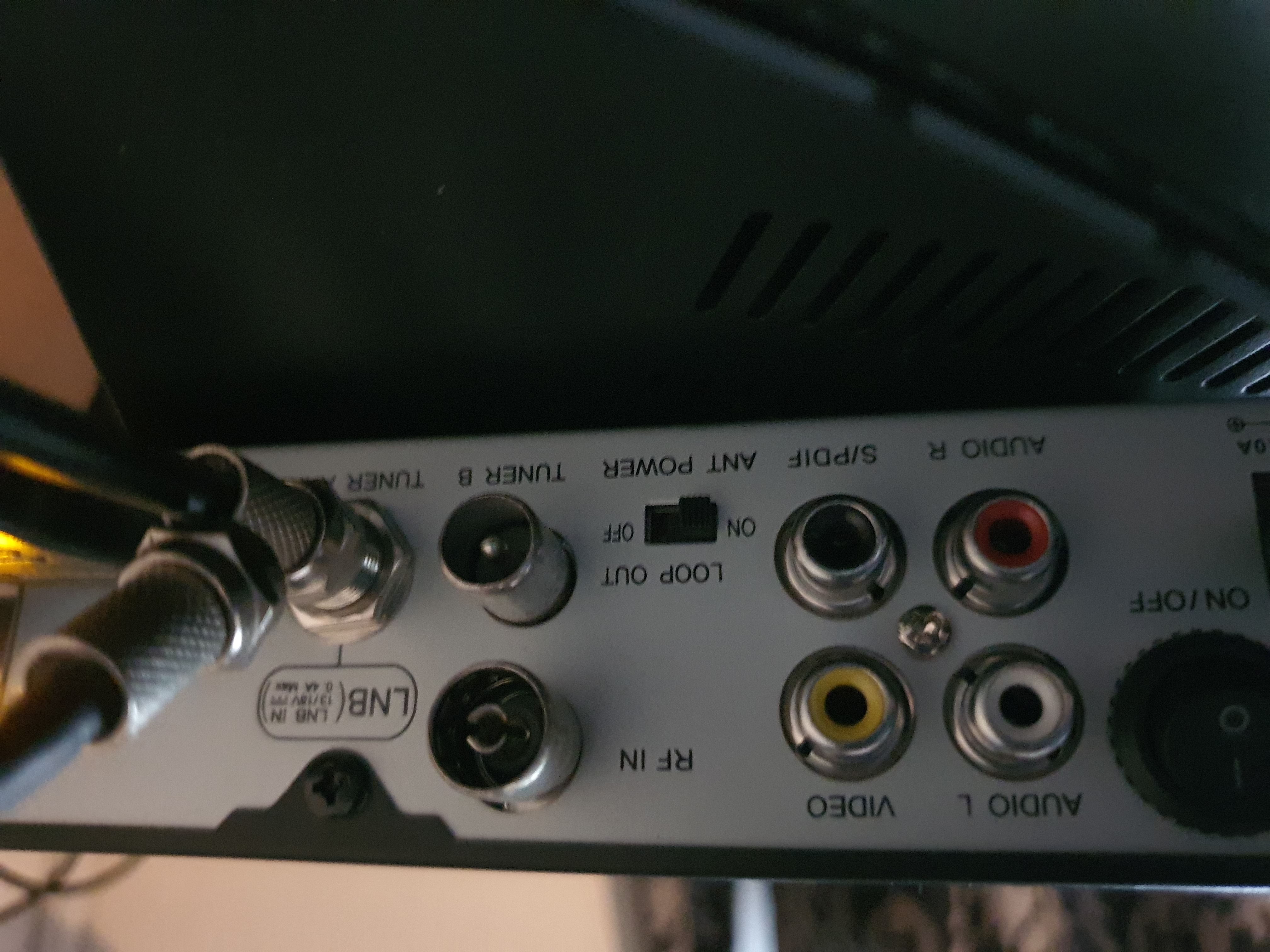

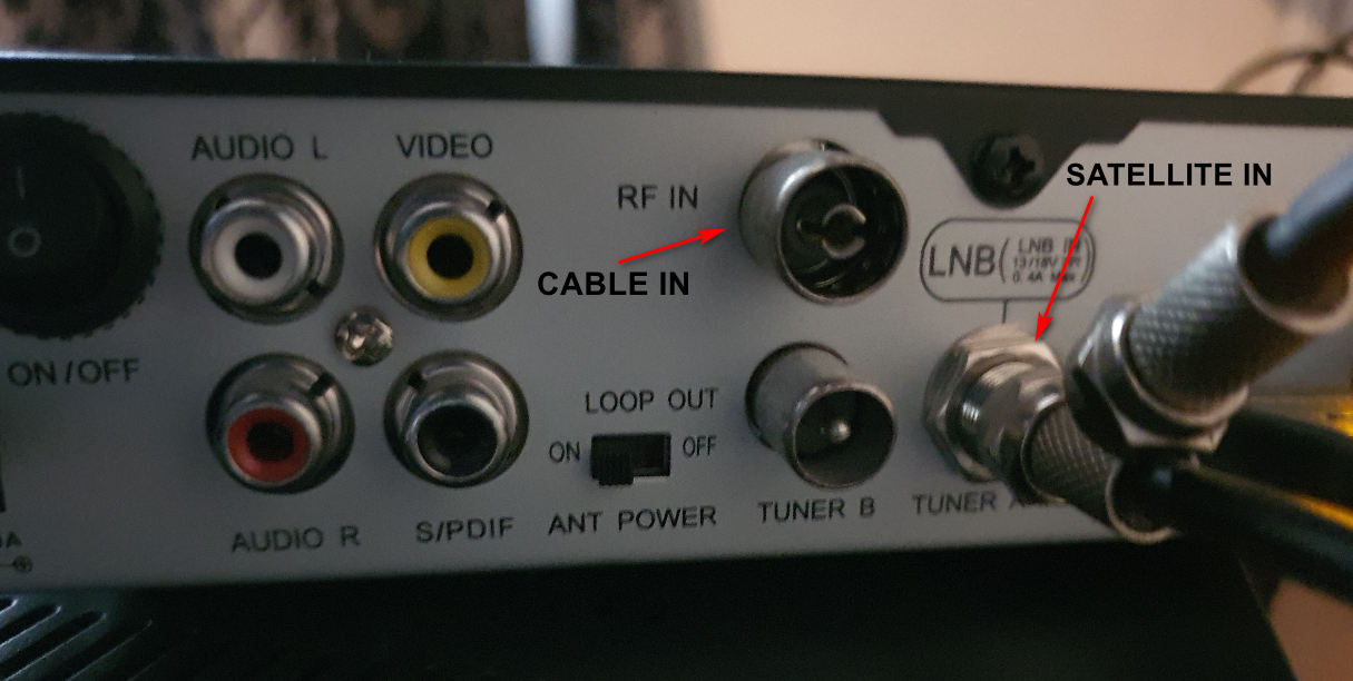

Hi i tried scanning for vm channels last night it's won't pick up any I have 2 connection tunber B and rf in not sure which one I am supposed to use
Thanks bud I thought so I think my tuner knackered that's the connection I have been using I have downloaded open atv 6.3 on it and for some reason it won't find. Any channels I don't have the vix software for it anymore box is evo nova combo is there any alternative software available I can try may be its the build

VM is RF in - usually you need a F adapter to screw onto the end of the vm cable then into the RF in
