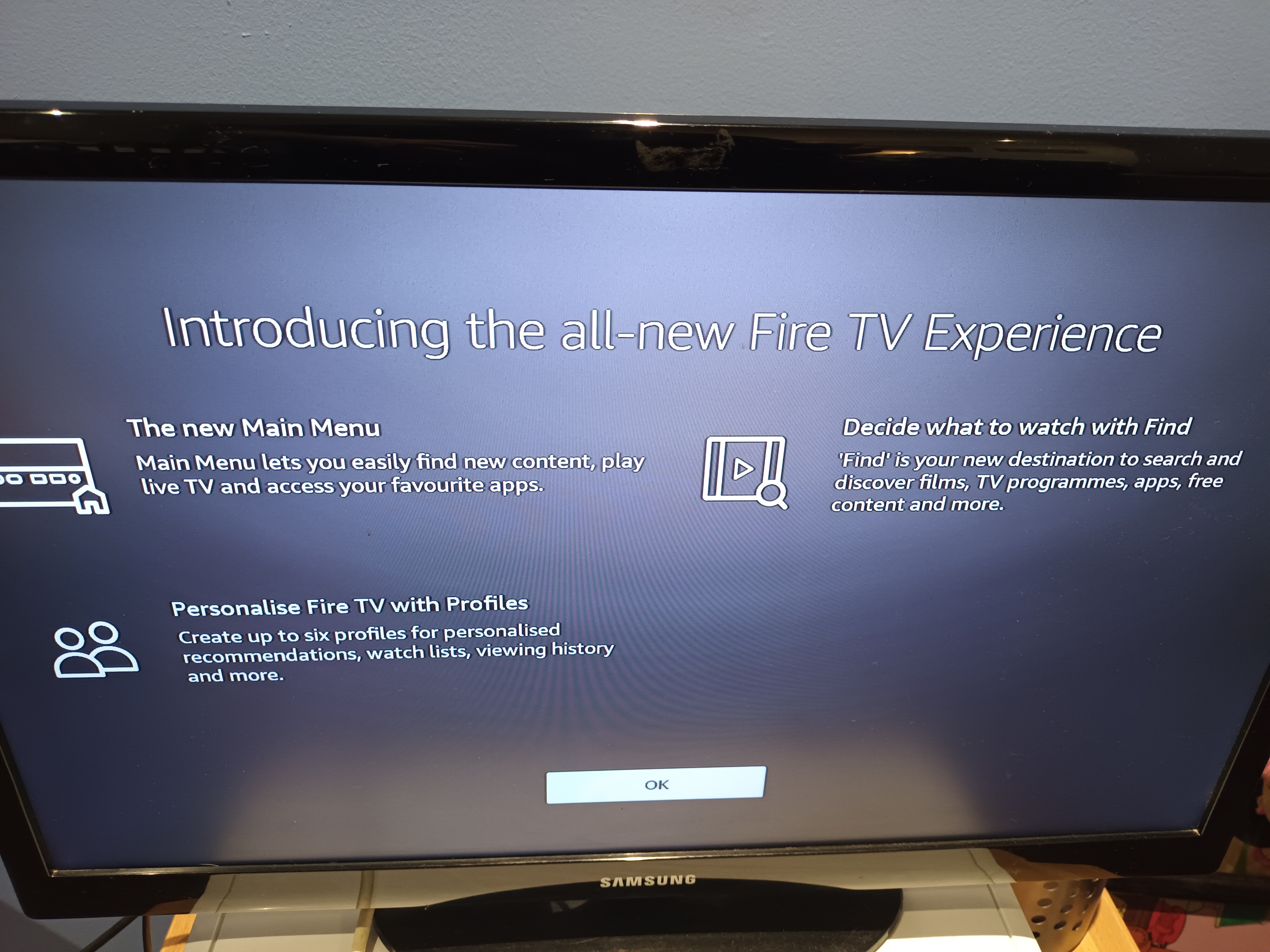

Put new batteries in the remote and pair it as a new remote. Hold down the house icon button for 30+ seconds then try.Remote not responding after a update I have tried the usual stuff but no joy .
This is the screen I get any help would be appreciated thanks in advance. View attachment 70809

Have you tried using your Samsung TV remote to operate the stick?Remote not responding after a update I have tried the usual stuff but no joy .
You need to go into firestick settings and enable hdmi cecHave you tried using your Samsung TV remote to operate the stick?
Could do that using the phone appYou need to go into firestick settings and enable hdmi cec
I cannot use the phone app as I can't get the code it's asking for .Could do that using the phone app
Use the phone app to set up CEC , then you can use your TV remote to control your FSManaged to get the app on the phone working code appeared on the screen but still no joy with the remote as yet but will persevere.
Thanks for all the help.
