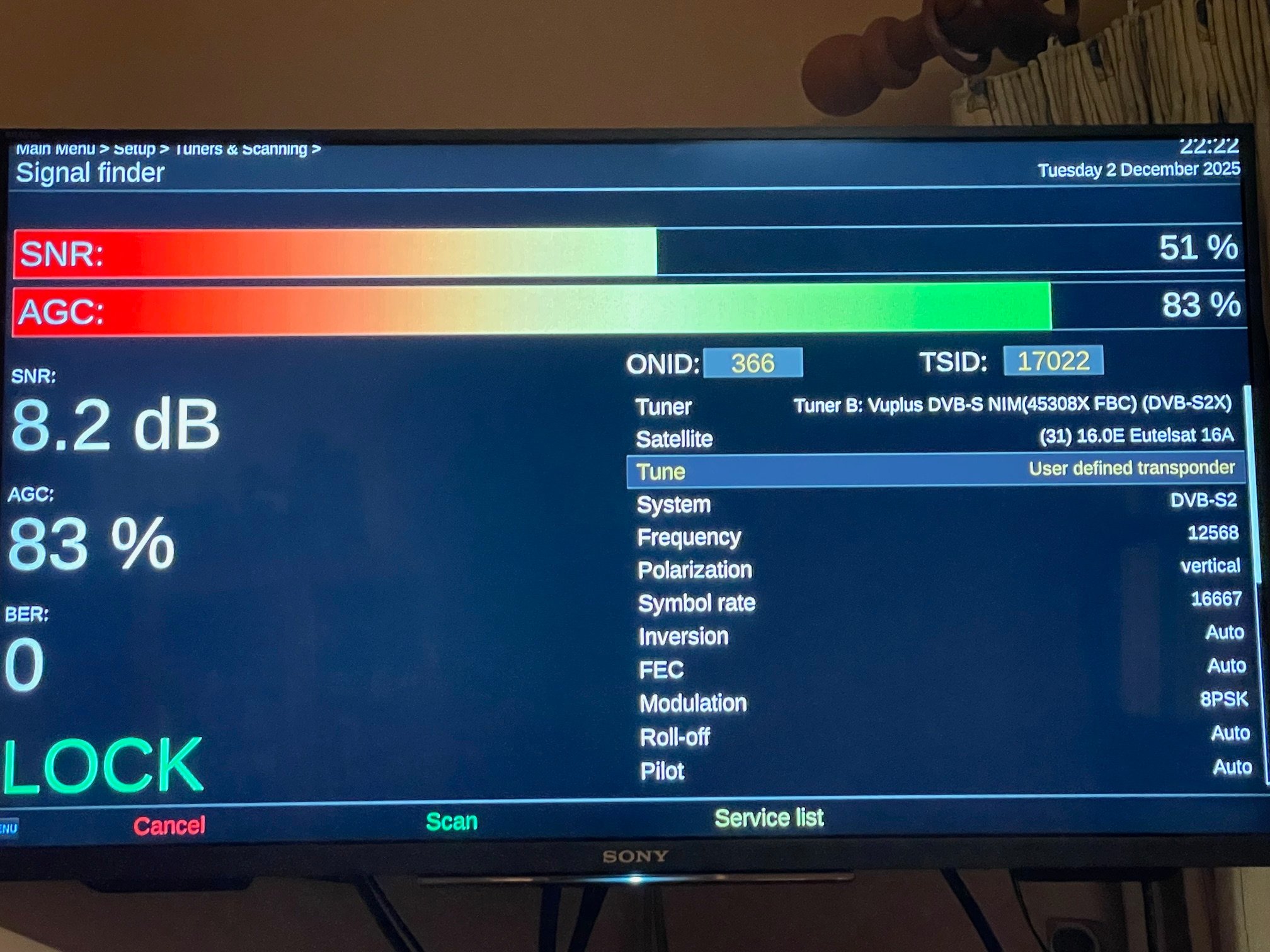

For FTA on 16e use 125668V 16667SR 3/5 dvb-s2 8psk
you get loads but ACASA GOLD is first and you need 16e for Thursday.

The reference I quoted for the orange light is from troubleshooting and its not a diseq command as box is now correct. Try 16e tomoroow and put in acasa bit, ie drive to SS1, then go menu setup tuners signal finder toggle tune to user defined put in as per pic then signal will appear if you are on 16e green to scan.

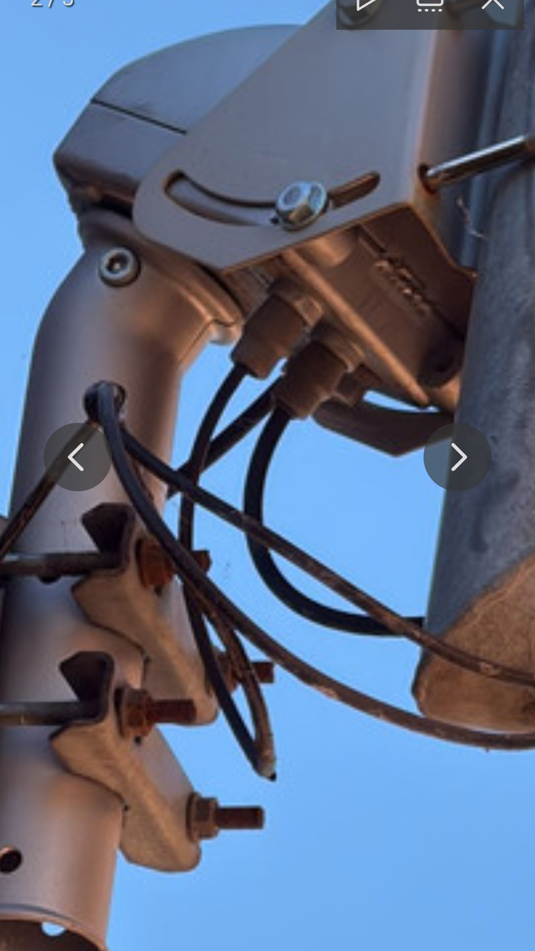

I had a look at the pic that shows motor up close and the cable going to motor input had black tape wrapped around it and i cant fathom out why. the cables have quite a few swirls and as for putting the cable through the hole in the stub....
a lot of these motors get stuck and the idea is to figure out a workaround all you are missing is ladders to shoot up to motor and reset it but those cables at motor end look a bit of a mess and that one with tape around it I would be curious ie cut it and re do.

First time I've seen those photos, must of missed the post.
It looks a right mess, the motor cables could of snagged on bracket bolts etc, seen that many times.
It looks more like a connection issue now.
I did ask him in pm to run a cable direct to stb from motor to rule out connection/cable issues.
