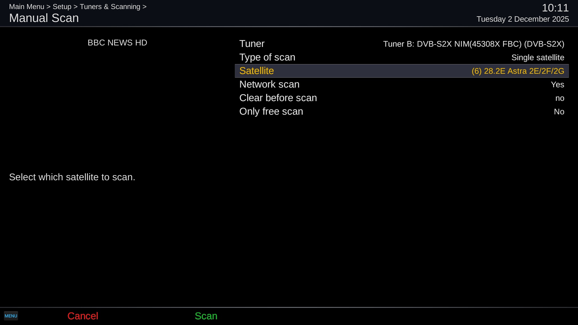

Reminder - I couldn't get the box moving on the e2 by selecting sats from the channel list.
Note: just for clarity the e2 box is not moving the dish across any sat's in the menu below (as I scroll through each satelitte) neither moving the dish when using the channel list and selecting a channel on a sat.

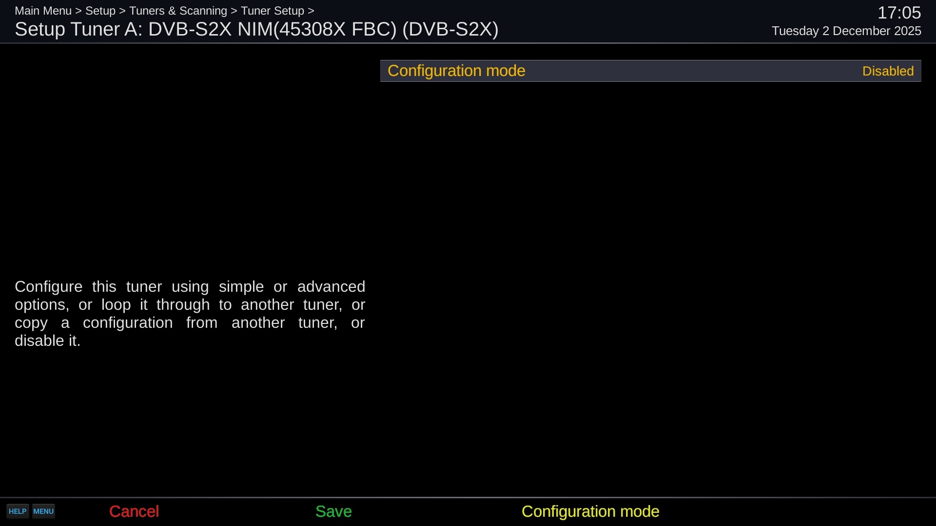

For now i want you to disable TUNER A probably say nothing connected not sure on VIX.

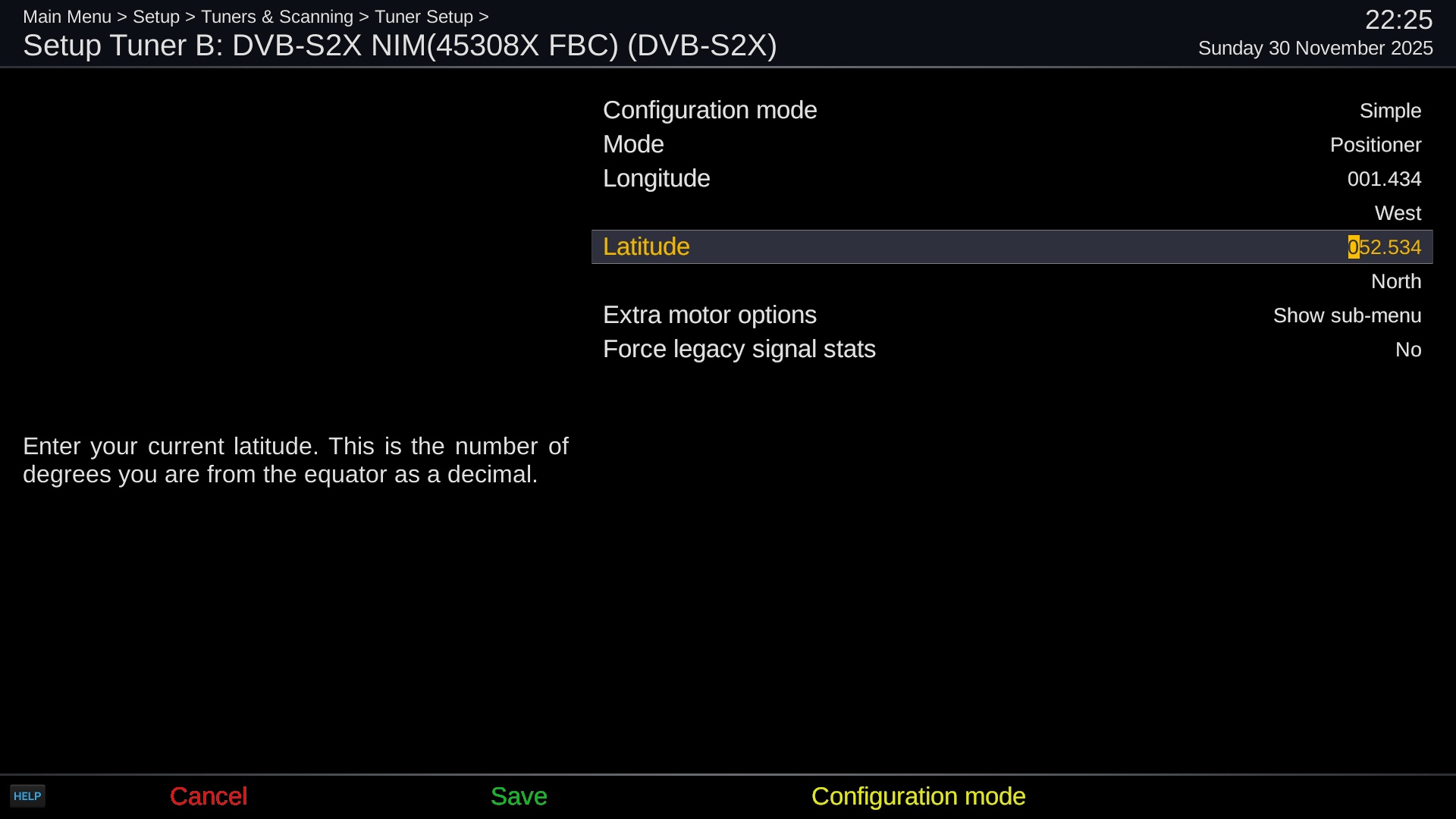

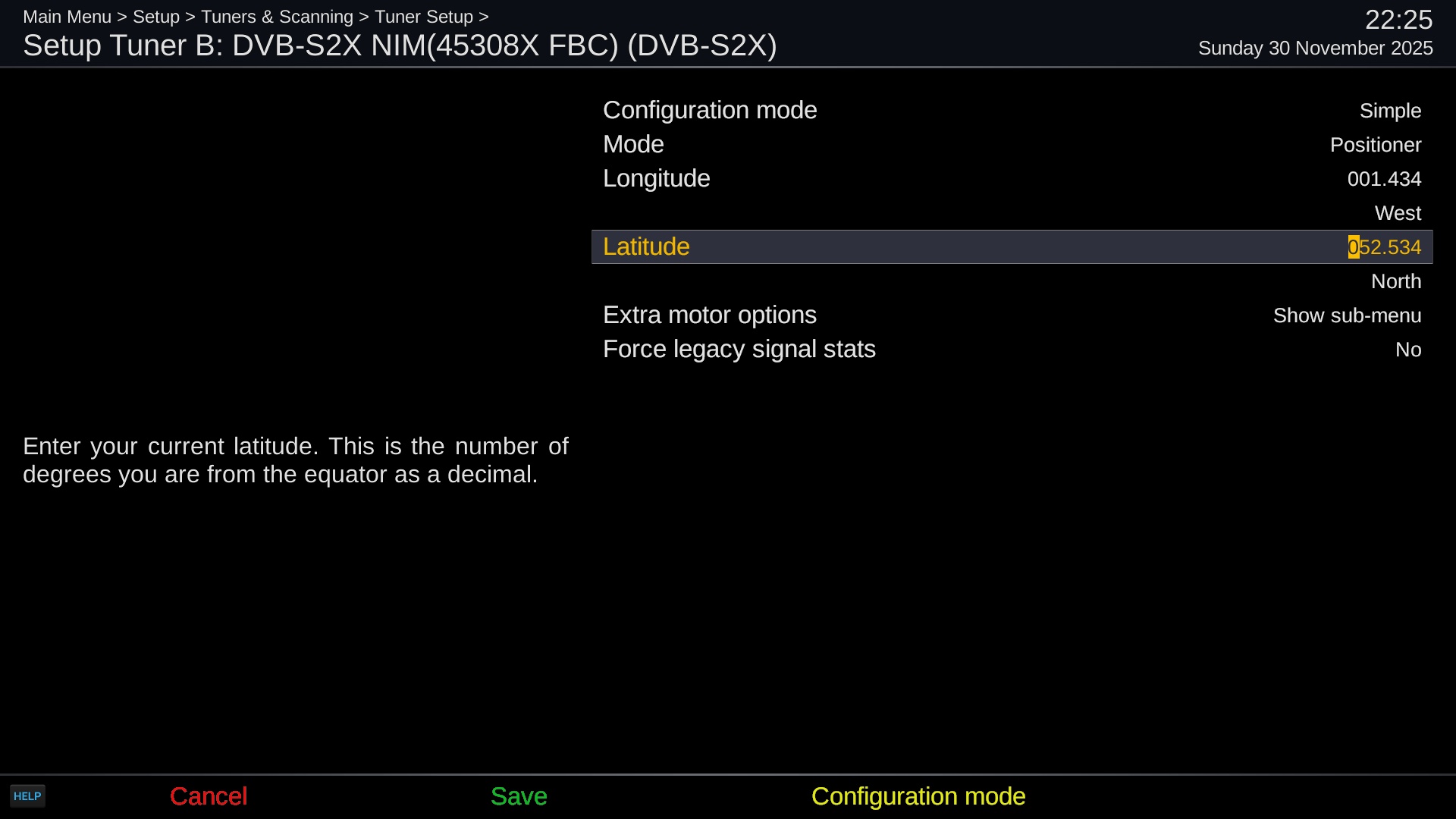

So then Tuner B should be setup as
Simple
Positioner
Enter the correct coordinates understand that west is selected for - figures.
Save then reboot
Try other sat positions.

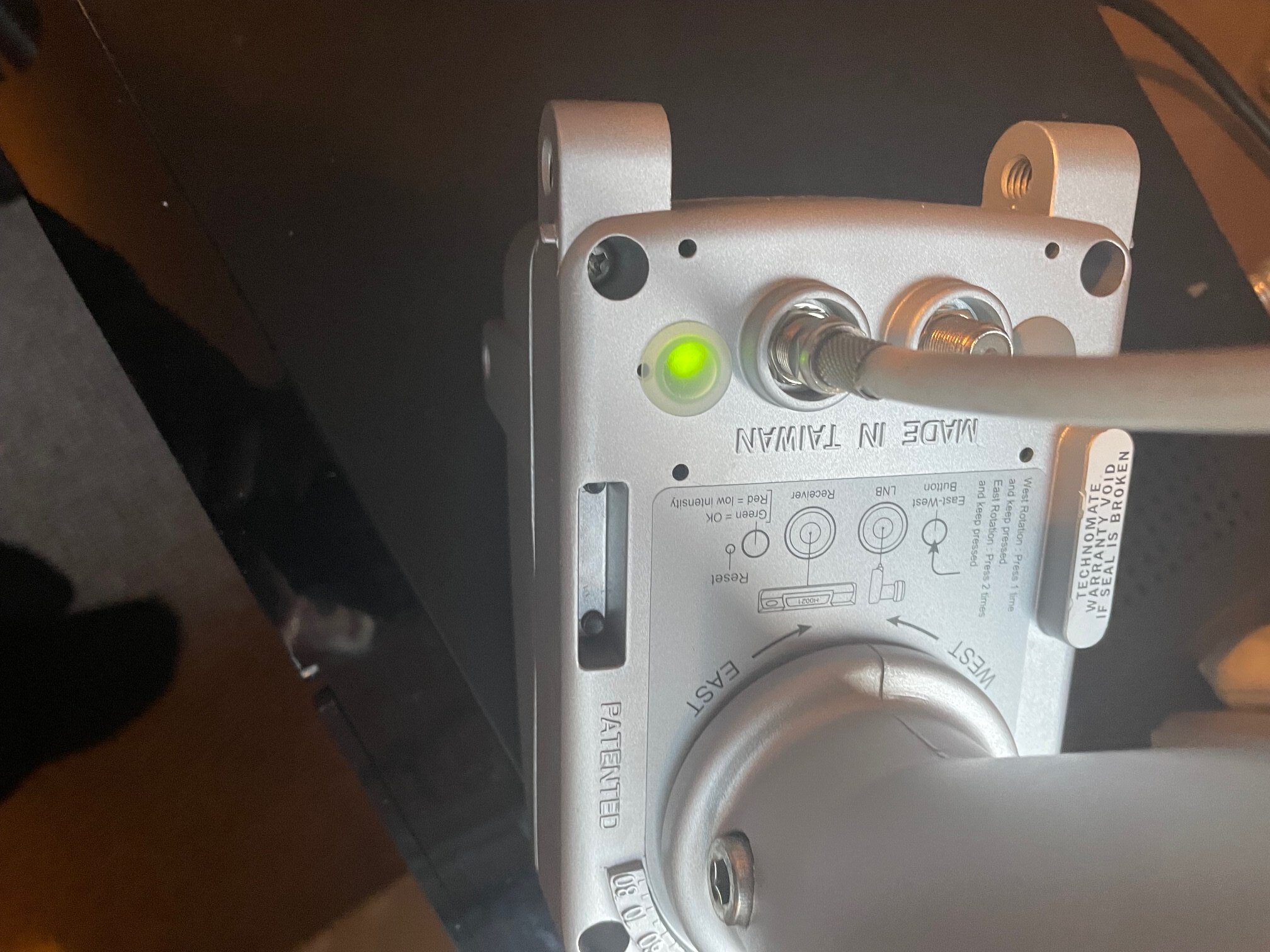

I had to go away for a bit and was hoping all this was sorted. I dug out a technomate 2300 and hooked it up and lo and behold when it goes to a sat the LED turns green so by looking at motor one can see if it is getting power,
But as OP has 2 cables to dish and motor and as noob may not realise only one cable goes to motor or as techomate like to say positioner. So if correct cable is plugged in to viark and a sat is selected then go outside and see if led is Green. I

But are you on the correct cable, very important and I would plug back in to viark and check LED.
I'll do that now - but I'm 90% sure I've never seen a green light on my motor.... it would be green and easy to spot at the night and I've never seen that flash!
It should be easy enough to work out which cable is going to the motor anyway as i think the dish is on the garage and the light should be visible when its connected to a receiver and receiver is turned on.
I will plug the cable into the viark and tune into a FTA channel and take a photo of the dish to see if the motor has power to it i.e. a light.
Simple
Positioner
Save then reboot

Im on vix 6.8 and simple ten eighty skin, tuner will say DISABLED and then when you go back in it will say Tuner A not configured.
As you look at the motor. The static green led is on the right.

Did you even bother doing this ?
Tuner A Disabled:
Tuner B setup:
This setup I followed previously
Saved. Rebooted - this was a step I didn't do each time i.e. saved/rebooted
28.2e randomly has come up - box automatically moved to the sat - clearing BBC.
Went outside and GREEN light on motor
Selected 16.e -> appears to have moved dish. No channels clearing as haven't selected a FTA channel. GREEN light on motor...

@Ferret.
Tuner A Disabled:
Tuner B setup:
Try some other sats from the channel list then

I've remoted over and overseen what he has done. He has definitely followed the instructions given, but there is a hardware fault of some sort. He was looking at his motor while I selected channels on various satellites. The motor did not move. There was a flashing orange light on the motor to indicate receiving a signal to move, but there was no actual movement of the dish. We even used positioner setup to move the dish, no movement there either.
He's messaged me pictures of the F-plug, I can't see any loose strands that could cause a short circuit.
He will be contacting an installer to come and have a look.
This is from manual "The orange signal means fault can be either a loose magnet inside or hall sensor broken. I think hall should read call. Contact vendor for repair . but a google also suggests cable may be at fault.
