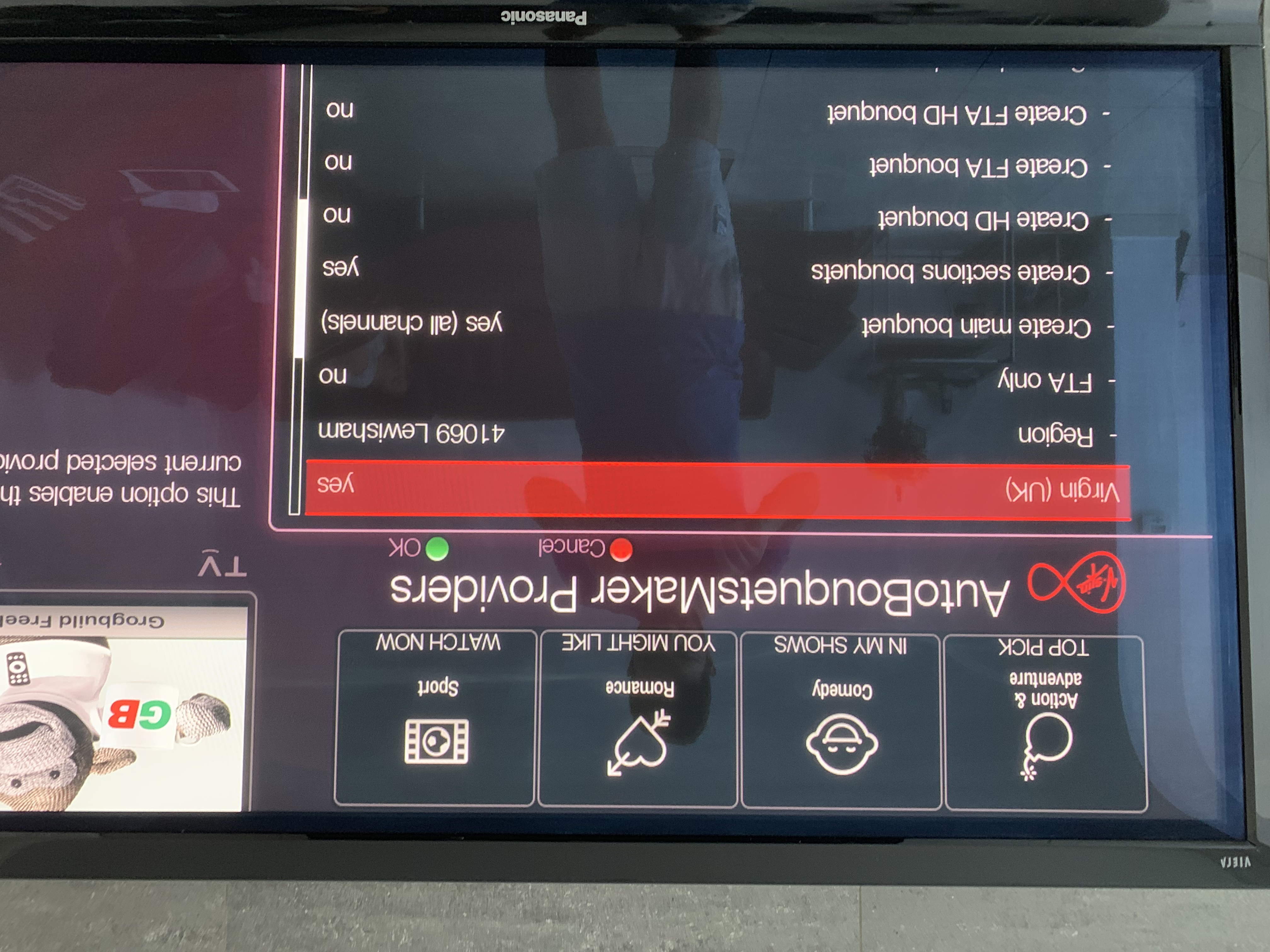

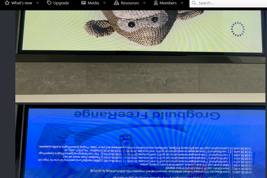

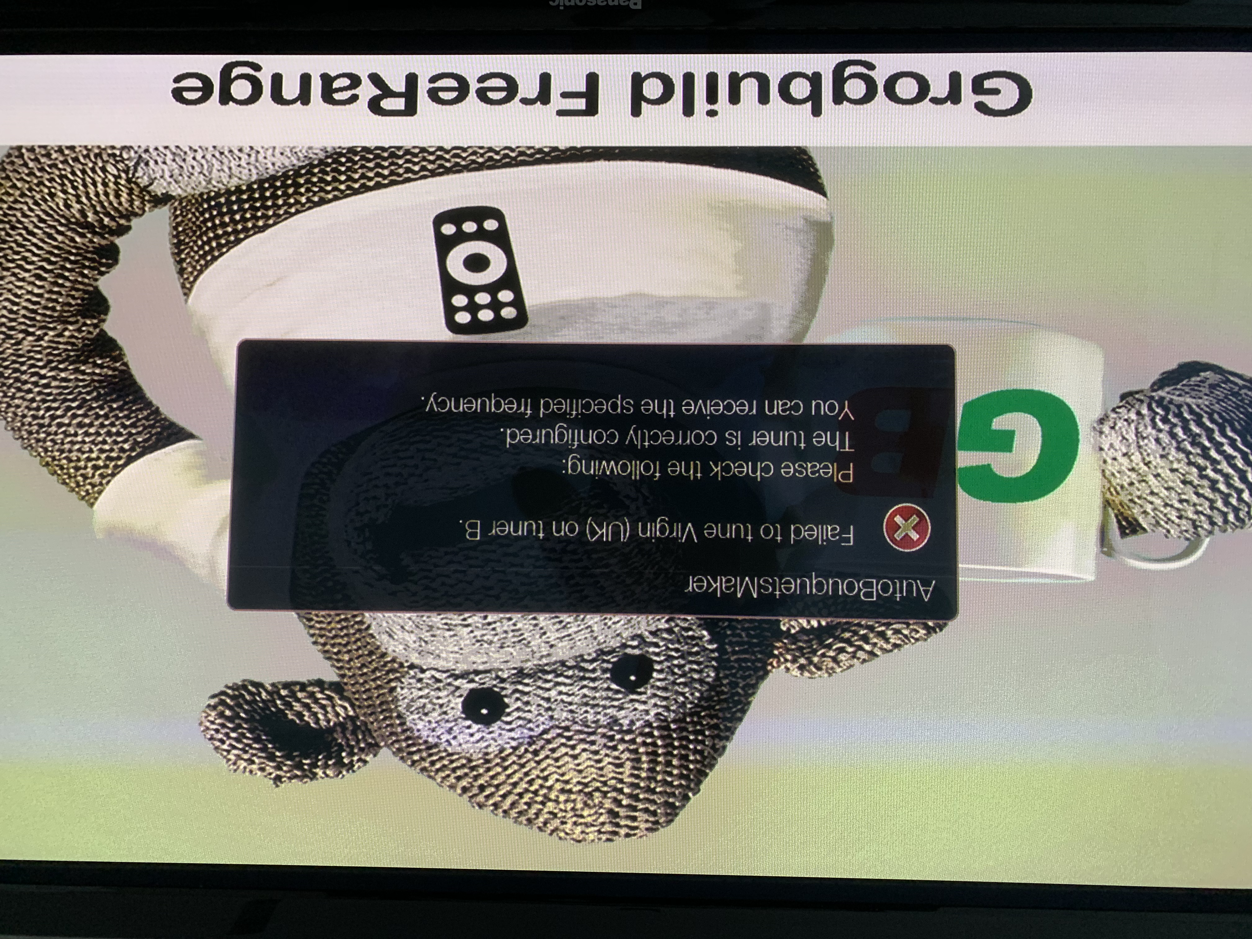

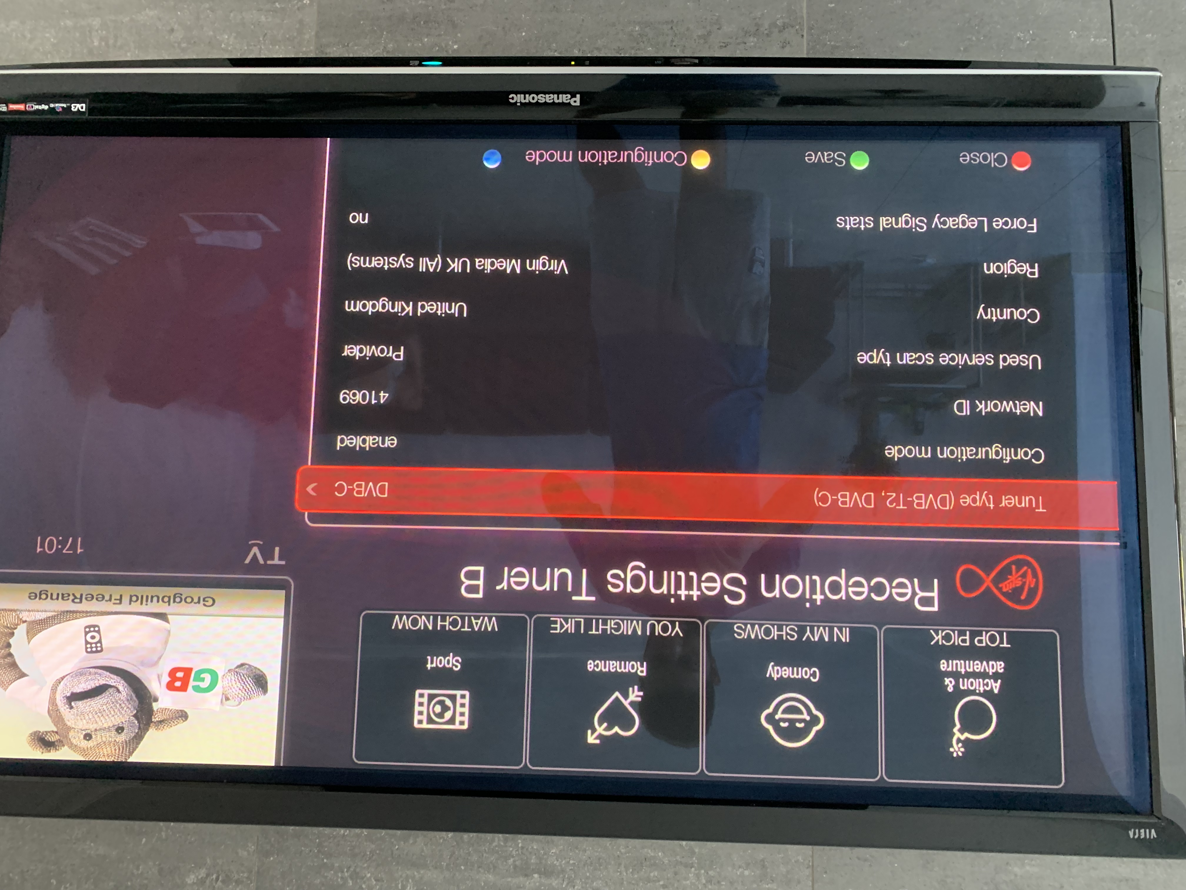

Hi - just tried to load the new Grogbuild. Got to the last phase however there is now an error message during the ABM phase which is a constant loop.
Screenshots attached
38962
38963
I've downloaded it and spun it round, it looks like there's a problem in ABM settings maybe, HD 41047?
I assume that is your netid and you are choosing to have a HD bouquet?
Try removing the HD option in ABM and then run a scan

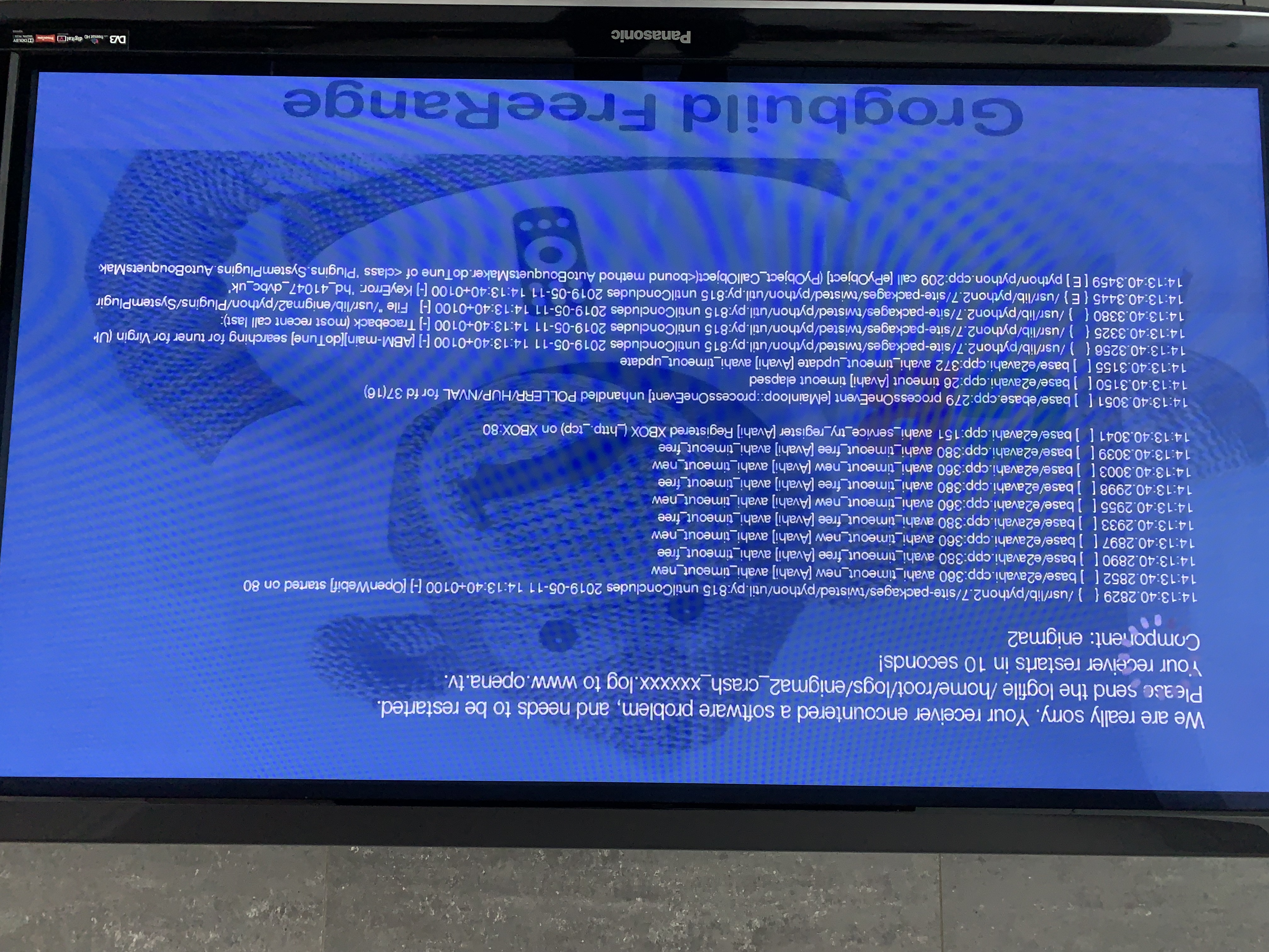

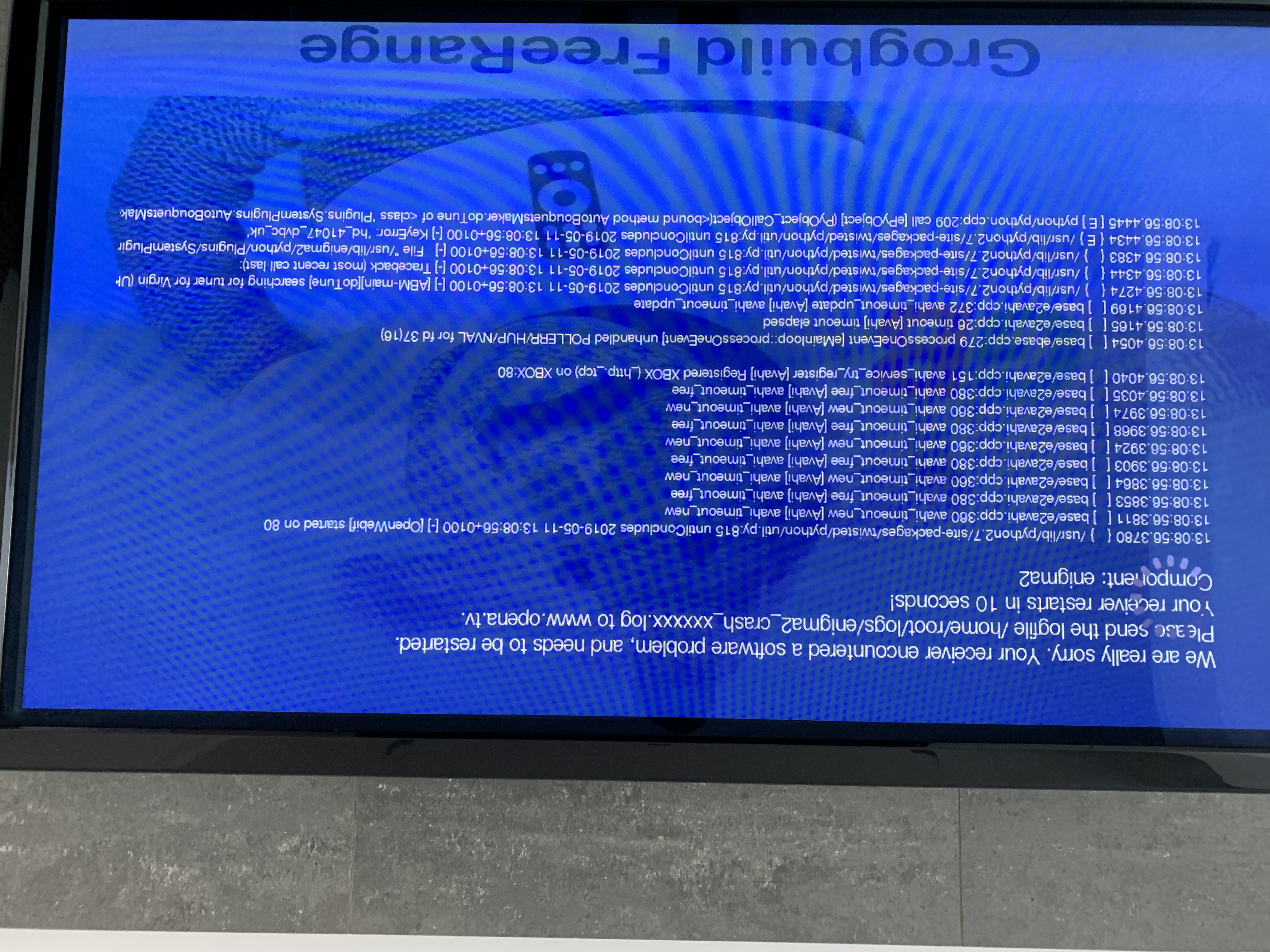

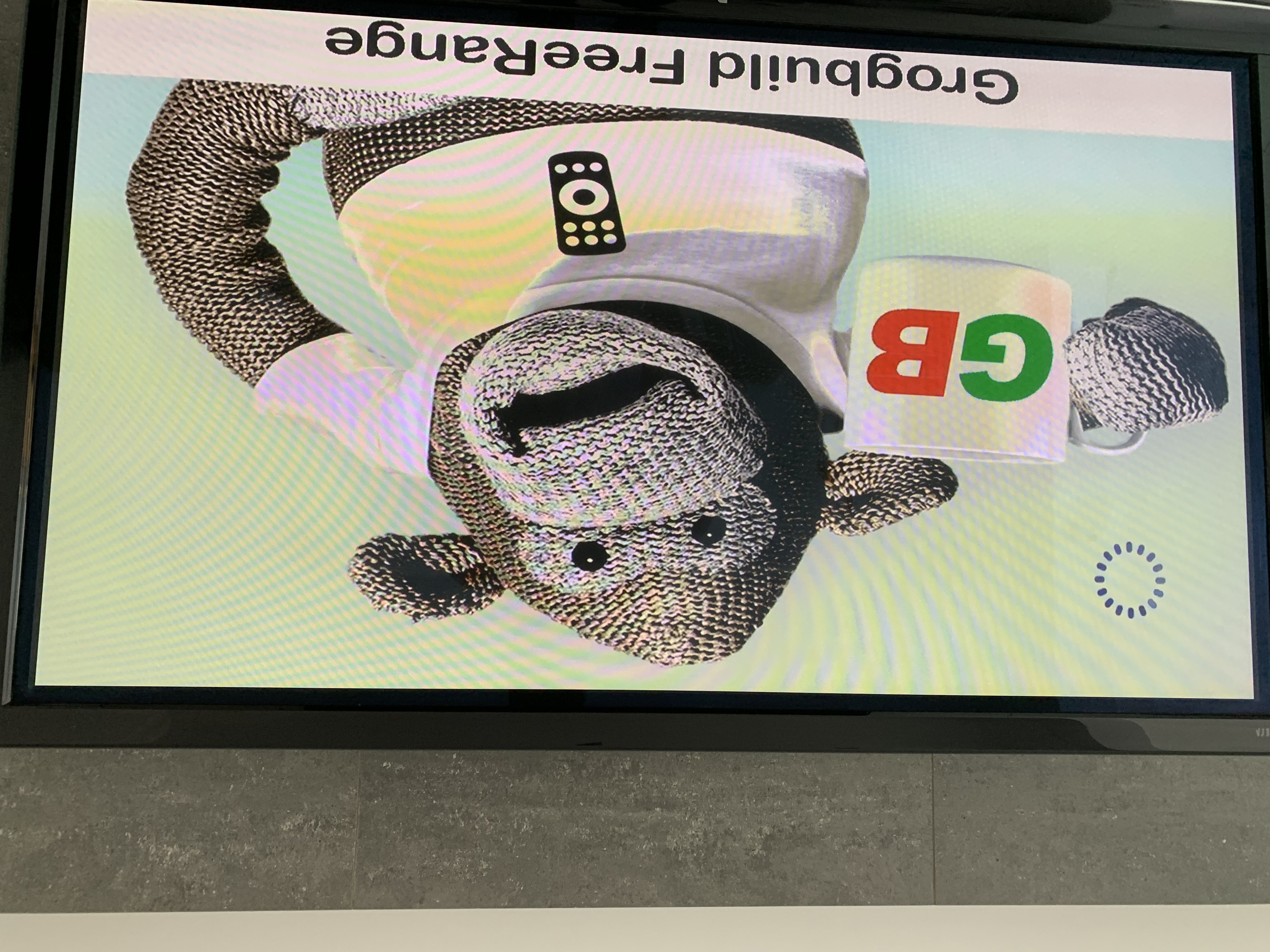

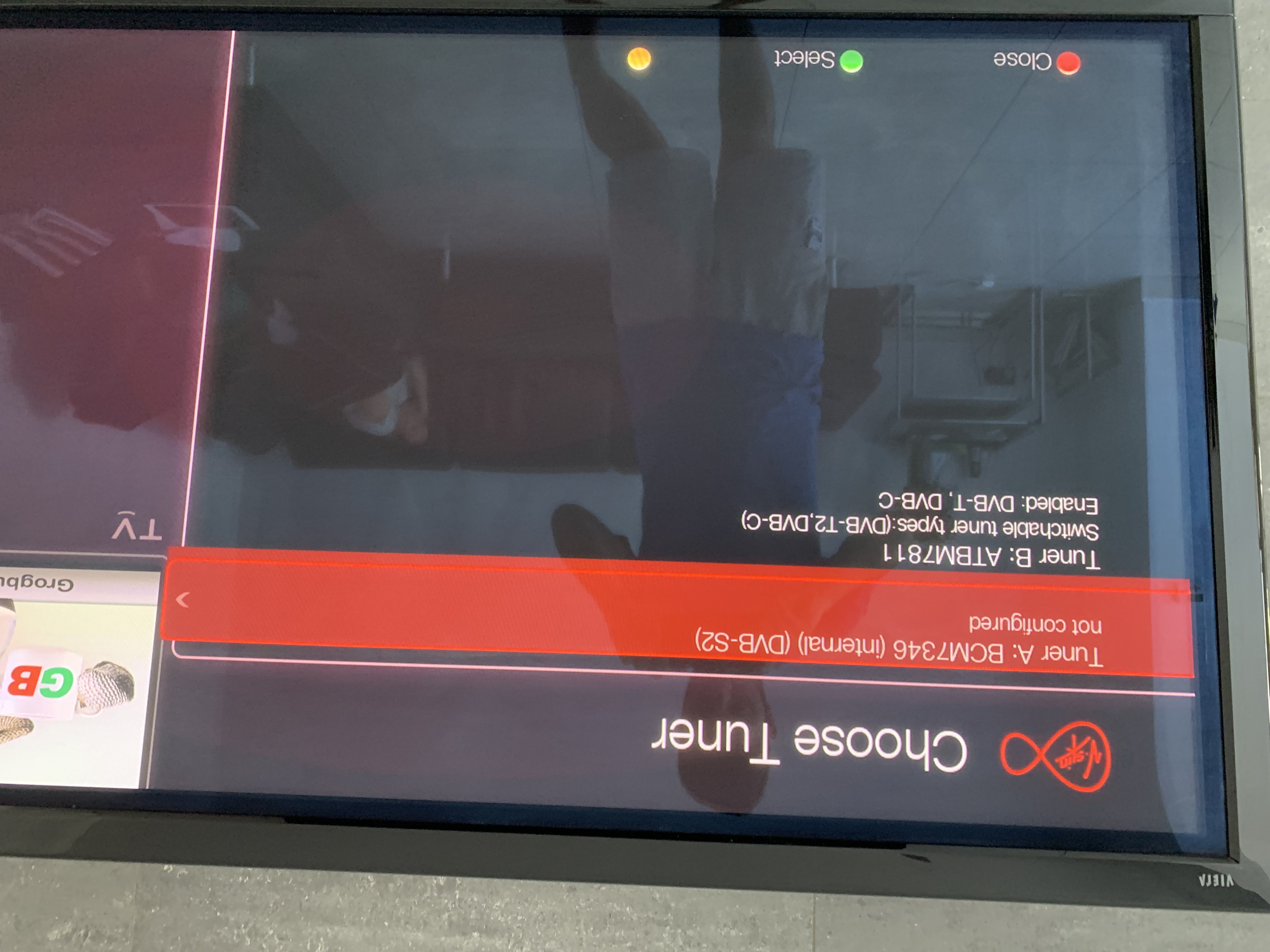

Thanks. Any way to get out of these screens though? I can’t exit these two screens.
I did a power off from the mains and it still returned to the same two screens
Also I selected net ID during the build set up on on Webif. No option for a non-HD bouquet
41047 does not exist. How did you select it in ABM?
To fix the current issue, issue following command using putty or similar
init 4
Then using filezilla or similar, navigate to /etc/enigma2
You will find a file called "settings", you need to edit this file.
Delete the line that 41047 or replace it with the correct net id.
Transfer back to receiver
Issue the following command with putty to restart receiver
init 3

If you run a manual scan on tuner b does it find channels, is your netid correct for where you live?
try another local id, also search this forum for netid list as h52tc.com may be out off date as I think some have changed but I've not updated the map recently (SORRY)
