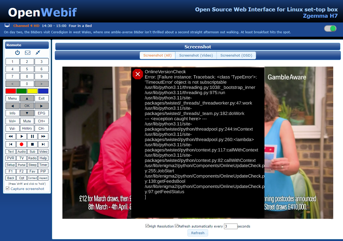

While on laptop i entered Webif to use remote for H7S and on screen i see this and no idea from what the error is.

It is showing an error while performing a software update check. Possibly because the "feeds" are being updated for 6.7. It should resolve by itself. Otherwise, you can disable the update check or update.

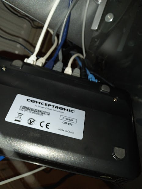

Virgin router in office running 4 cables around the house to 8 port switches as will update this post with more named info and all units using lan cables.
If lan cables wear out indoors i will be screwed as through floors and panelling.
Thinking a few cables go through other switches and to another switch.

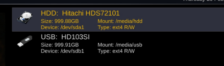

Shouldn't the USB stick be mounted as "USB" or "usb" instead of "sdb1"?

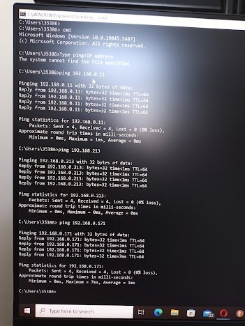

Sorry, my mistake . It is a better test to simply ping every single device to find points of failures.
I have a number of these 5 port switches on Et10000 , Et8000, and had one removed for Zgemma H7s and a different one 8 port to be checked for name.

Never pinged anything before so unsure of how to ?

Your picture is not very clear, but I think we can make out is OK at the moment. No packet losses or long delays. Next time there is a a problem, try pinging the device first. (Most people take a screen grab instead of a picture :). search internet for "using snipping tool".)
Please do not mix up device mountpoints and network mounts. Your USB enclosure on the ET800 is mounted as "sdb1". I think this is the problem.

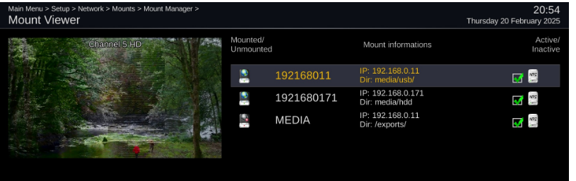

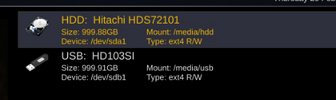

Your issue is the storage mountpoints. Can we please fix that. Please do not mention network, do not touch any other boxes.
On the et8000, change the change the mountpoint so it says usb. Once that is done, restart your other boxes.
This is done in Vix menu, not network menu.
Was able to get it changed on the 8000 but not able to restart other boxes as of yet
Rebooted Et 10000 and have 1 drive only on 8000 so need to recheck more.
Maybe i should rename box and mounts to allow me go a different route to usb or hdd.
