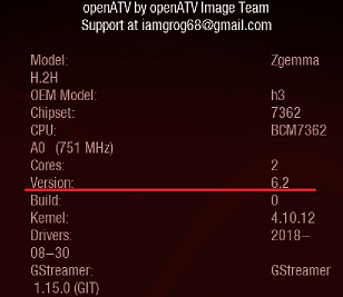

What does it say on the top line when you go to Menu, Information, About.
Ipab version 1,3,5e002What does it say on the top line when you go to Menu, Information, About.
press menu>information>about, this is the version underlined in redWhere's atv? Sorry buddy
New to it all buddy wouldn't know where to start to be honest, cheersThat's your problem, ipab was abandonned last year and is not supported or updated, you need to flash a newer build to the box, use grogbuild freerange, make sure you back up your lines first as flashing will destroy the data in the box
