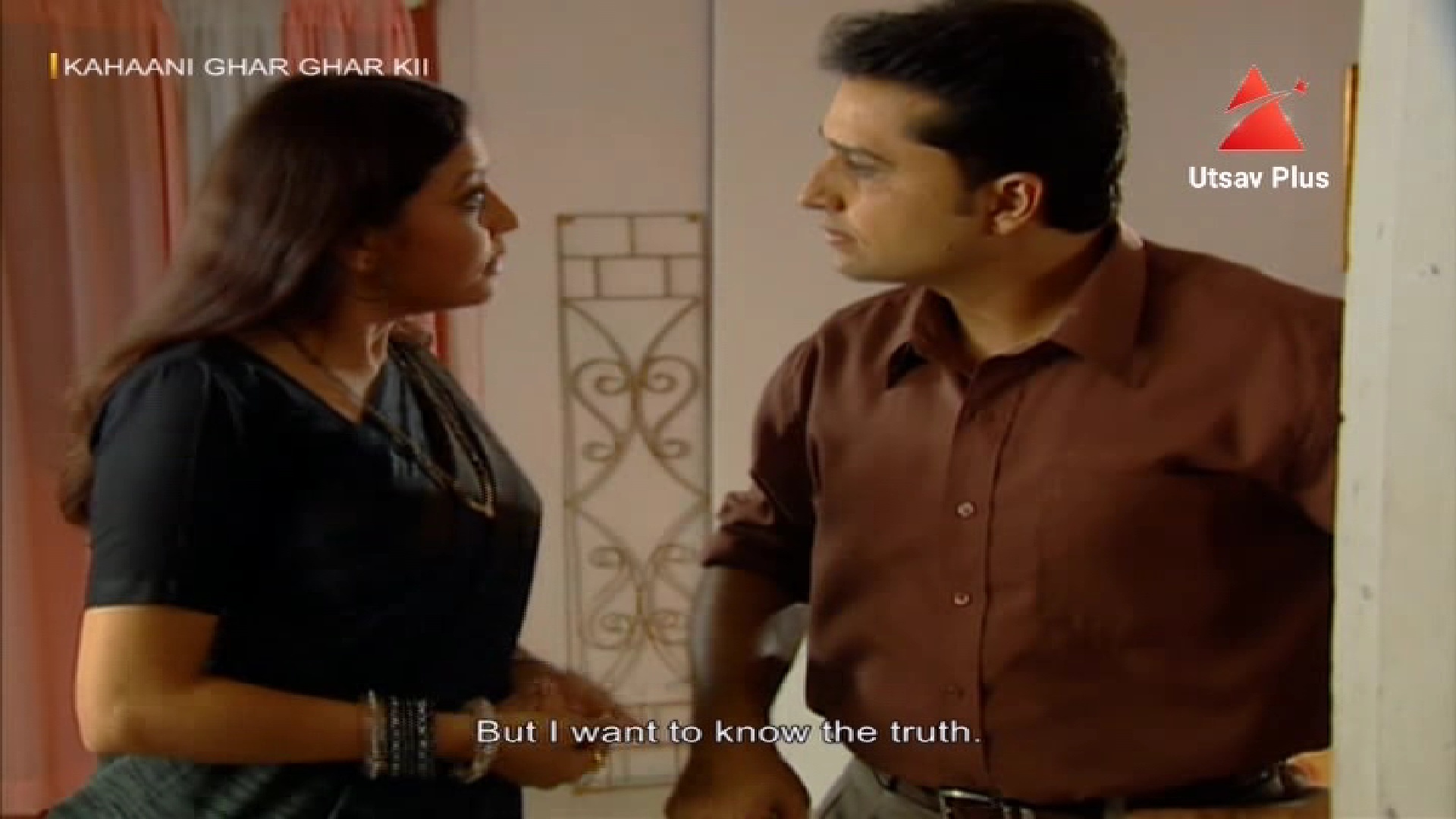

I added to my post as your on wrong frequency
Oh yours is the plus as not seen that one yet
Yh its the plus one. My mum has a few things that she loves watching on there and i am trying to record the repeat episdoes but the channel is not clearing.
No you have a frequency on that channel which matches its new position on KOS
Was that channel free ?
As of now its on Videoguard which is an encrypted channel.

(17h02) Sky Digital: New frequency for Utsav Bharat: 11464.25MHz, pol.H (DVB-S SR:22000 FEC:5/6 SID:54212 PID:2316/2317 English- VideoGuard).
(20h51) Sky Digital: New frequency for Sanskar TV: 11464.25MHz, pol.H (DVB-S SR:22000 FEC:5/6 SID:54223 PID:2309/2318 English- Clear).
(19h03) Sky Digital: New frequency for Utsav Plus: 11479.00MHz, pol.V (DVB-S SR:22000 FEC:5/6 SID:50888 PID:2315/2316- VideoGuard).
(19h03) Sky Digital: New frequency for Utsav Gold: 11479.00MHz, pol.V (DVB-S SR:22000 FEC:5/6 SID:50889 PID:2317/2320 English- VideoGuard).
