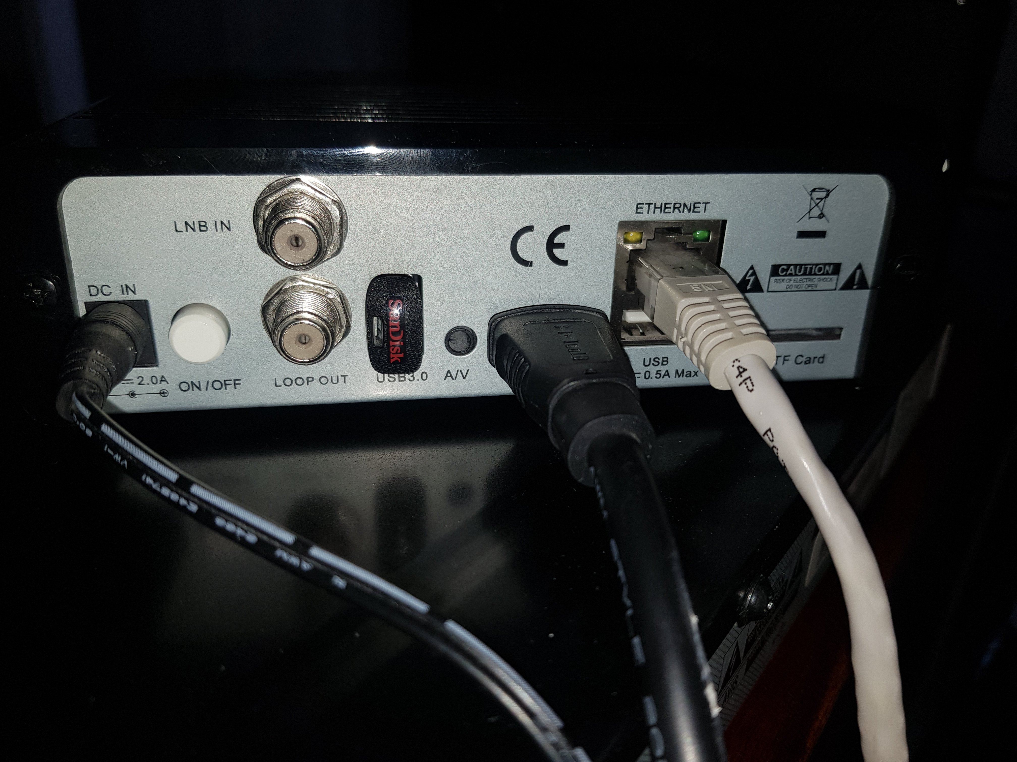

No none at all.When you check the cables on the zgemma go into menu, tuners and scanning, signal finder. Are you getting any Snr signal at all.

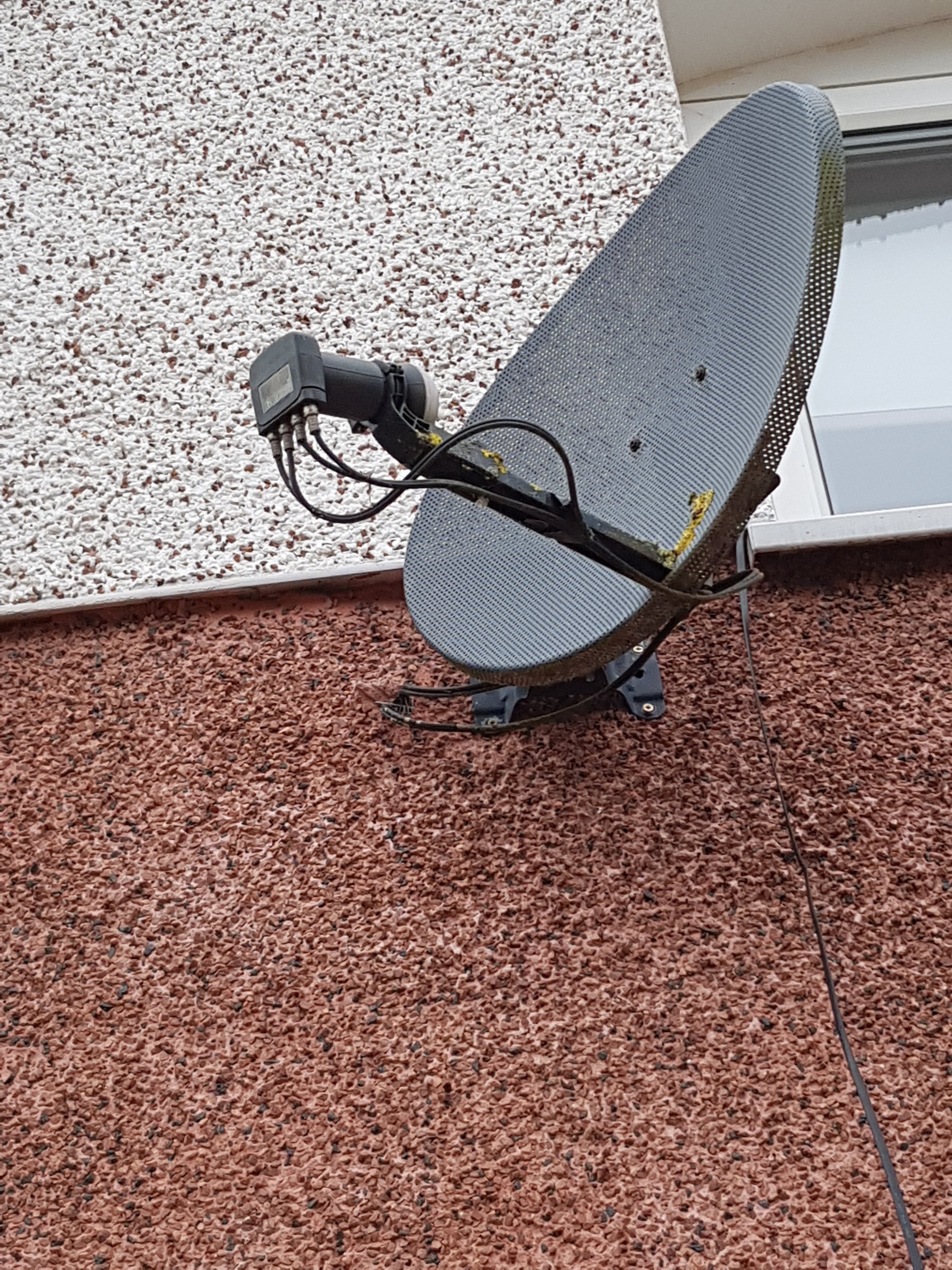

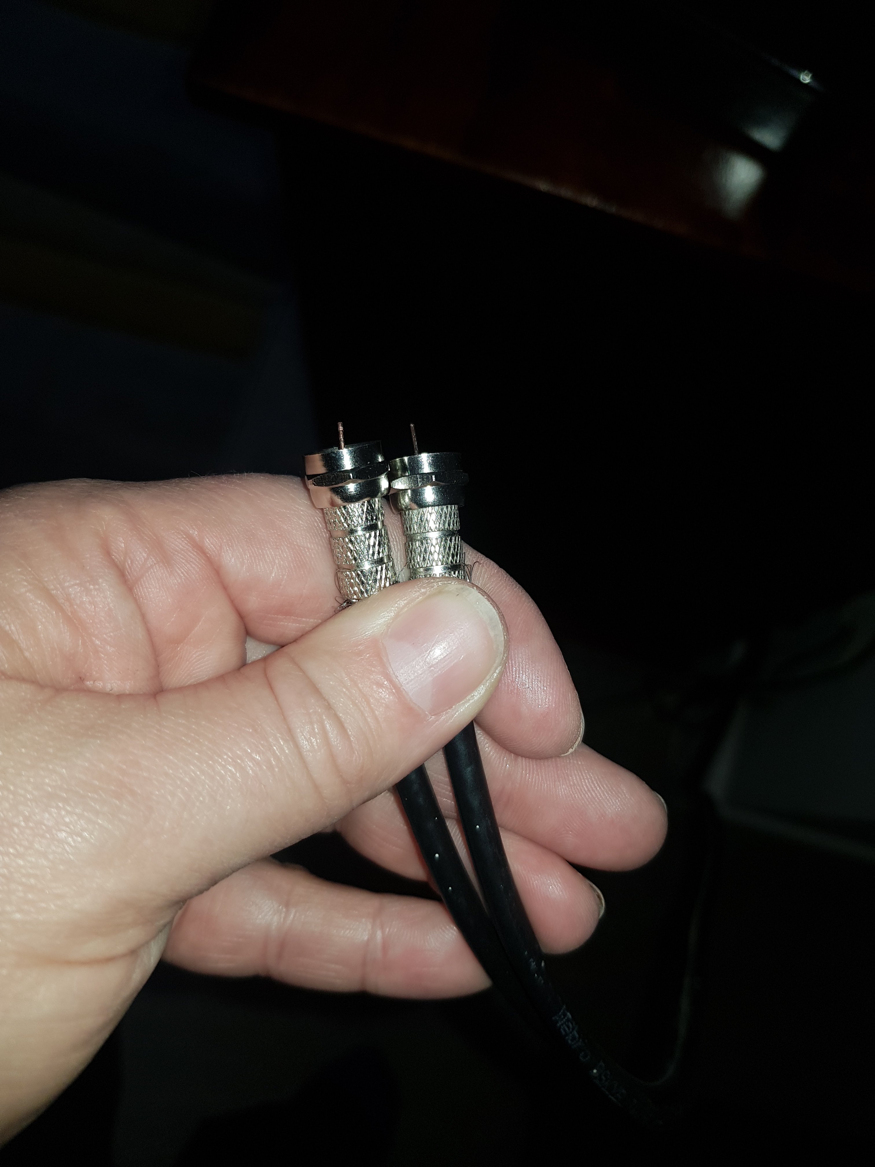

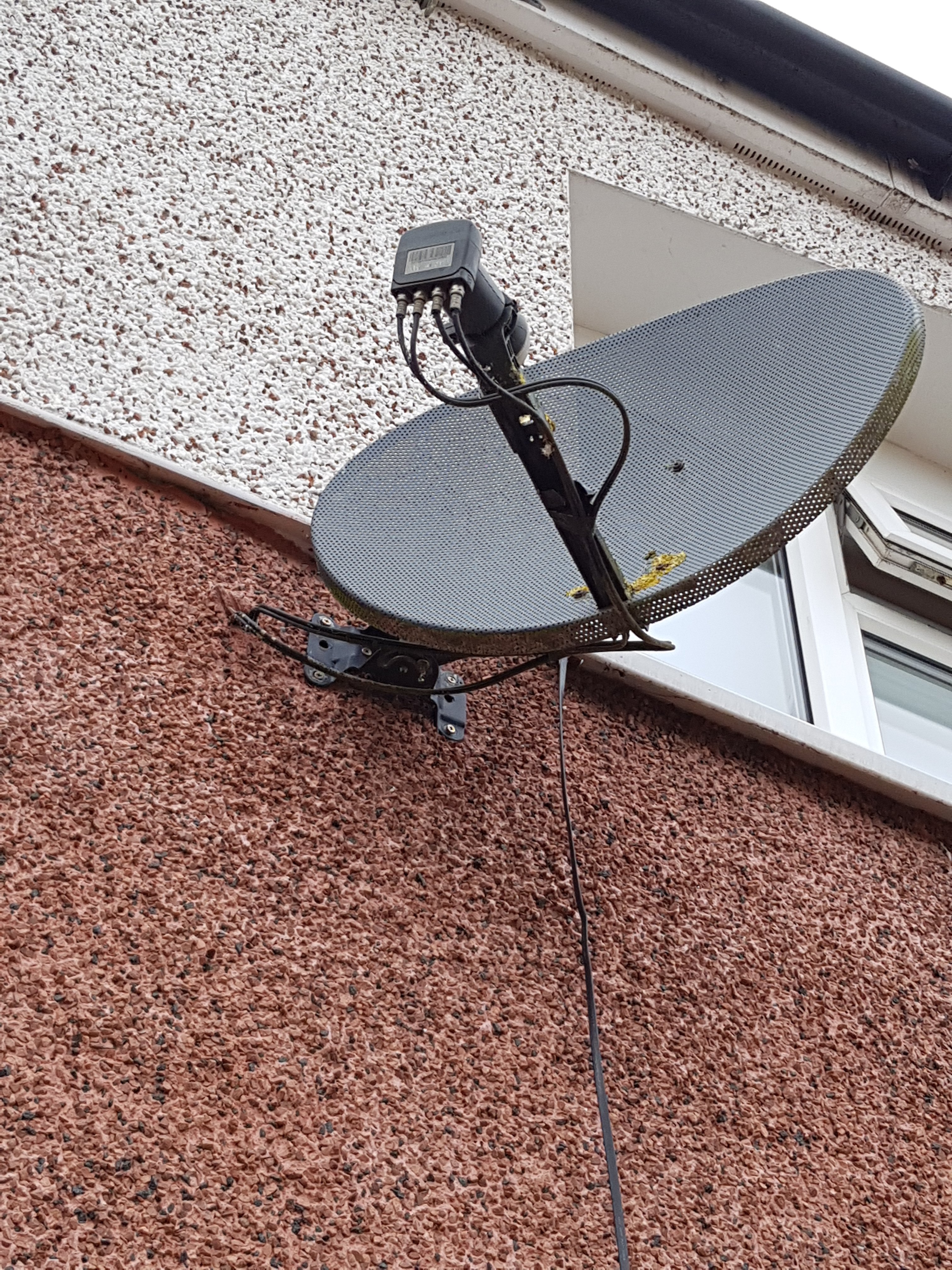

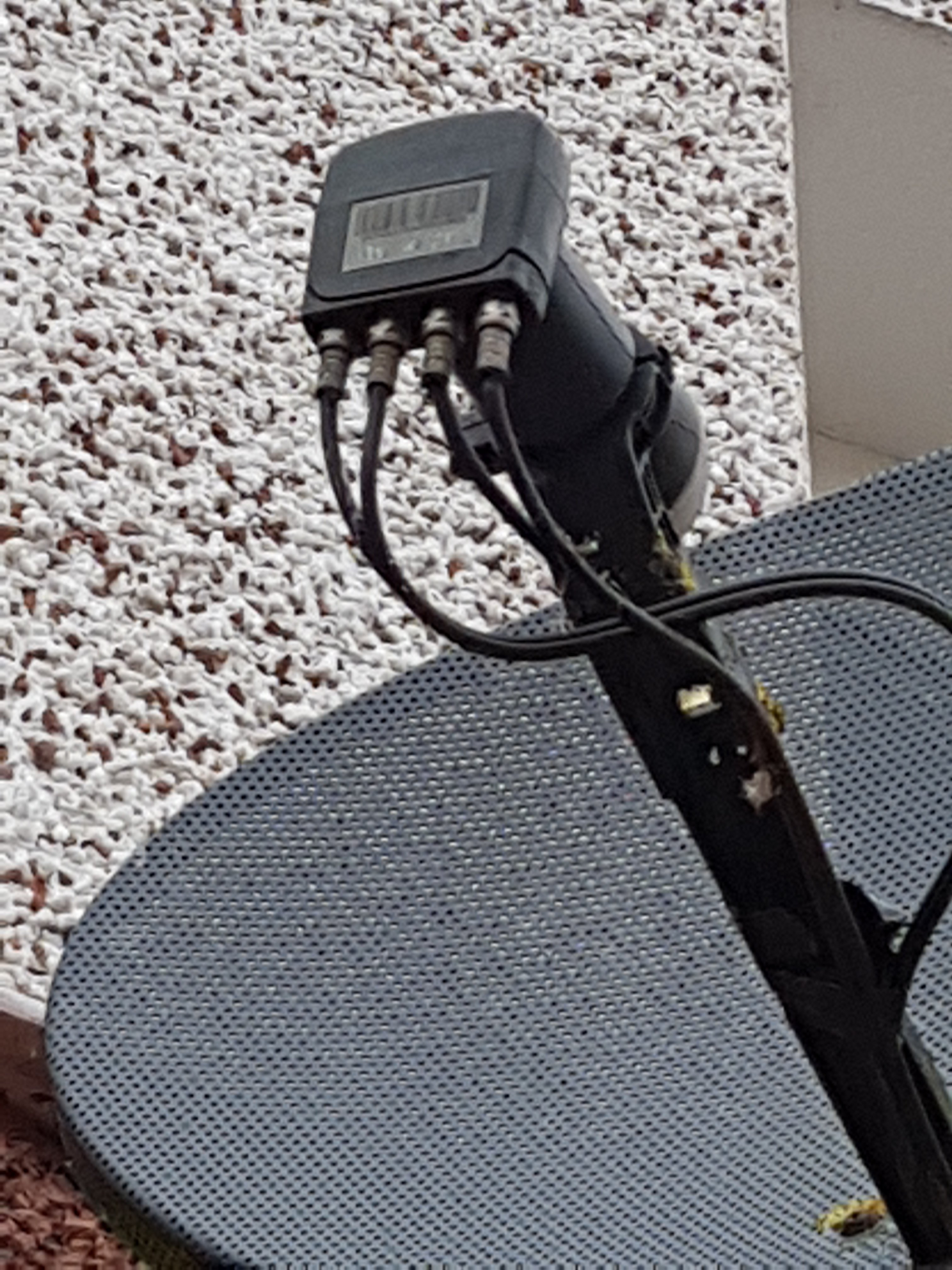

I would but I would get a ban 🤣🤣🤣Can you post some pics of your f connectors, lnb, and dish?
Just standard set up outside, never touch it since it was installed. Then back of zgemma and set up of wires/cables. This is the same in both rooms.
